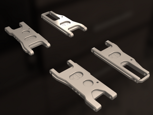

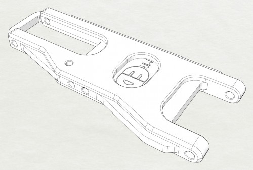

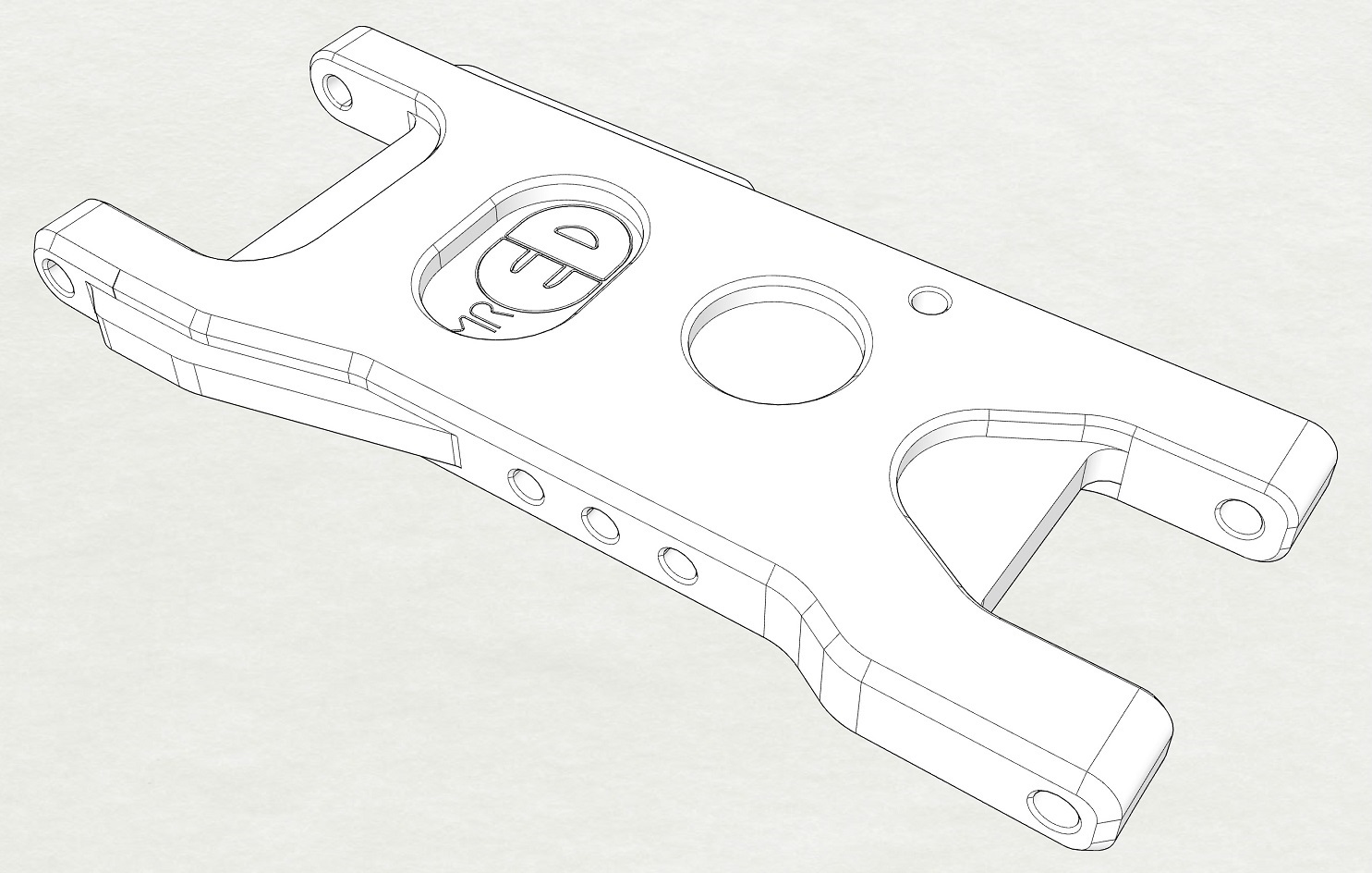

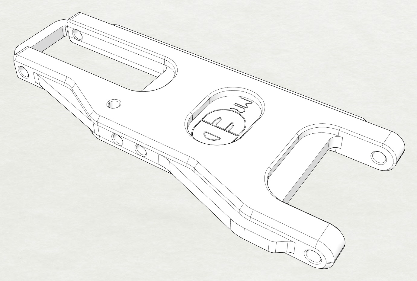

Well the rear went smoother than expected. I ditched the adjustable wheelbase spacers to increase the strength. Those pescy little buggers are a pain to install anyway and to easy to loose when you're doing a quick repair on the track side.
The rear The front The full monty

Absolutely perfect. What's next? Did you ever meet with that manufacturer? I did get quotes on your previous design but they only became cost effective at more than 50 sets. I really didn't check into 3d print, just machined pieces. I guess they don't like low volume. I wish I had friends that do that sort of thing like you guys. You know I'm still interested so please let me know when you're having some prototypes made. I'm in to invest. Keep me posted.

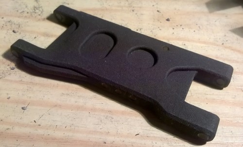

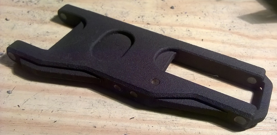

Re: YR-4 custom buggy conversion
woohoo! Got my proto-types today.
First: pics!
I test-fitted the rear one and noted some small alterations needed:
Overall I'm glad I made the proto-types. It would have been annoying if they were produced and went out to you guys in the current version.
I'll definitely need to to do the same for the ulitma hop-ups too.
PS: I'll probably start my own thread rather than continuing to expand this one.
First: pics!
- a bit too tight at the gearbox side for the plastic gearboxes. (I took the measurements on the aluminium ones)
- a bit too tight on the axle carrier side
- the logo imprint is 90% lost in the texture. Either I make it simpler and bolder, or discard it entirely.
- the pin-to-pin distance is about 1.5 mm too short, and could easily have another 1.5mm extra to make it work with the 91 and wider driveshafts of the '94. (No worries: they'll still be plenty deep in the outdrives and there's plenty room before the legal max width 'd be reached.)
- the pin at the axle carrier side could use 1° extra toe-in
- the reinforcement rib on the leading edge of the arm interferes with the motor when the motor is in its furthest back position and the suspension is compressed
