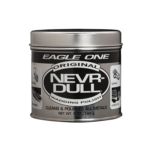

This finish on the chassis is mat black with a mat clear coat. I kind of prefer this finish than the gloss on carbon parts. You can notice some of the holes that I repaired but you can't feel them at all it is very flat and smooth. The arms have a lot of never dull hands on them to get them to the current state.

Did you use a Dremel to polish that aluminum or something else? What are "never dull hands"?

I use NEVR-DULL on the arms hand worked the heck out of them all over several times and then use a Dremel polishing pad to finish them out.

hmmmm....... is it me or the image is not showing correctly......
Edited...
whooaahhh..... how did they do that!!!!....whats that stuff..... i think i need that one......
