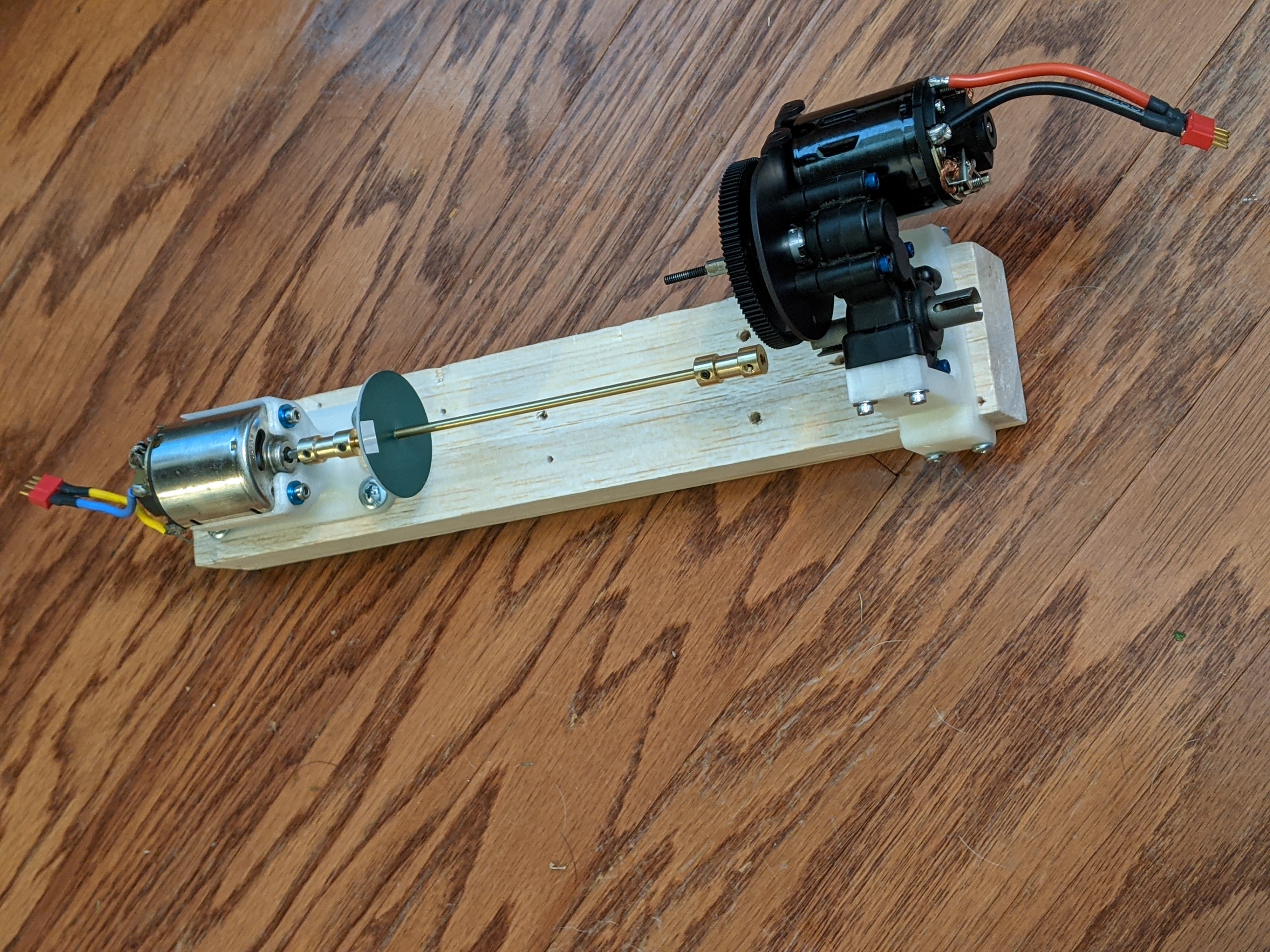

Experimenting a bit with the gearbox I have... since I don't have a 6 gear.

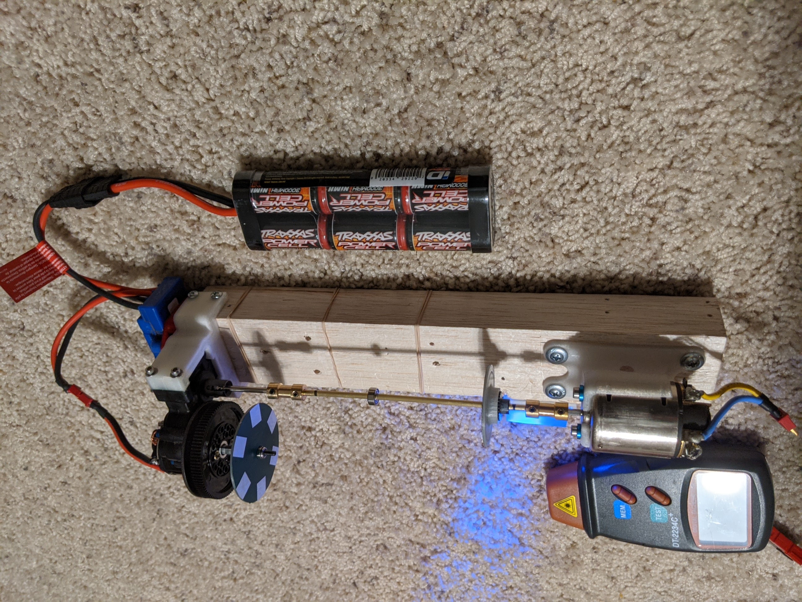

I finally came up with a sacrificial dogbone to complete my drive line assembly. I also decided to swap in a spare Traxxas ESC for the testing duties. What I found out with my initial testing is:

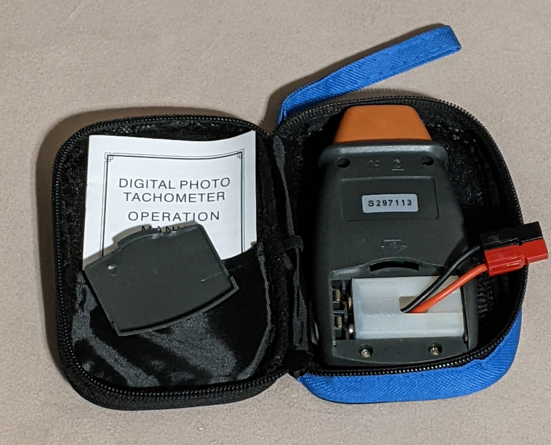

1. This RPM meter is are constant drain on a connected battery when not in use. It's definitely a battery killer.
2. The push button programmed ESC loses its calibration between uses. I need to switch back to an older ESC.
3. The load motor resulted in a 30,700 rpm input motor speed. With the drive line removed, the unloaded input motor still spun up to 30,700 rpm. Looks like I need to come up with a more significant load for testing.

Just noticed this. The Traxxas esc in my Stampede does the same thing.Frankentruck wrote: ↑Tue Jun 08, 2021 9:10 pm 2. The push button programmed ESC loses its calibration between uses. I need to switch back to an older ESC.
The older yellow version in my son's truck doesn't though.

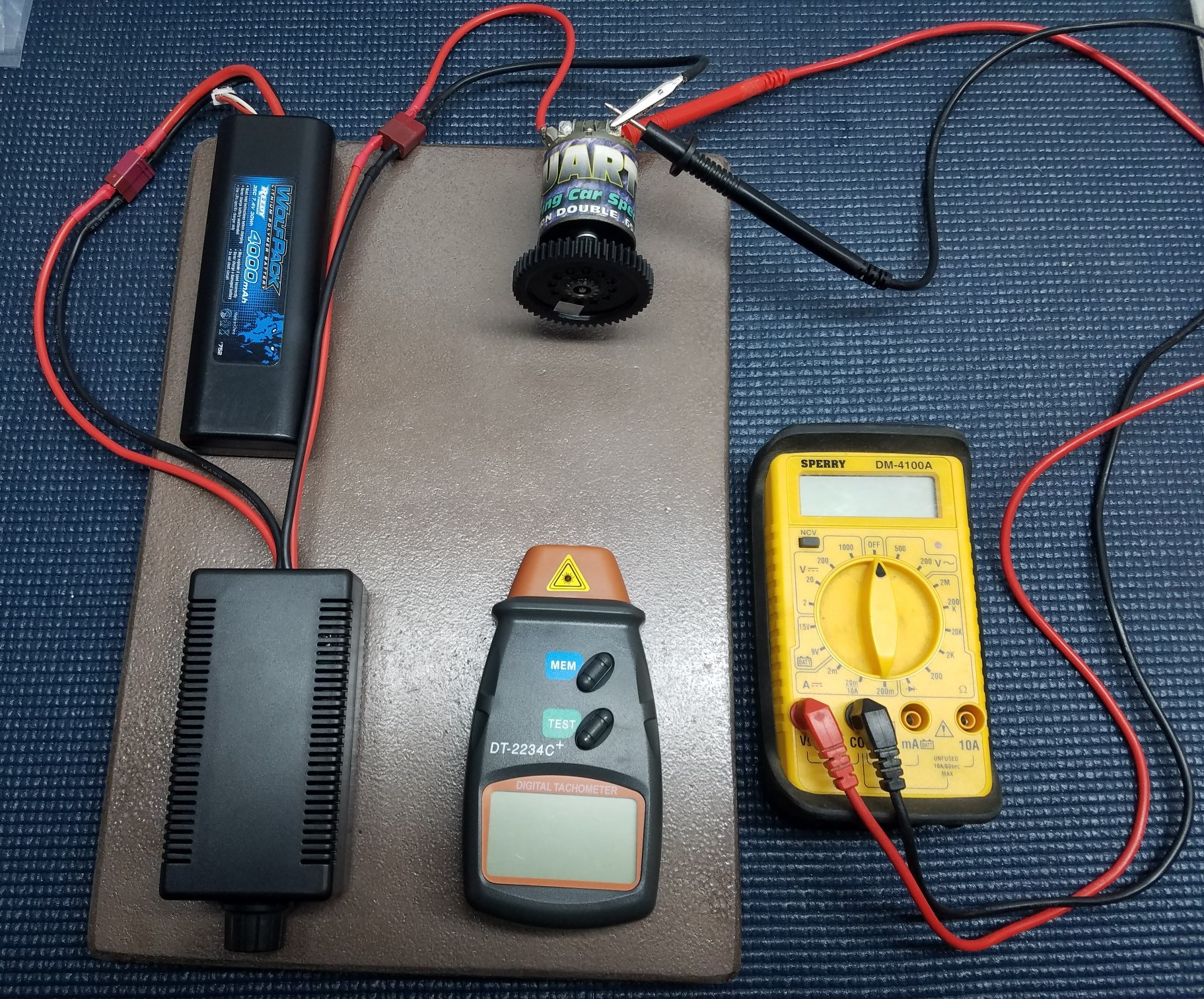

My brother wants a good brushed candidate for his RC10T4 he snatched up a few months back, but it came with a silver can motor and junk cheapo ESC. So I picked him up a Novak Rooster and letting him harvest a motor out of the collection. This sparked my interest to get the ball rolling again on this deal.
Soldered some connectors up last night, mounted a Speed Gems Quartz 19x2 to the motor mount and let 'er rip, up until 5.9 volts when my homemade spur mounted pinion gear started to show it's imbalance. So I ordered the largest diameter pinion I could find that was available, an Arrowmax 64P 70 tooth. The 9V battery in the tachometer was dead and I'm fresh out, so I couldn't get a rpm reading. Also ordering a clamp meter to measure the amp draw.

These tachometers do seem to have a lot of parasitic battery draining when not in use.

I thought it was just mine that wet flat unused in the boxFrankentruck wrote: ↑Thu Jan 20, 2022 10:45 am Holy cow that's a big pinion gear!

Well not quite, I don't leave batteries in devices that sit unused for longer periods of time (habit). So the 9V was in the carrying case, but not in the tachometer. The date on it was Dec 2017, so it's a good 14 years old. Put it to the battery tester and it barely moved the needle, less than 1/4 up the red zone.Dadio wrote: ↑Thu Jan 20, 2022 11:22 amI thought it was just mine that wet flat unused in the boxFrankentruck wrote: ↑Thu Jan 20, 2022 10:45 am Holy cow that's a big pinion gear!

I'm against buying 9v batteries only for this tachometer so I made a battery adapter using the terminals from a dead 9v battery. It's more cumbersome to use with an external battery, but otherwise felt like a good compromise to avoid recurring dead battery syndrome.

I just added some leads with banana plugs on mine. They plug directly into my multi-meter. My Fluke is ancient but will still handle up to 10 amps.
Comparatively, my DC clamp meter is kinda slow, especially when dealing with low currents.
If you do get a clamp meter, be sure that it reads DC amperage. Most don't. Most are AC/DC voltage and AC amperage.

My Sperry DM-4100a can read up to 10A. Getting an extra set of alligator clip leads is a much cheaper solution than buying a separate ac/dc clamp meter. Thanks for pointing out what should've been the obvious thing to dojuicedcoupe wrote: ↑Sun Feb 06, 2022 9:55 pm I just added some leads with banana plugs on mine. They plug directly into my multi-meter. My Fluke is ancient but will still handle up to 10 amps.
Yeah I recently noticed clamp meters which can read DC current are much more costly than ones that only read AC current.
