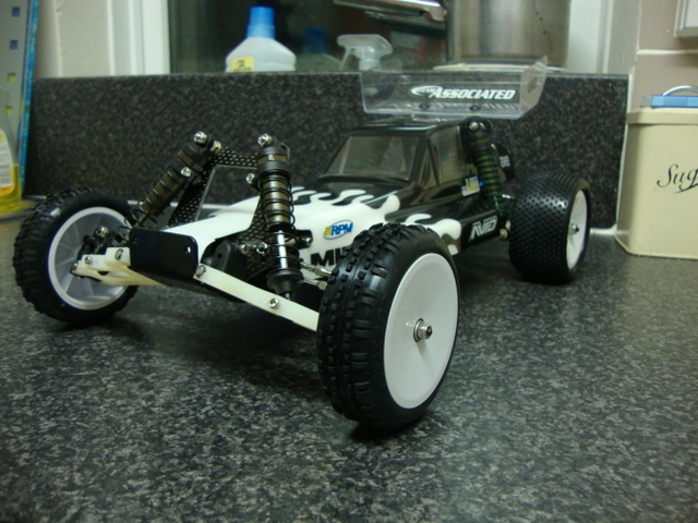

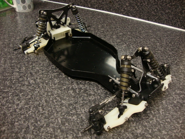

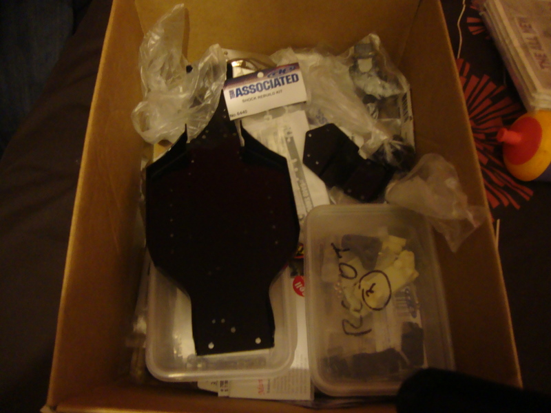

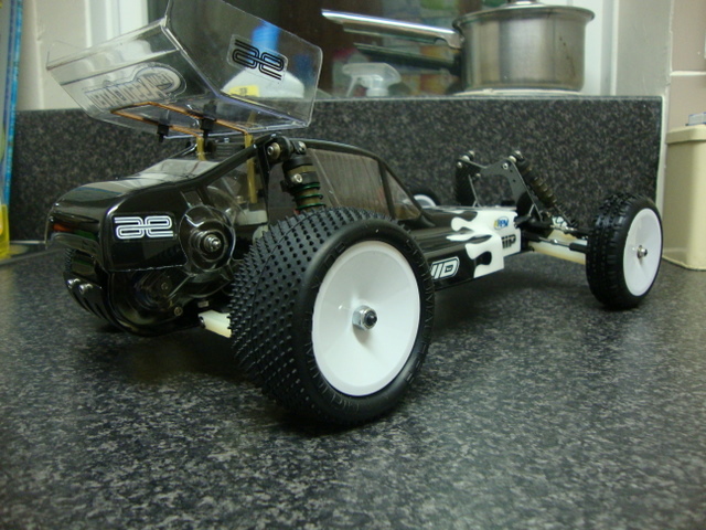

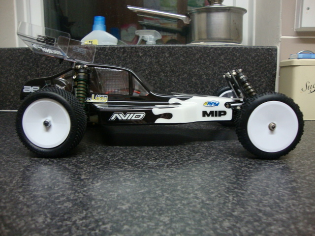

Havent seen anyone post any completed buids on here recently so i thought i'd put mine up
Been completed for a few weeks now, and was built for my local clubs vintage series. Ever since i saw the 'old is new' cars on here when i joined the forum i have wanted to build one so after almost a year of getting parts here and there i got her built! The specs are like alot of the others on here so i wont bore you with the specifics.
Basically after a lot of reading on here and a lot of purchases i ended up with a box of bits like this:
And after a few weeks of building here and there in the evenings when i had time i ended up with this:
As the keen eyed of you will see the wing tubes are made of brass, this was only mocked up so i could get some finished shots and they have now been replaced with proper alu tube.
She is running on a 9t brushless that i had in my 10t which is ample for our indoor mixed surface track. The first vintage round was on friday and i was very impressed with the car, it handles loads better than my team car so obviously it was worth the effort!
