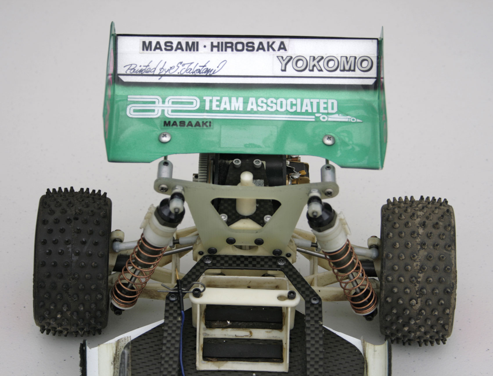

Re: 91 Masami Stealth replica (Arm injection molds ready)
Steve Hustings was kind enough to take a picture of the rear shock tower for me. Looks like what I was expecting as well as what others originally thought.
Jake
