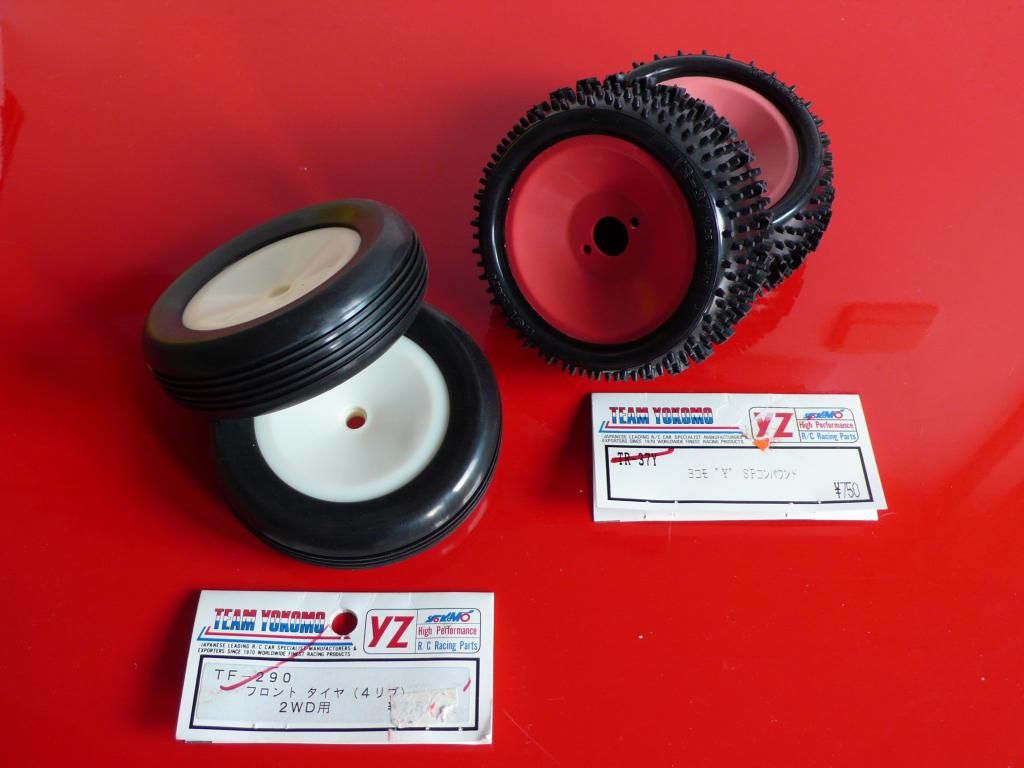

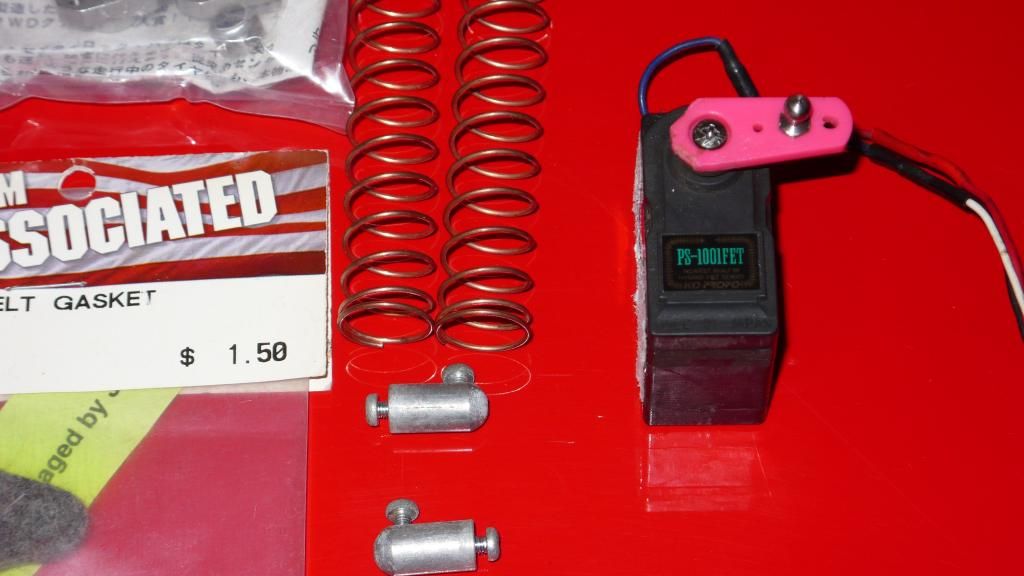

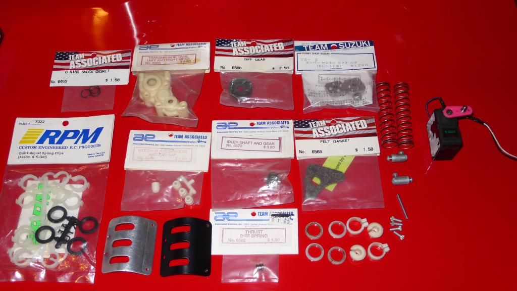

That being said I went down to the mancave yesterday and came back with a few hard-to-find parts already, many of them I had totally forgotten about! The true gems being the correct KO Propo PS-1001 FET servo, a pair of rear Yokomo copper springs and a bag of RPM white pre-load clips that will do the trick until I can find the Yokie ones.
I also found Team Suzuki rear adapters that will do until I can find back the Yokie TH-1 ones. I know I also have the correct TR-32 tires somewhere but need to source the front TF-330.
As you can see below I do have the TQ fron wheels and until I can find a pair of black ZC-825 rims, I will use a pair of pink ZC-835 of which I will trim the outer lips, drill holes and then die black.

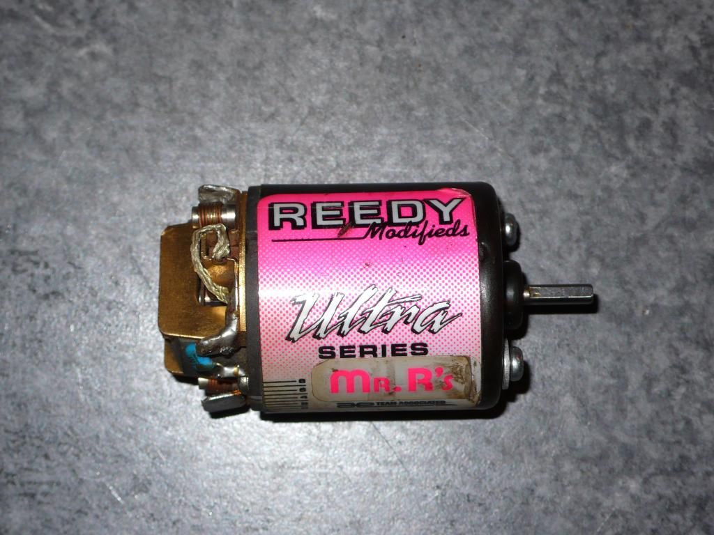

Regarding electronics, I'm still unsure about the exact motor used by Masami, most probably either a T (11x3) or a M (13x2). The servo is the one mentioned above, but have no clue so far about the receiver and ESC. Investigation is going on.

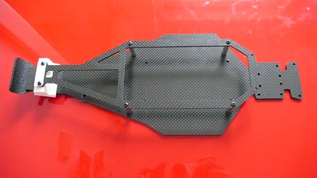

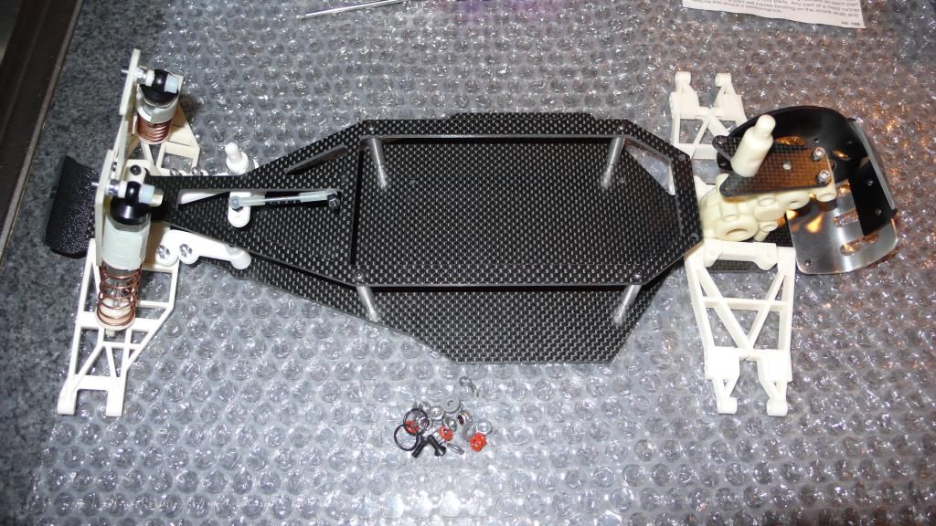

Made a test fit of the top deck and front bulkhead as I noticed the three front holes in the kick-up were not exactly centered and was afraid of misalignment, but in the end eveything seems to be fine, like mentioned in another thread I really don't see the need to chamfer the top deck. I didn't notice any major stress and first positionned all the screws then screwed them all one by one.
Such a fast and torquy servo for its era!

Masami used an M1c, the early one without the fuse. I would assume the receiver would be KO, but it was in a lexan case so it may be tough to identify. From pics i've seen, it seems like the plugs go in from the end. So i would say maybe a 285A, but that's just a guess.

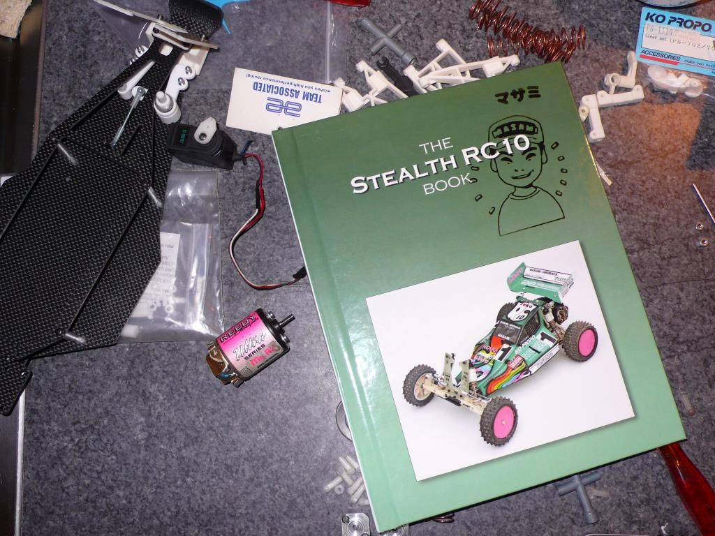

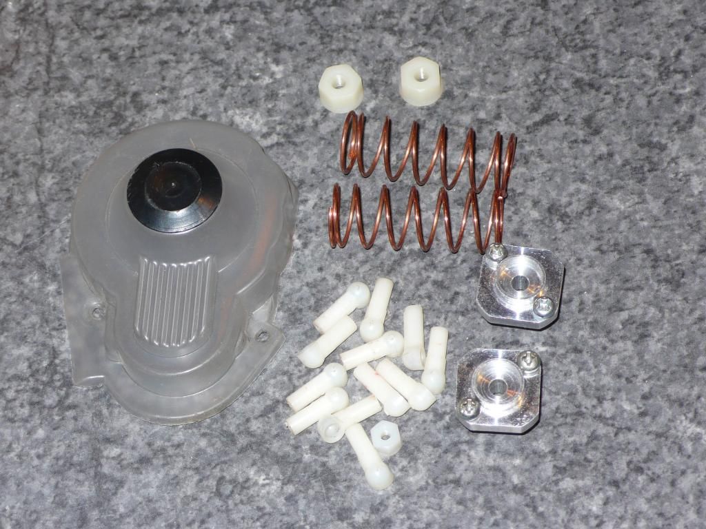

Today I made some baby steps by sourcing more parts from the stash, had to really dig deep to find the following missing parts:
- front copper springs
- TH-1 rear adapters
- Reedy Mr. R's
- white nylon nuts for the rear axles
- a full lightly used set of the correct ball cups (the ones with a small hex portion)
- early Stealth gear cover without the ribs

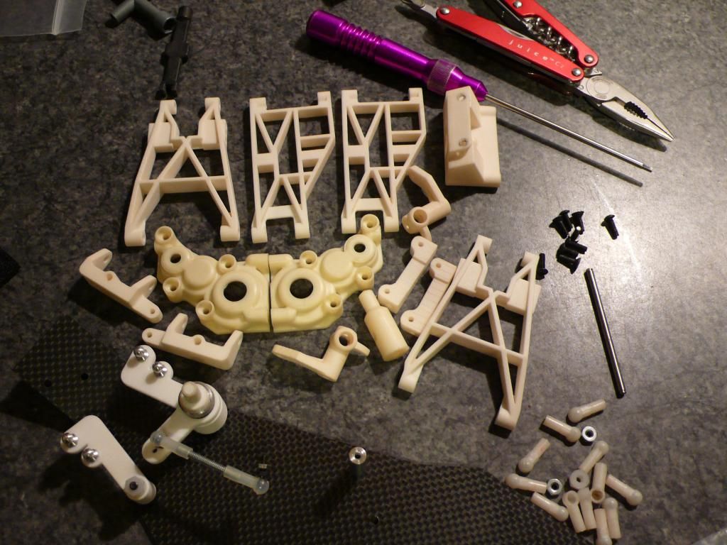

I also died all the Shapeways parts in coffee and left the steering parts apart. Worked great!

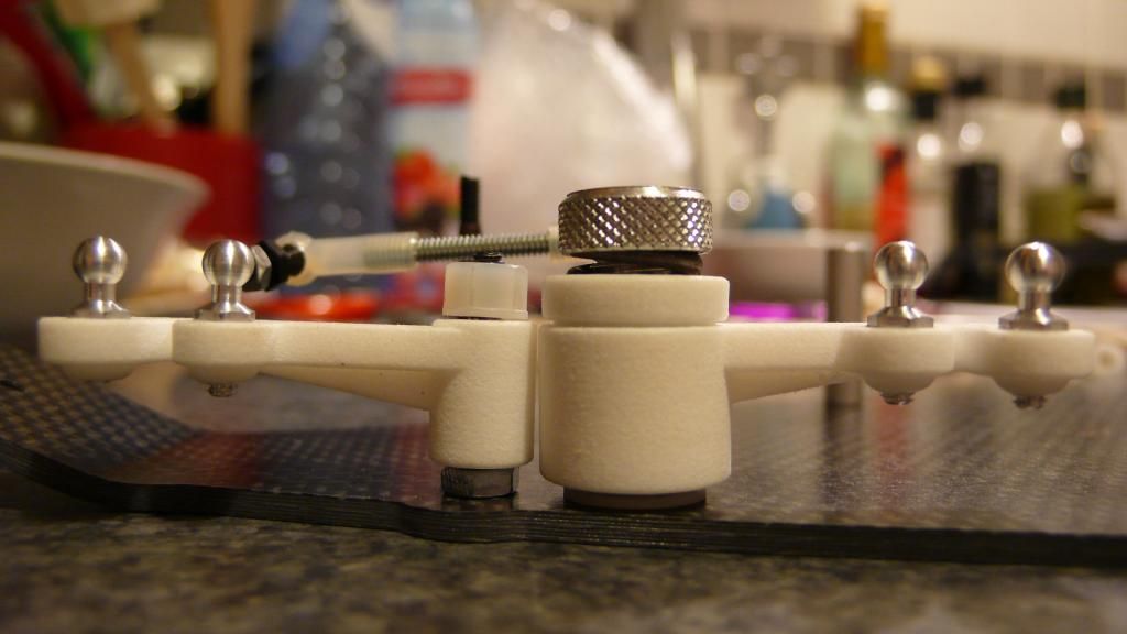

While test fitting the steering rack I noticed the right bellcrank is a tad higher that the left one (see picture below). I will solve the problem by adding a few shims on top of the nut that attaches the steering post to the chassis.

Even though the Mr R is not the correct motor, it will look perfect with the Mr R sticker removed. From what I have noticed, none of the team AE guys that ran Reedy, have any Mr labels. Mike Reedy used 3 digit numbers to keep track of each drivers motors. This was written in black Sharpie on a small white sticker. Though not 100% sure, I feel the three digit number was the same given by IFMAR to each chassis during tech. I think Masami would have been #304.

Now that you mention that it definitely rings a bell about the numbers being written on the motors and corresponding to the different drivers. Masami's car was indeed #304, but do you know what kind of winding his motor had? From the onformation I could gather so far, two other 4x2 AE drivers used a T (11x3) or a M (13x2). I would think he used a 11x3, but it's just a guess...
I might take off the Mr. R's label then or leave it as is. There are anyway many tiny details that I won't be able to mimic 100%.

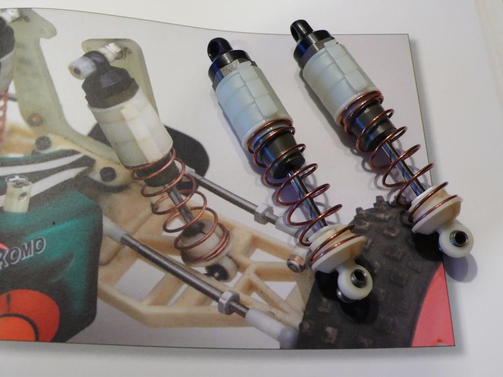

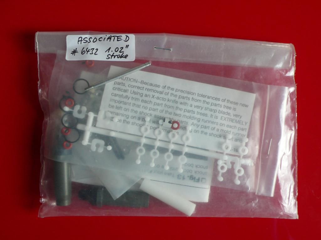

In teh meantime, I kept on working a bit on the parts preparation and made some slow progress. Was able to build the front shocks with the 1/8" inside spacer, piston 1 and 35 shock oil. The infamous Green Slime was of course at the party 8)
Then I used 4 Yokomo white spring rings (2 on each shock), the RPM pre-load clips (they will be replaced with Yokie ones eventually) and also added 1 internal square shock clip on each shock shaft. Sadly I don't have the early round ones that Masami used on his shocks but might consider buying the shock parts lot from Shapeways.

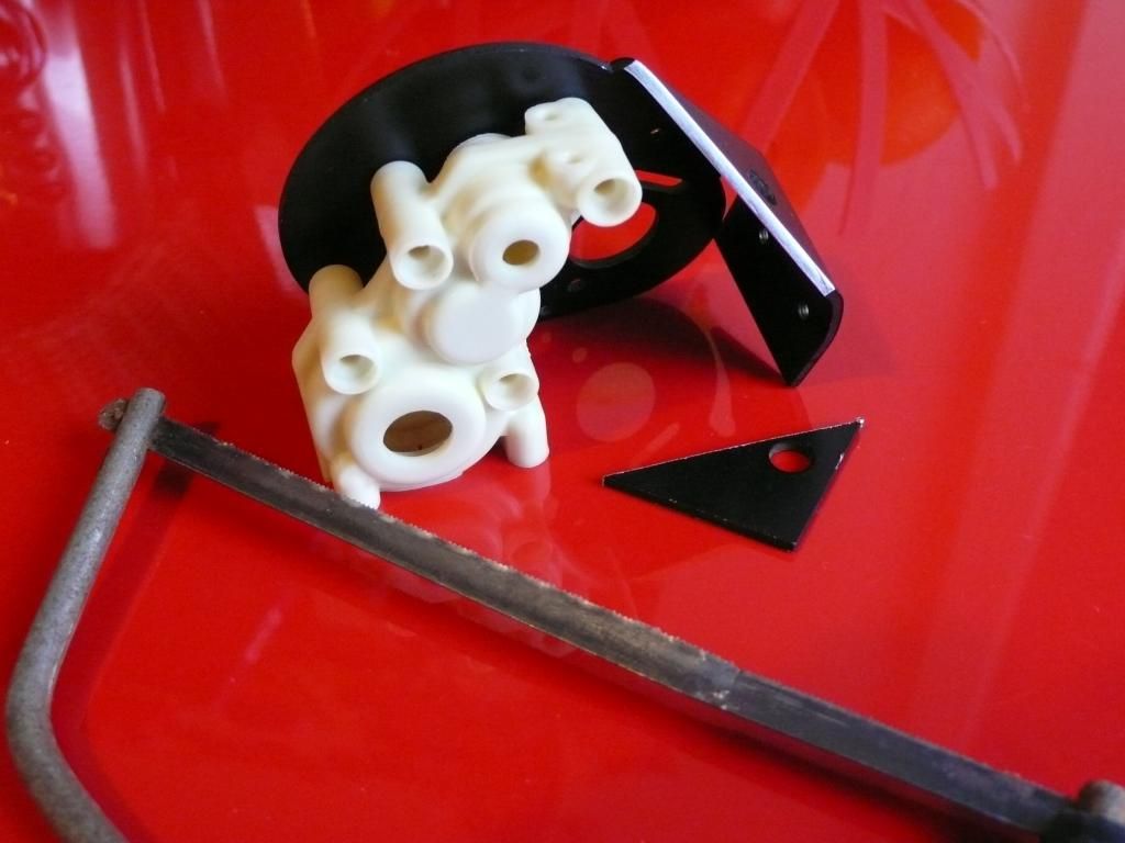

Then I also hacked a lightly used black motor plate and then filed and sanded the cut edge.
I also spent some time prepping the rear motor guard as it was only deanodized on the outer face.

What motor did Masami run? Most likely an 11 triple (MrT), but it is possible he ran a custom 10 triple. :wink: :twisted:

Yesterday, I popped in the Gene Husting video that covered the 91 Worlds. In it, Mike Reedy is working on motors. Every motor in the tray he was working on had Mr. labels. Just throwing that out there....

Well that video contradicts what I was told. I wonder if the motors shown are for regular drivers? I noticed they had the 3 digits written in pen on the Reedy Ultra motor sticker. Did the top drivers have a separate white sticker?
Great information.
slotcarrod
Posts: 4415
Been thanked: 45 times
Re: - '91 Stealth Masami replica -
Post by slotcarrod »
One other thing I noticed is the end bell has the number written on the gold heat sink as well. Also, seems only one motor has a white label in Reedy's rack of motors.
Edit: I noticed Rory Cull and Craig Drescher both have hand written numbers on the Reedy Ultra sticker. So not sure who got the white labels?
In another photo on Gene's video, it clearly shows Chris Doseck putting sheets Mr stickers on the Ultra label. So who knows, and why change the Mr label? Maybe to throw off apposing teams? It's not like they were winding arms at the track! Would be nice if Ruffy was around to give some more insight!

The hand written numbers are probably just inventory numbers. For big events, Mike would bring boxes of blank motors and pre-wound armatures. Based on whatever worked, he would assemble race motors at the track. It made more sense than bringing hundreds of built motors, and only using a fraction of them. The additional white label probably had the driver's name on it.
