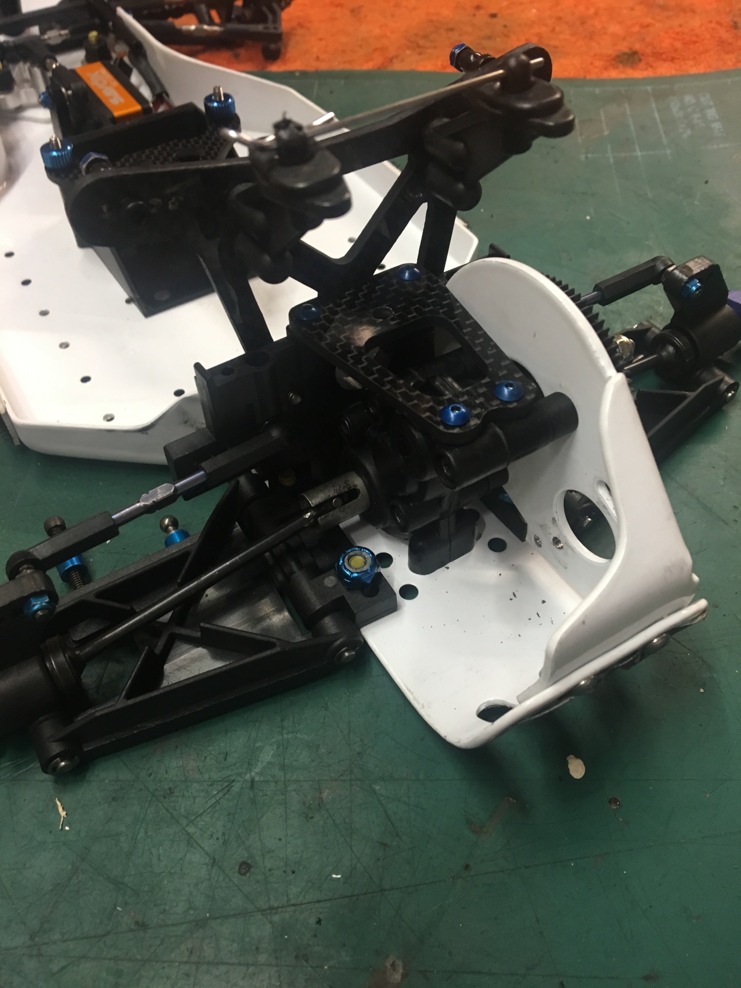

Glad you like it! Yes still use it a fair bit on the carpet and Astro tracks in the UK

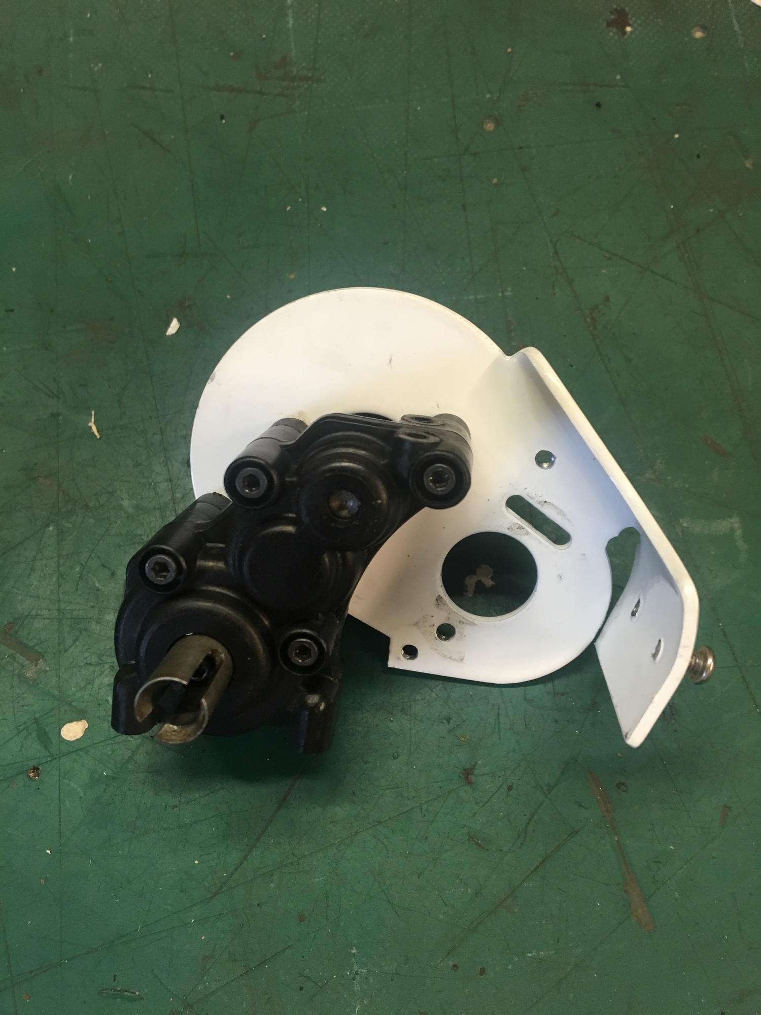

Latest pics:

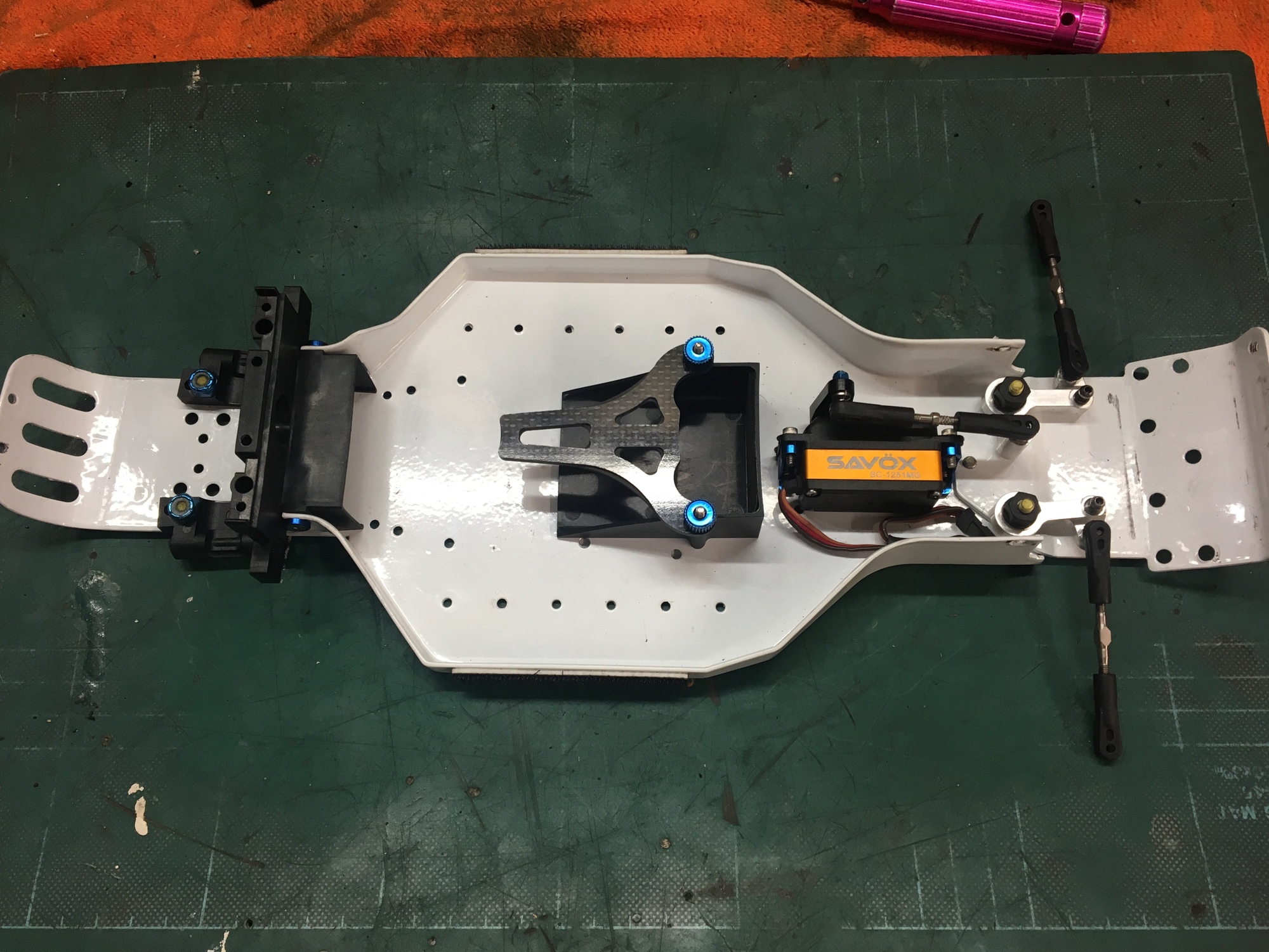

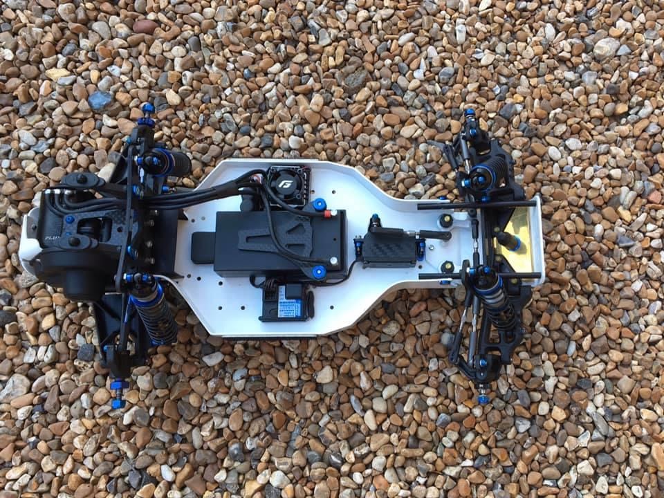

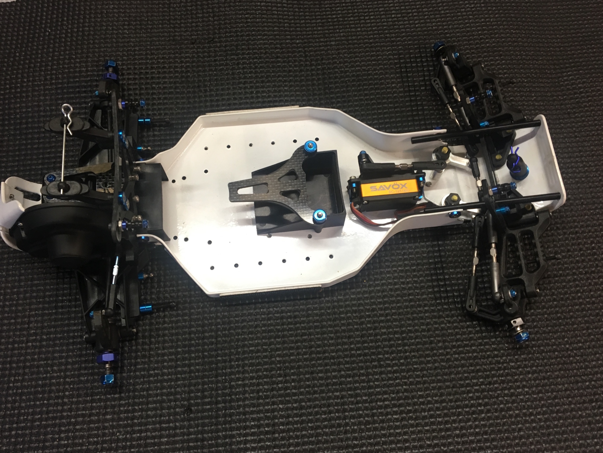

Progress so far!

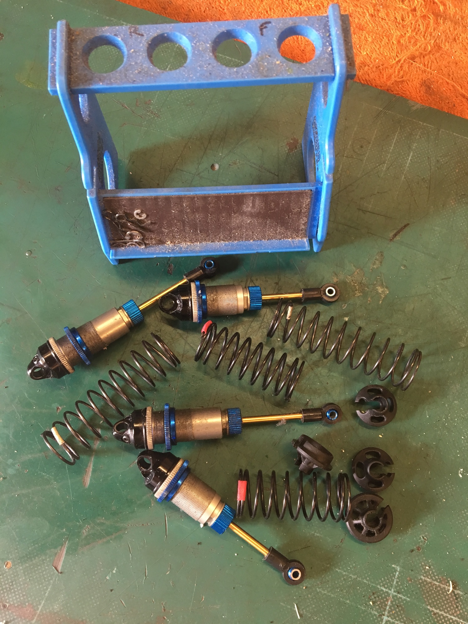

Shock refresh time!

Cleaned, fresh oil and mounted back up

What oil and pistons you run in those for this set up?

I’m running blue front and white rear springs
1.6 2 hole front 35wt oil
1.7 2 hole rear 30wt oil

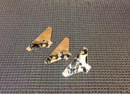

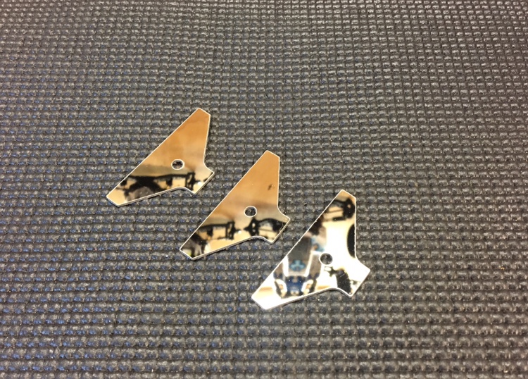

Designed and manufactured these new weights for the RC10:
I’m pleased to announce my second product release for the RC10!
This weight system is essential for our modern high bite tracks when running modern brushless/lipo technology
These weigh in at 10g each and come as a set of 3 x weights so 30g in total right where it’s needed on the car
These are made from mirror finish Stainless Steel and simply fit under your front body mount so are bolted down and won’t come flying out mid race like the stick on weights
Price is £20 for the 3 x weights
Drop me a message for postage costs and payment details 🏁

New electrics are in!
If in doubt go flat out!

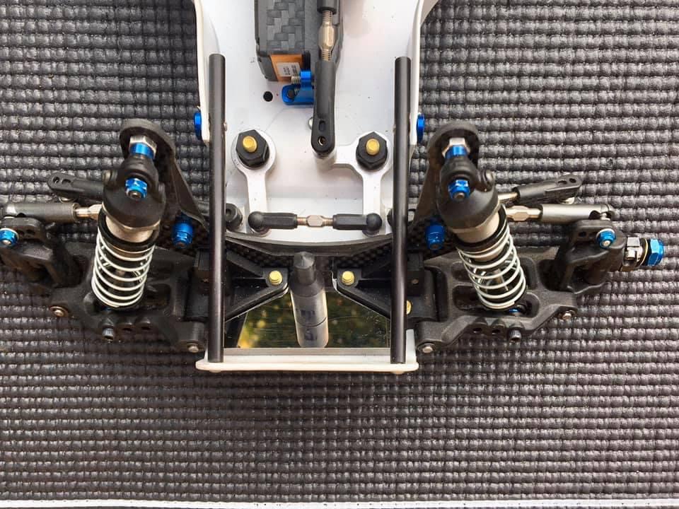

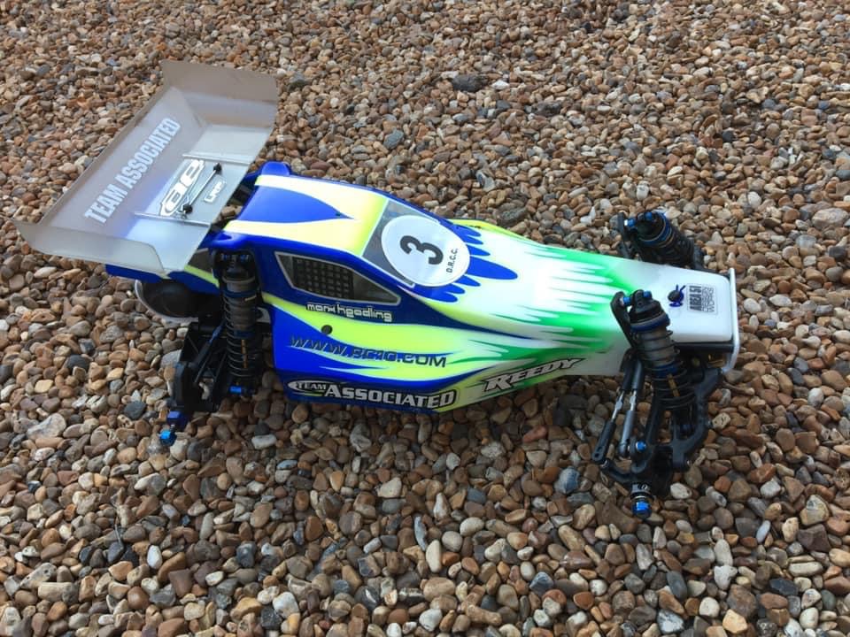

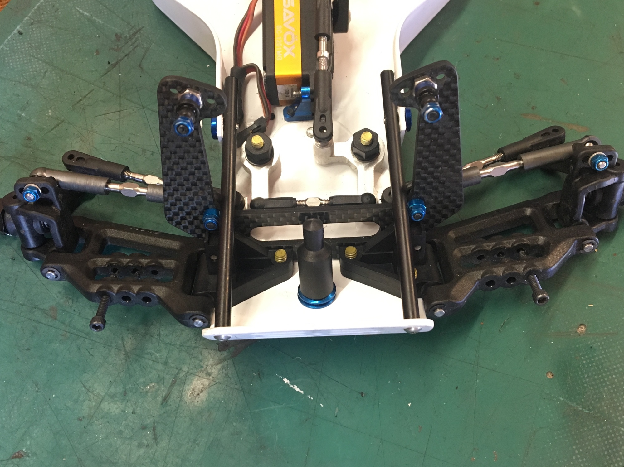

Put some v2 small bore shocks on the car and added my new nose weight I’ve produced

XLR8
Posts: 3318
Has thanked: 1684 times
Been thanked: 1180 times
Re: First RC10 Team, it's going to be a racer!
Post by XLR8 »

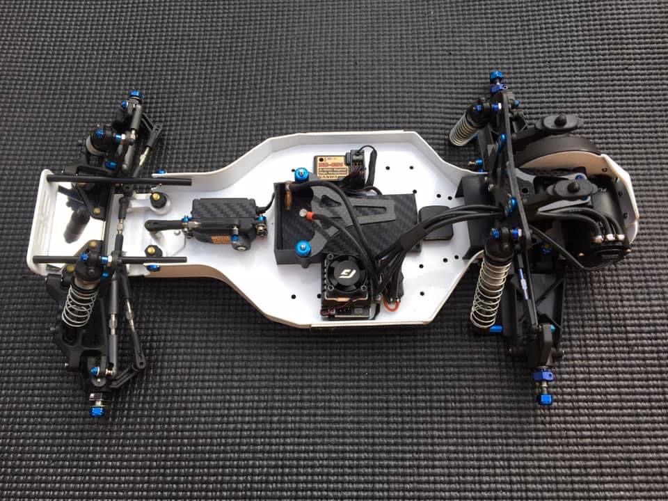

Looks like a great runner Mark. Clean, simple, straight forward, no gimmicks or other nonsense.
Thanks for the tour!
radioactivity
Posts: 856
Location: Dripping Springs Tx
Has thanked: 384 times
Been thanked: 618 times
Post by radioactivity »
If she runs half as good as she looks you got yourself a winner.
Really like the clean look.
