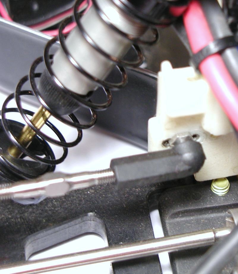

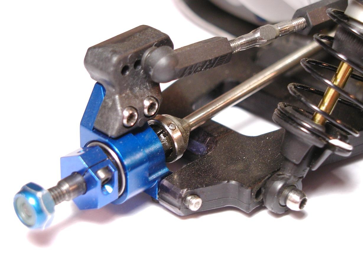

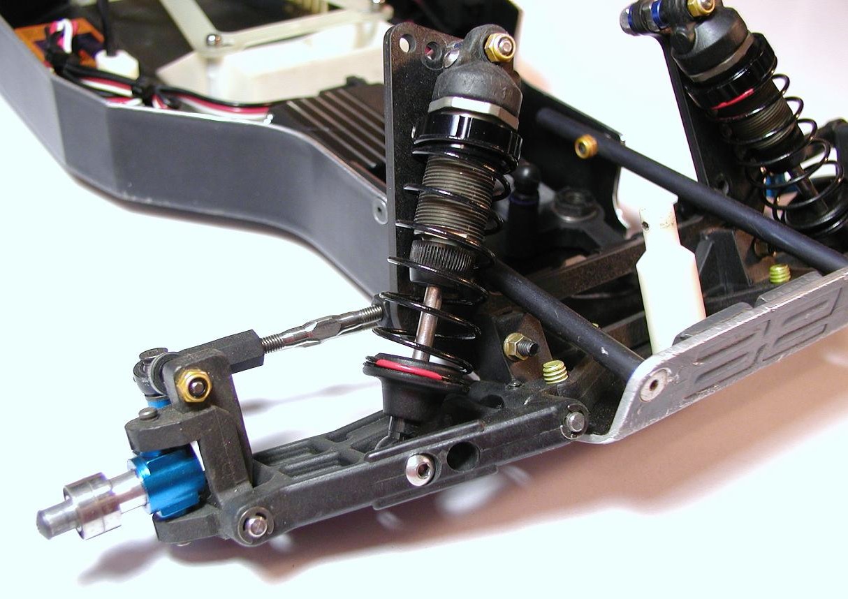

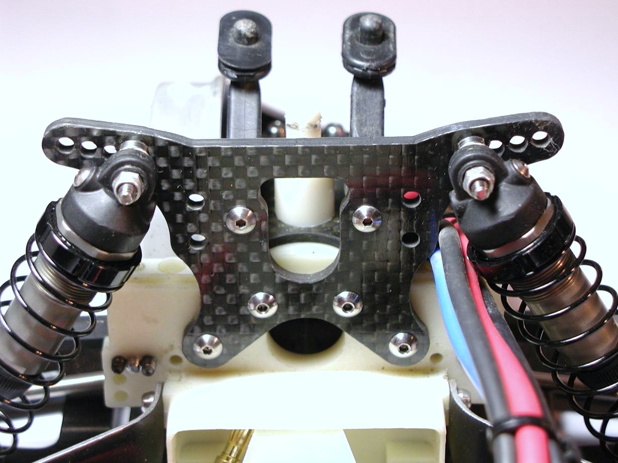

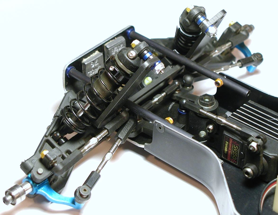

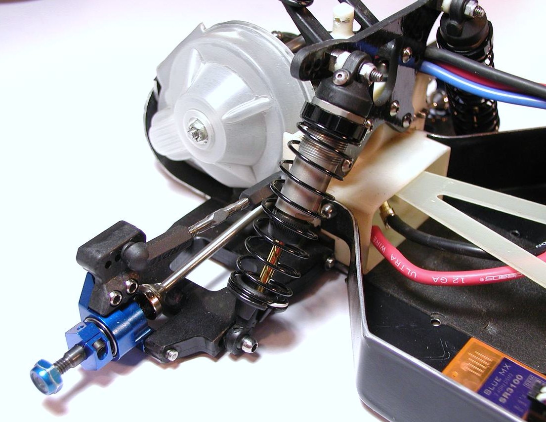

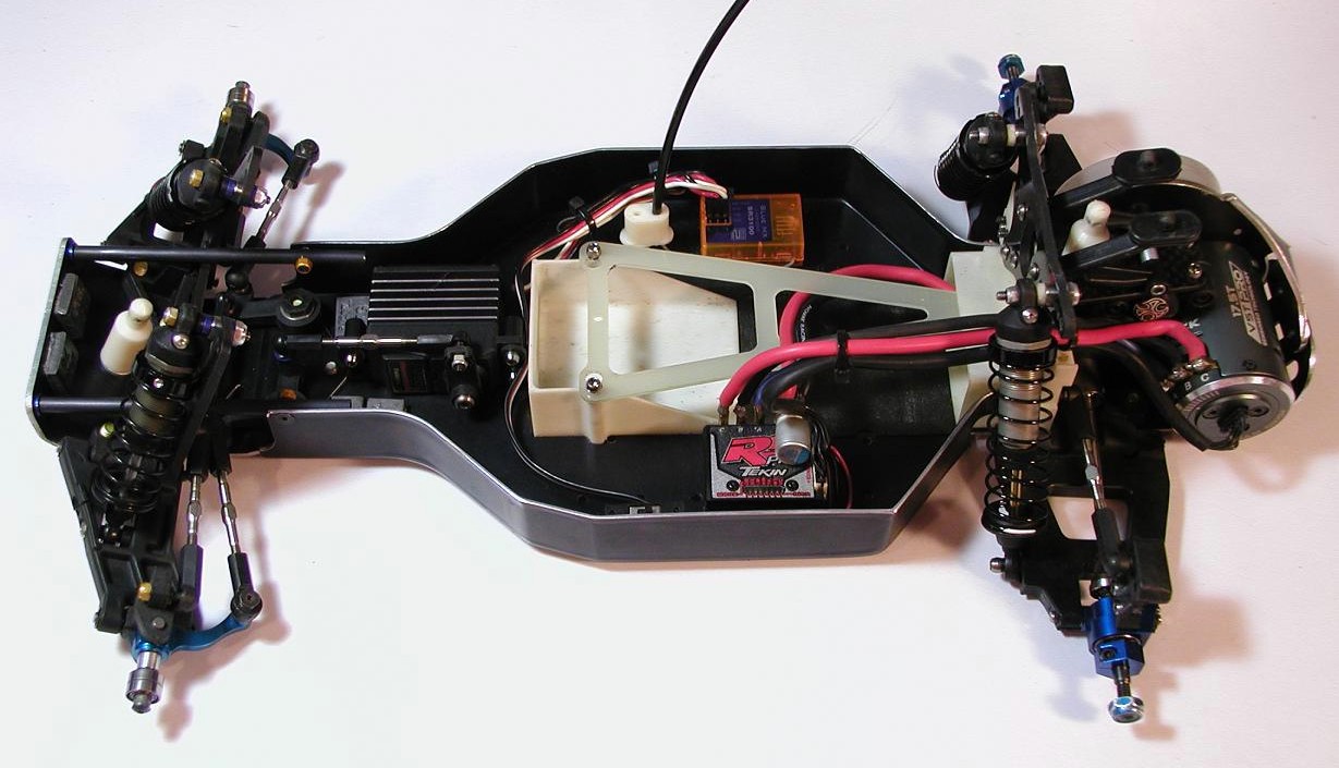

Well, I have had a few requests to post current pics and setup of my current team car platform. It is hard to believe that I first built it 3 years ago. It has gone through some revisions and fine tuning however. Enjoy -Jeff.

Very cool. Looks similar to what I had in mind except I'm going to use standard rear arms. I'm surprised how much weight you put in it and the rear camber link is shorter then I expected, but then again it is a short arm car. Thanks.

Sure, I will post a couple of body on pics. Just remember that is 3 years worth of running :lol:. And yes the camber link (rear) looks short, But is nearly the same length as the arm, so camber progression is similar to modern cars. You may have noticed the "middle" hole in the rear bulkhead for the camber link. This was done to allow the weight to stay transfered on the outside rear wheel while exiting a corner a little longer. This allows it to finish the corner a little better. I switch between it and the inner hole depending on track and tire. I know that it doesn't seem like much, but remember this is a short arm car. Small adjustments in tie rod locations are magnified when compared to a modern racer. Also remember that on modern cars camber locations are routinely changed by .030 of an inch to see tangeable results on the track. That means that if our arms are half as long, half that amount of adjustment (.015) would provide similar results. -Jeff

Nice rear tower. I'm going to use that design for inspiration if you don't mind. It's perfect!

Don't remember. I did however shorten them slightly to accomodate the B4 hubs. -Jeff

What did you use for axles with the b4 hubs and wide klein arms? Thats what im trying to do on my klein sprinter and cant seem to find an axle long enough....

Jay Dub wrote:Don't remember. I did however shorten them slightly to accomodate the B4 hubs. -Jeff
Did they have 2 outer mounting positions, like the XXX-cr?
