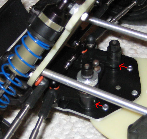

Looking good Jake, I would keep the buggy cranks but move them to the front holes.

Seabass
Business Member
Posts: 1402
Location: Mississippi
Re: New to me RC10T (Starting the rebuild)
Post by Seabass »
Well I moved the bellcranks up just as mentioned and I have run into a slight problem. The ball cups to adjust camber are rubbing against the ball cups used for the tierods when I try to turn the wheels. I ended up shortening the raods up front and using a die to cut some threads until I can buy a set of titanium rods. Why would the ball cups be rubbing each other. With the suspesion at full stuff, there is no steering up front.

bigjeepzz wrote:Well I moved the bellcranks up just as mentioned and I have run into a slight problem. The ball cups to adjust camber are rubbing against the ball cups used for the tierods when I try to turn the wheels. I ended up shortening the raods up front and using a die to cut some threads until I can buy a set of titanium rods. Why would the ball cups be rubbing each other. With the suspesion at full stuff, there is no steering up front.
Jake
Hey JAKE, Verry clean really!!!! I come up with some stuff every once and a while.. I also read where someone took a stepdown bit and reamed the belcranks to fit bearings (it works) did both sets of mine. AGAIN your TRUCK looks GREAT 8) 8) 8) JohnnySr.
