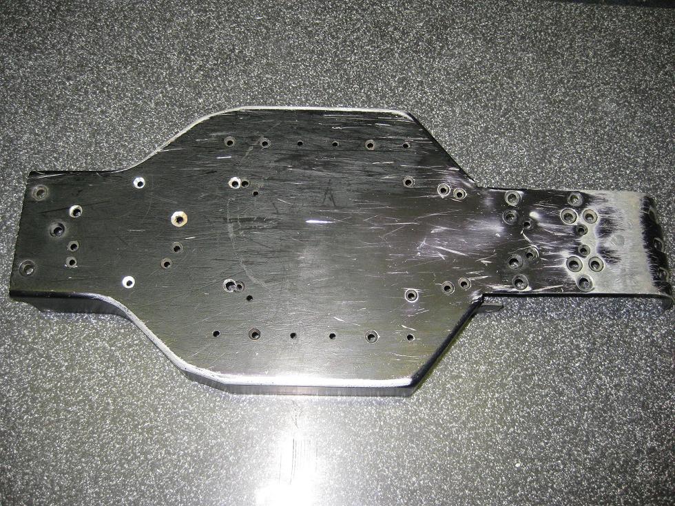

Has anyone tried welding the older worn out or unused holes to redrill fresh holes. I have an worn chassis with elongated rear holes and was wondering if it has been tried with good/bad luck. And looking for any advice.

it is 6061 T6 aluminum, so it's readily weldable. You have to be careful, once it's welded, it loses it's temper in that local area. For filling holes, it's not a big deal. just watch distortion, you'll probably have to fill a little extra and grind it flat.
if you can weld aluminum, then you should have no problems. 5356 alloy is what you need to maintain color matching after anodizing. If you don't care about anodizing, you can use 4043 filler.

I just finished welding up 4 chassis'. I filled in all the unused holes before I sent them in for powder coat. Because I was powder coating them and not anodizing, I used the 4043 filler like previously mentioned. I only filled two holes in though that had to be redrilled/countersunk. All the others were just filled and sanded flat. Here are some before and after shots of the welding before I sent them in for powder coating...... The 2 rear stealth holes on the second pic are what were redone.
