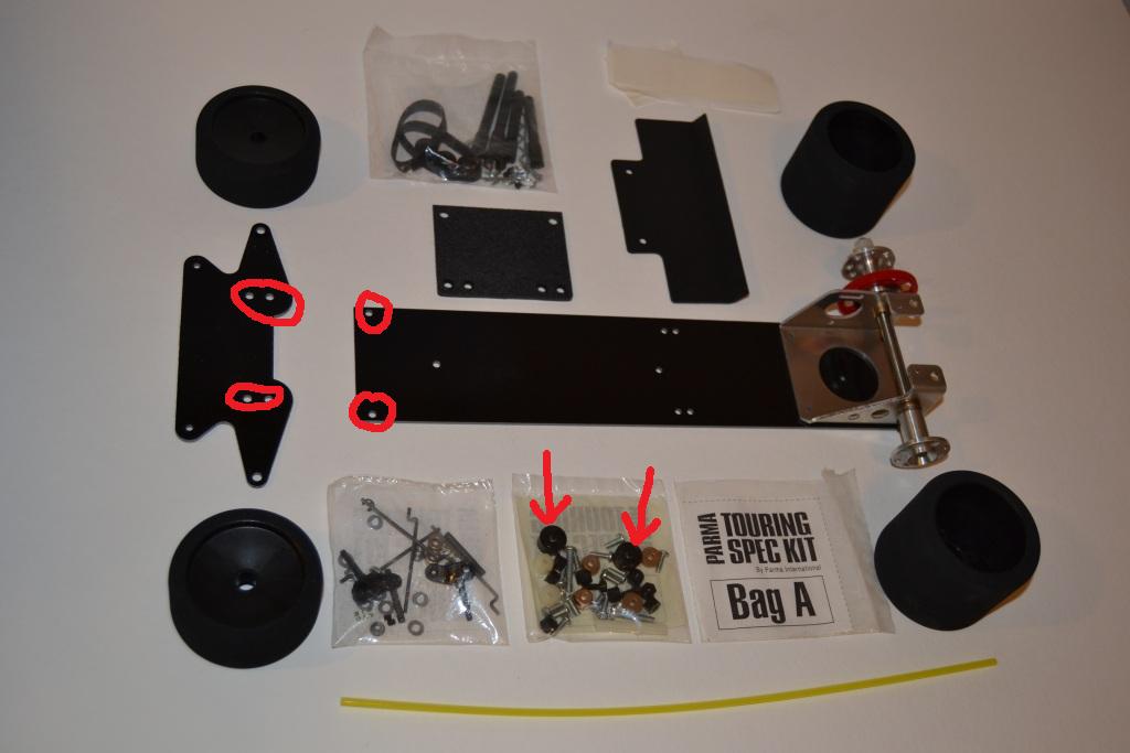

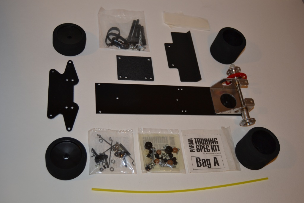

Hello,
I have a Parma Touring Spec Kit without any documentation. Do I have all the parts needed?
Do anyone know where to find the documents? Close up pictures from the front end would be nice.
Where should I attach the square plate with 6 holes in it?
-Niki-
Posts: 16810
Re: Parma Sport Truck
the front brace goes on just the way you have it layed out, lining up the circled holes. there are 2 sets of holes to adjust wheelbase. in the bag, i drew arrows to 2 large black spacers. those will go between the chassis and front end plate, and gets attached with the 2 large screws from the same bag.

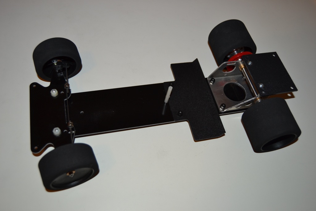

The square plate with the 6 holes in it mounts to the top of the motor pod. I imagine you attach the rear body mounts to that plate as well.

Thanks for the help. Is this right?
-N-
