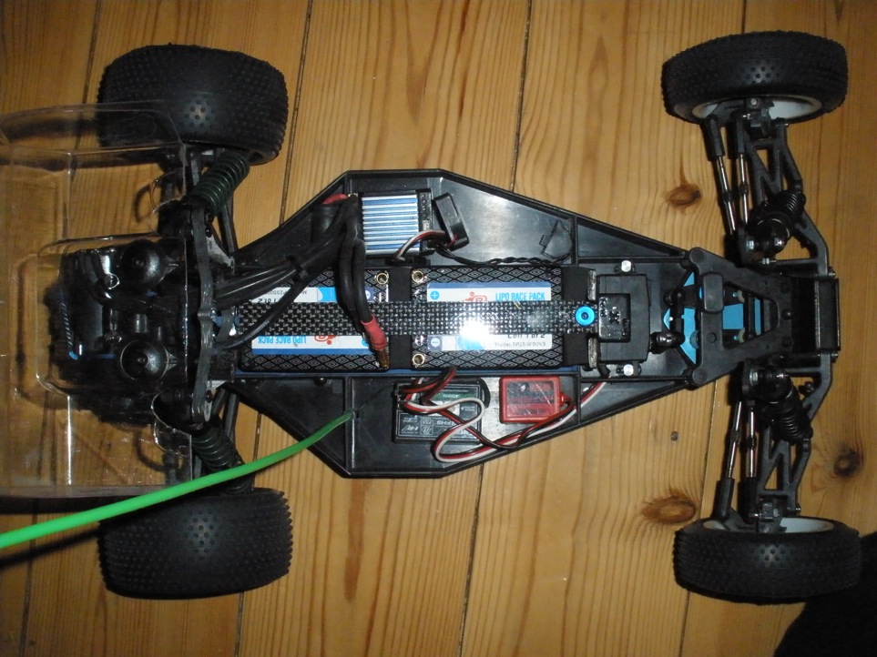

Anyway mine is a B2 with B3 front wishbones and a shock tower made from 5mm carbon fibre with a mod to fit the schumacher Boss cat wind holder so I can save my wing if I roll it. Ive also added four brass plates under the cells and goes down the cell holder perfectly and held in by the side foam tape that comes with the buggy kit. Each plate is 50g and totals at 200g and is now identical in weight when I ran it in the 90's. Ive also made a lipo holder plate to keep the lipos in and used a B4 batt holder to lock it in place. Its set for carpet and is using a 5.5 LRP X12 and is rather rapid. I will be doing the biggest carpet event in Europe in January and should do rather well with this. Now all I need is a shell and game on

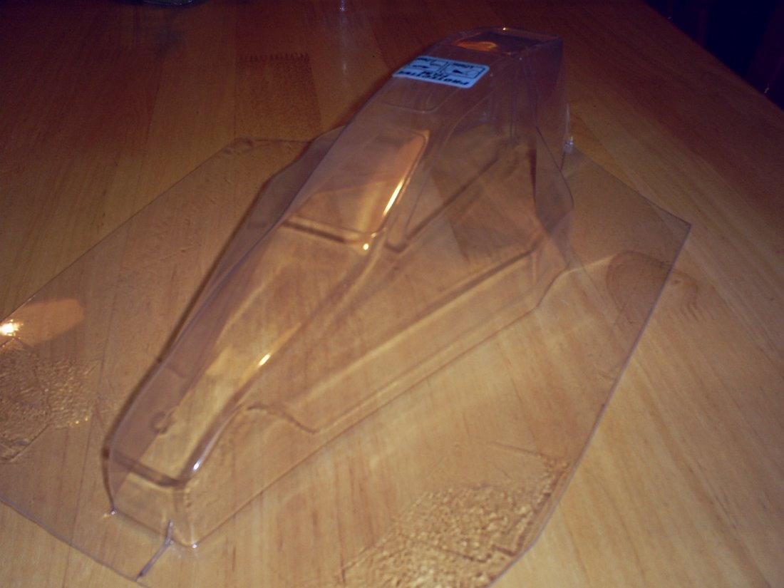

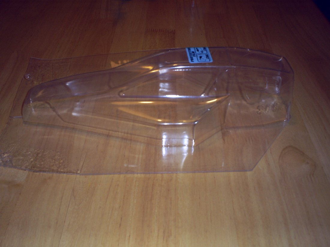

Re: RC10 B3 project (update 11-24)
Her a couple pics of the Deja-vu shell. I also picked up another B3 Worlds conversion with the Deja-vu shell, proline front and rear widebody wheels and the rear shock tower all for 19.99.
Why can't I find that deal in Seattle???mikea96 wrote:Her a couple pics of the Deja-vu shell. I also picked up another B3 Worlds conversion with the Deja-vu shell, proline front and rear widebody wheels and the rear shock tower all for 19.99.
