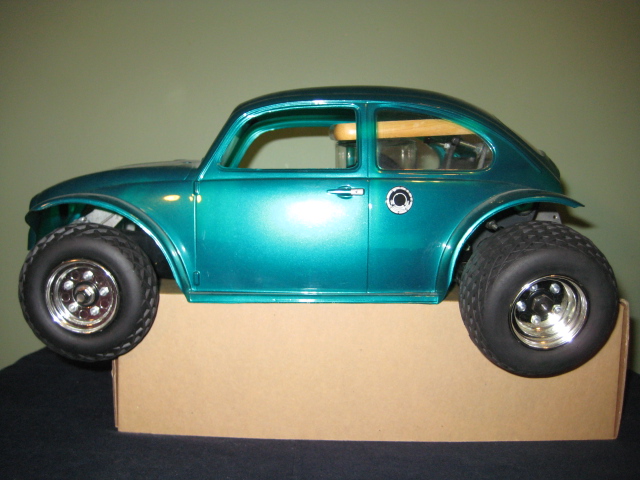

It's not quite as short as it looks in the photos, it looks to be somewhere between 9 1/4"- 9 1/2" from spindle to the center of the rear hub. It's about a full inch shorter than my Ultima, yet right about the same as the Tamiya '67 Beetle. It might be close to scale (stock VW) if if a typical Baja Bug body is fitted...

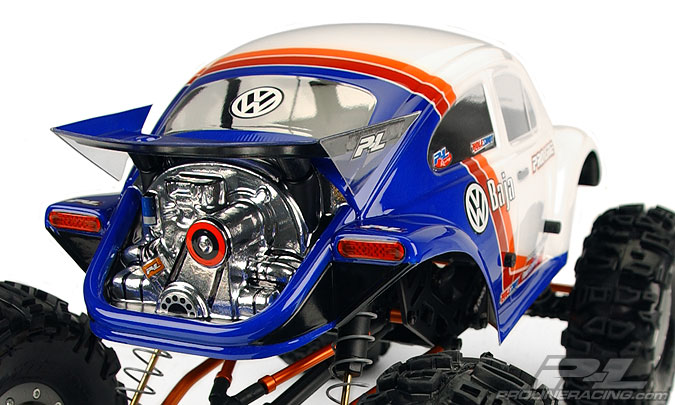

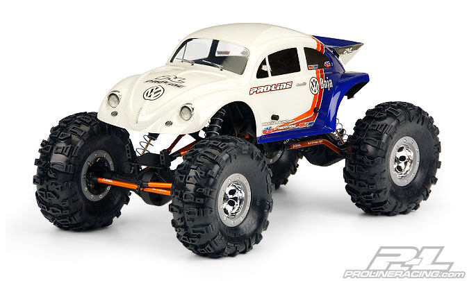

If I don't run into any road blocks during assembly, this may be a possible body idea. The wheelbase is nearly perfect. I'm not sure if the fake motor will fit over the Triumph trans though. I may have to check with the local hobby shop and see if a trial fit will verify the look I'm heading towards.
Like I said, I'm trying to build this one with a minimal investment in anything new. I'm not spending significant money on any more RC until I've saved up for the 'Scorcher. I may dip into my RC salvage and sell a few odds & ends to offset any costs.
I suspect the only money spent on this will be on the body & paint.
It may be awhile before it's 100 percent complete.

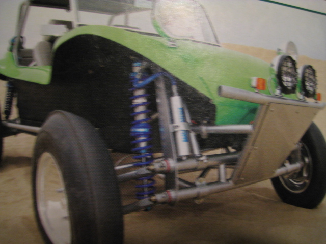

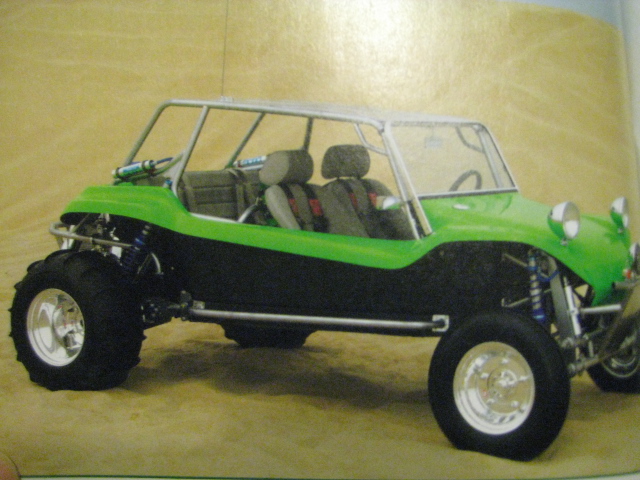

It's (track width) too wide for the Cox Baja Bug body (I've checked), but I think it would be neat to possibly do something similar to this:
I think if I shorten the chassis just a bit more, I may be able to make one fit.
A 70's dune buggy body might be a neat switch in subjects for a change.

Re: I have an idea...
I actually like the way the front looks on there. Maybe some black paint to help it blend in. You may have already figured this out but I'm pretty sure you're gonna have to cut down the sides of the chassis so you can get your tie rods hooked up.

Greenie wrote:I actually like the way the front looks on there. Maybe some black paint to help it blend in. You may have already figured this out but I'm pretty sure you're gonna have to cut down the sides of the chassis so you can get your tie rods hooked up.Pretty cool so far.
Thanks,
It looks like the steering is going to have to be fairly simple. I may set it up pan car style, since there isn't much of a way of eliminating bump steer if I used a typical set up anyway.
I plan on cutting the sides of the pan down to resemble a VW pan (and eliminate more holes). The strength in the chassis will be mainly from the Ultima chassis being bonded to the RC10's pan by a combo of sandwiching the front suspension through both parts, screws, and epoxy. I need to buy more cut-off discs for my dremel. I'm suprised how tough it was to cut.
I think painting or polishing (or both) the front end would look great!
