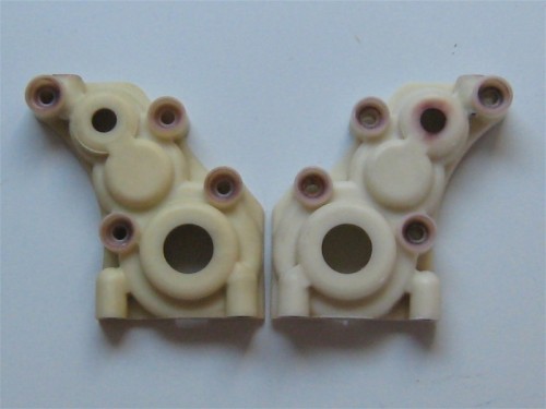

it's very sunny at my place today, so i tossed half a stealth case in a jar with straight peroxide. we'll see what it looks like later tonight.

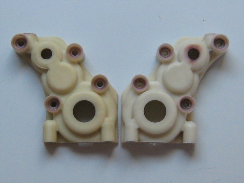

alright, so the case half on the right has been soaking in a glass jar, in the sun, in straight peroxide, for 8 hours. this is the best pic i can get to show a comparison. in person, it is noticably whiter than the other. it didn't do anything for the dye stains though.

ok just to update on the dyed parts i have soaking. there is zero change in the parts. the orange rear carrier is still the exact same shade of orange and the red body mount is also unchanged. so this method will NOT lighten dyed parts. but as shown it does help on the yellowed parts. our forecast for the next 2 days here is rain. is has been over cast most of the day but even when the sun can't be seen there is uv rays. is any of you have those uv reactive lenses in your glasses you should already know this. i dont but the wife does so i have been borrowing her glasses throughout the day.
my rear arm and trans half is still soaking in the 3% solution. i will be letting it soak the couple days to see how it does. i have propped up 2 uv cold cathode tubes on each side of the glass so it will be getting the needed uv rays. pics will come after i pull them out.

i definately makes yellowed parts white again. so, i'm going to guy buy some stock in hydrogen peroxide now.
