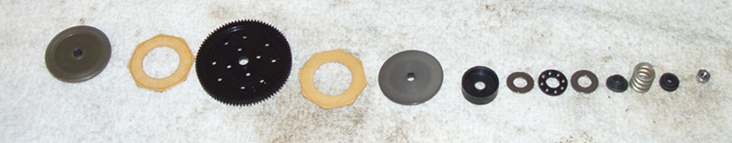

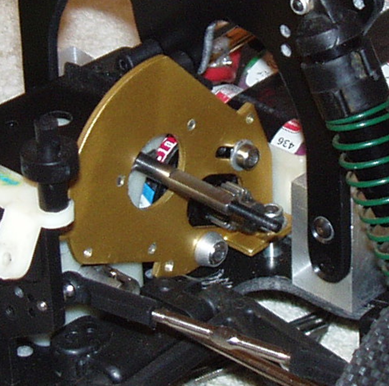

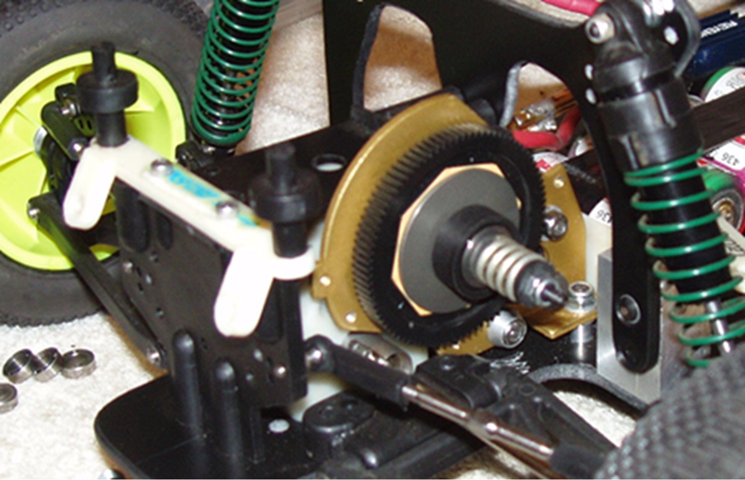

True, but you can get the RPM top shaft for the Hydra-Drive and use an Associated inner slipper plate (old style, smaller diameter than the T3) and then use a B4/T4 spur gear with slipper pads and a Losi outer slipper plate with a Losi spring...badhoopty wrote:the pita part about the rpm tranny is that you cant do the b4 topshaft and slipper swap with it like you can with a normal stealth.

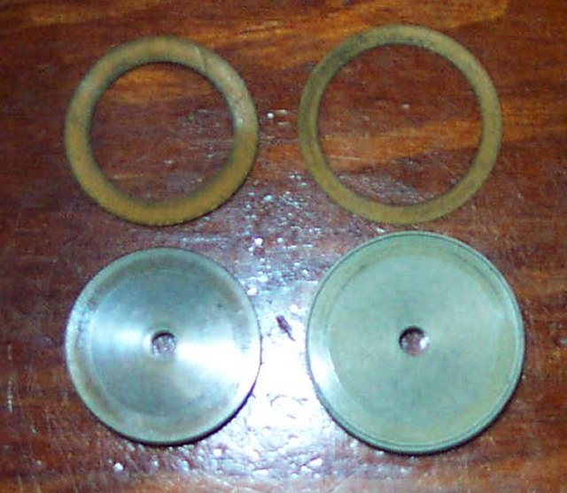

I compared the original slipper to a B3/T3 and here's the measurements
Stealth
33mm OD, 24.5mm ID, 383.86mm² surface area
B3
35.7mm OD, 28.7mm ID, 354.06mm² area
So the B3 actually has slightly less surface area but has more mechanical advantage due to being a bigger diameter.

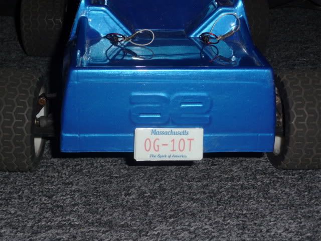

Re: Acerpower's RC10T runner

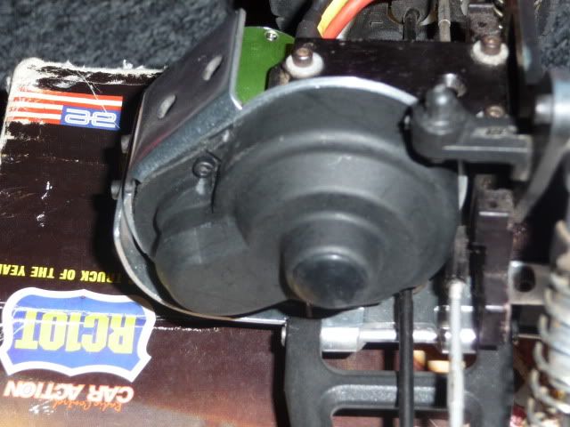

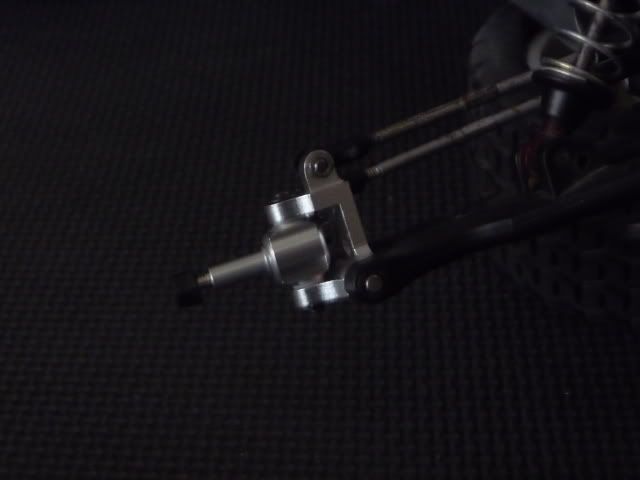

Since I run this truck and could use the extra durability, I picked up some aluminum C-blocks and steering blocks...............
I also modded an old Traxxas gear cover to fit...................

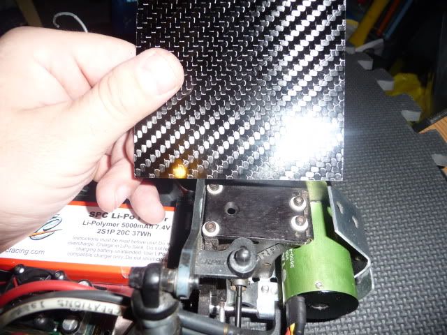

I also would like a carbon fiber transmission brace and since I have a small piece of 2.5mm carbon fiber I'll just make my own.

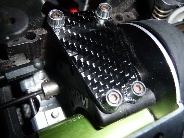

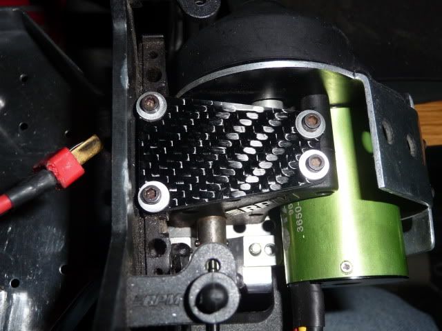

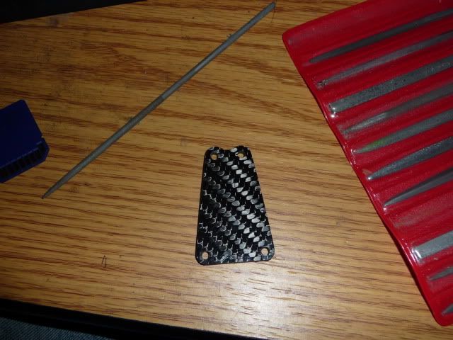

I made my carbon fiber transmission brace tonight.......................
It's nothing fancy but I think it looks better than the stock nylon brace.
I'll probably order the new turnbuckles tomorrow.
A dremel with a cutting wheel works best, then cut it a little over sized, and sand it to size to prevent chipping.
I also use some small hobby files for some shaping and to neaten the drilled holes.
I like to cover it with masking tape so I can draw the pattern on it, and it prevents damage to the finish.

I got my new turnbuckles and RPM ball cups.....................................
Instead of titanium I took the cheap way out and just got some new steel ones. I can always use the old ones as spares in case I break or bend one.
I figured if I got the titanium set I'd have to buy an extra set if one broke and I don't feel like spending that much on parts that wont really improve performance and doesn't look that much better.
Unfortunately while removing the old ball cups I managed to snap off a ball stud in one of my new aluminum C-blocks.
Luckily I could remove the broken threaded end from the C-block, but now I have to wait for the new replacement ball studs to arrive.
