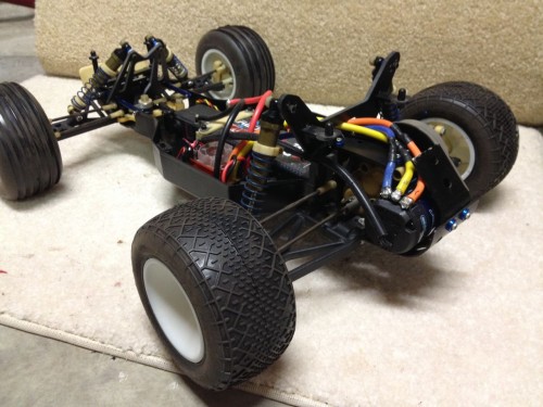

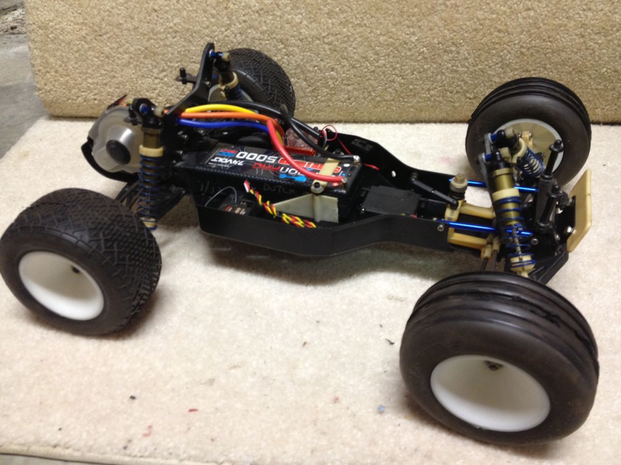

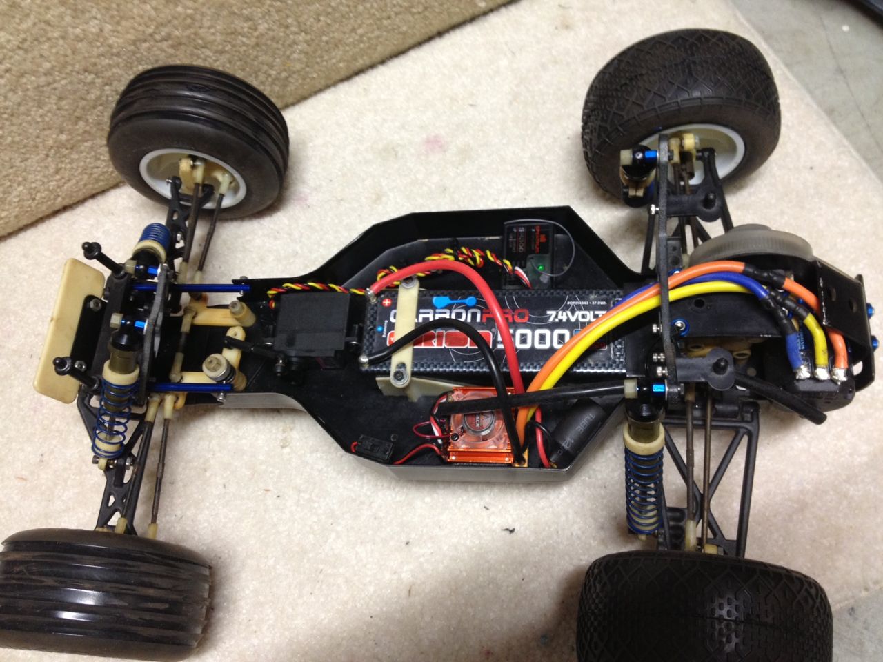

I recently acquired 2 RC10T's (thanks to GoldRush and another fellow RC enthusiast). I will make one a runner and the other a back-up that will be made into a backyard truck to play with the kids.
I have taken some of the better spare parts and such and put them into my runner along with some blue bling that I added. I have added some electronics (Hobbywing ESC with LRP 10.5T) and new rubber. I think that I am ready to race it now.
However, I do have some questions as i do want to change a couple of things out. Particularly the turnbuckles. I want to upgrade them to something a little stronger as I feel that my current stock ones might not last within a runner setup. I have tried doing a search for some vintage titanium ones, but with no success. What sizes should I look for? I can buy some FT blue ones as they come in many different sizes.
Also, I have a couple of vintage bodies now, but would really like to find a new clear vintage one that can be painted up. Where might I look for such a vintage body? What about modern bodies? Will those work on the vintage setups?
Any suggestions would be helpful.
Enjoy the pictures though. I am excited with how it turned out! :D

Based on the pictures of my truck, how would one know if it is a 7011 or 7035 model? Or something else?
Thanks!

However, would you happen to know what model my truck is? 7011 or 7035 or something else? Thanks.

It looks really good. Also it looks more like a #7035 team truck. Does it have bearings and rear universals? The 7035 came with universals swing shafts instead of dog bones as well as bearings with the hard anodized shocks. The 7011 kit had gold shocks, all bushings with dog bones. Someone correct me if I'm wrong.

janaya wrote:It looks really good. Also it looks more like a #7035 team truck. Does it have bearings and rear universals? The 7035 came with universals swing shafts instead of dog bones as well as bearings with the hard anodized shocks. The 7011 kit had gold shocks, all bushings with dog bones. Someone correct me if I'm wrong.
all that info's right. The 7035 had a graphite trans brace as well. That truck may be a 7001, which had the hard anno shocks and dogbones with a plain nylon trans brace.
