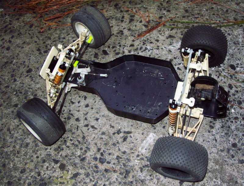

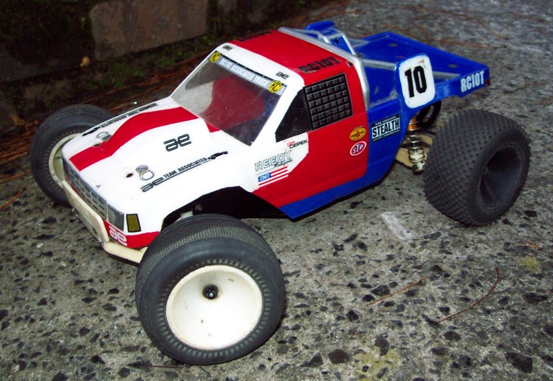

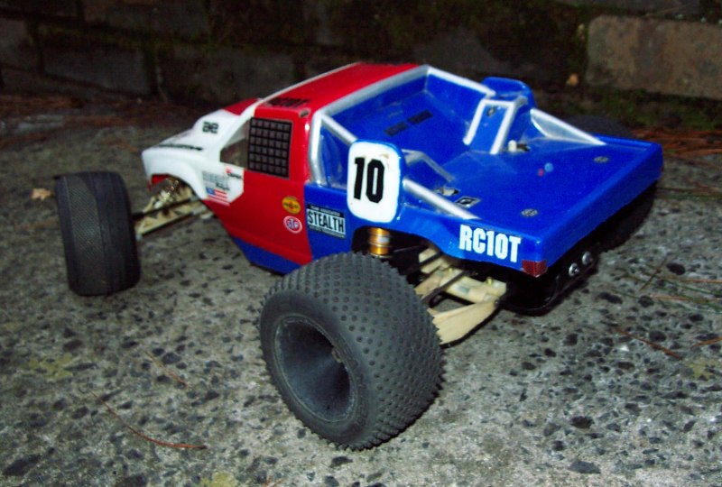

This just arrived. Cost $51 off Ebay, seemed to be the best way to get a white stealth transmission I can use in a buggy. Now I just need to get an RPM 2.65 box for this as I doubt I can gear it to run any really fast motors with the 2.25.
Comes with a drilled chassis and crudely lightened motor plate, need to replace the turnbuckle ends as 4-40 screws don't even fit down the centres of them. For some reason they've put the rear arm mounts backwards and put toe in hub carriers to cancel it out. So it's got no toe in and pro-squat.
Shock tower is split in the middle have to make a new one and need to neaten up the custom trans brace.
Body is Bolink, never seen one before, I think it looks alright! Came with ballbearing steering, dunno who made that.

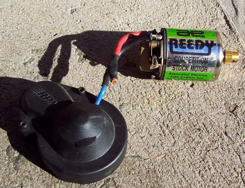

Also came with an old Reedy stock motor in pretty good condition and RPM gear cover.
I plan to give it a run at some big meets in truck mod, I imagine it'll handle somewhat like my T2 which is my favourite truck to drive.

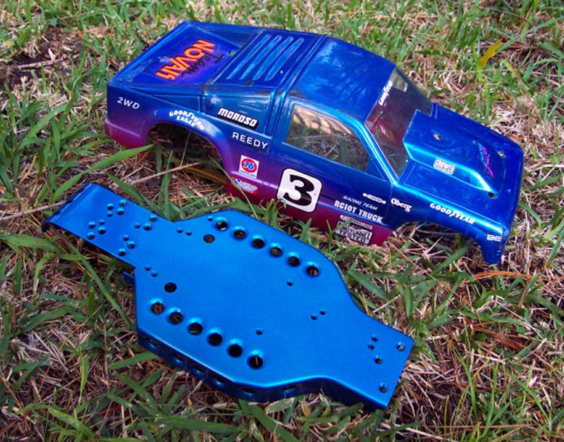

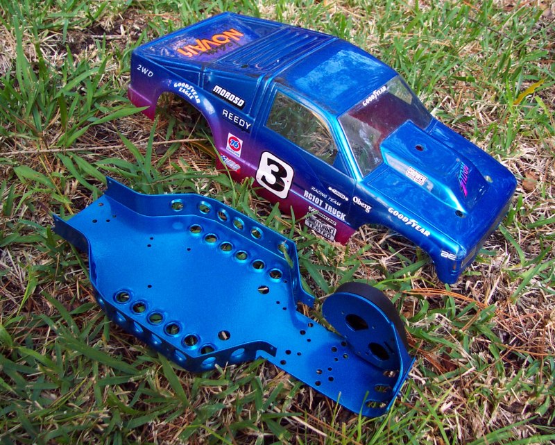

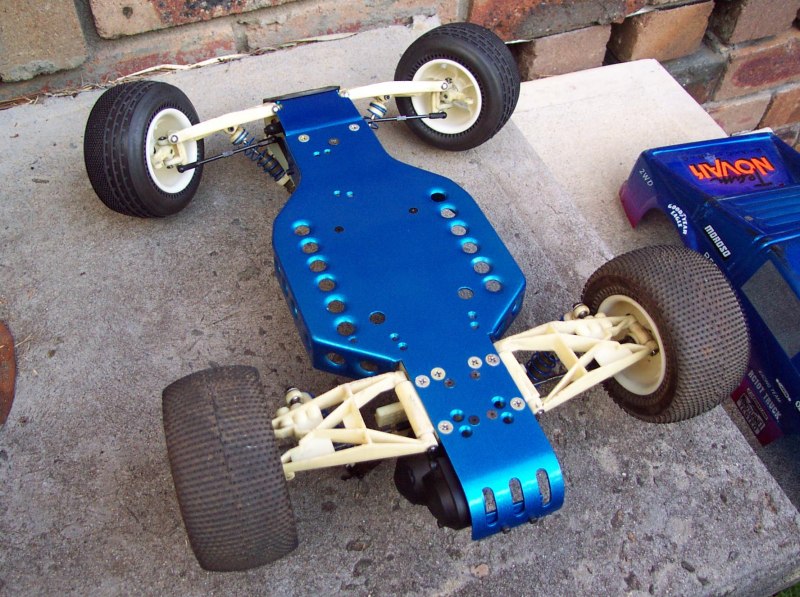

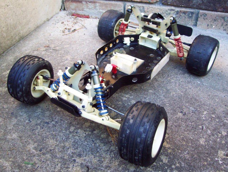

Been doing a bit of work on this one..
Made a punch and die to flare out the lightening holes to give it a bit more stiffness. Was going to paint it black but had a can of this cyan blue paint on the shelf and noticed it matches the body pretty well so I painted it with that.

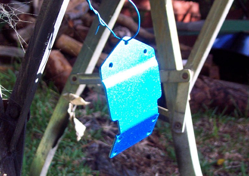

Also made a nose plate specifically for a 10T with RPM bumper, only has the forward mounting option, no bumper mount and didn't countersink the bulkhead screws.

very nice lil project you got going on there. I like the blue paint, it's going to look great with all the white nylon. My 10T and T2 handle pretty much the same in my opnion, but I'd definatly go with the RPM trans conversion. I did that recently with mine and WOW what a difference. I was fortunate enough to have a radar gun at the time thanks to matchbox and with the exact same motor, battery, and electronics the 10T increased its speed, plus the motor didn't get as hot. Good buy Bugle
- cyclepsych0
- Posts: 189
- Joined: Wed Mar 19, 2008 1:21 am
- Location: San Marcos, CA
Re: RC10T runner
I like the dimple die flares. Seems like a good way to "fix" a chassis that has had a hole drilled for servo saver access. That is one chassis mod that always looks like it was done with a wood cutting bit. Just match the other side with a hole and flare 'em. Plus, it does have the benefit of being functional, since it strengthens what it lightend. Lookin' good!!

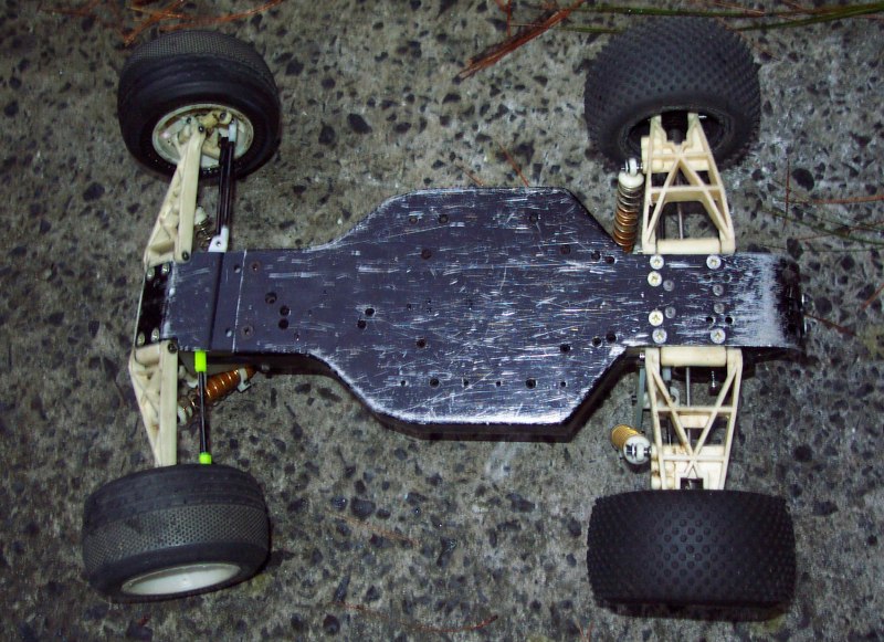

Also just received another $50 truck today not as good a deal as the 1st one i think, must be a later one as the suspension arms are much thicker all round, has 1/8" shock towers and the 6 gear mounting holes aren't countersunk.
Body is a half arsed attempt at a box art paint job and then excessively trimmed around the wheel arches and at the back.
Needs a clean up as the shocks leaked oil all over the suspension and will fill in the chassis scratches and paint it black. Just have to make a transmission brace and antenna holder already have battery cup.
Good for a runner anyway!

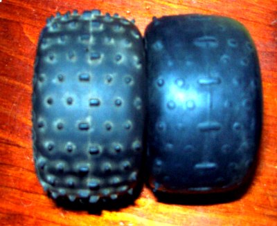

I noticed those Proline tyres aren't exactly the same as AE tyres, they rotated the moulds slightly to make 1 big paddle in the middle.

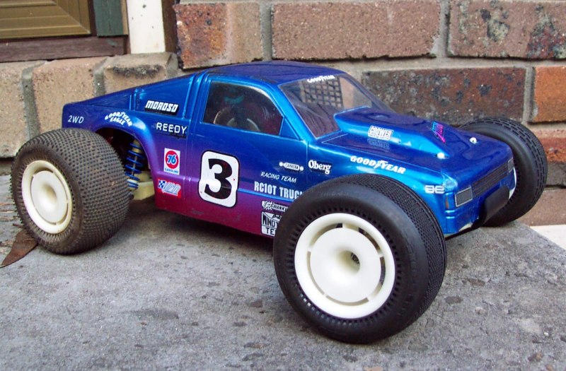

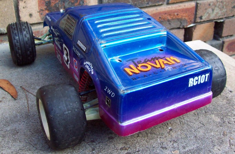

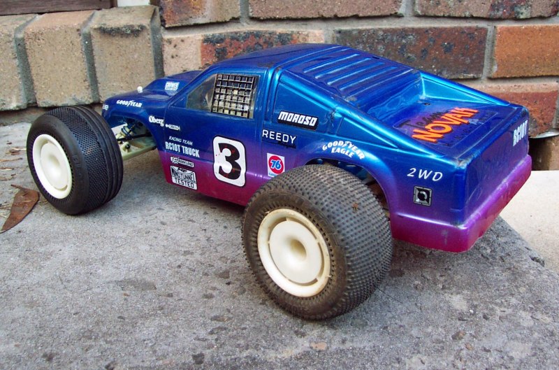

Almost finished reassembling the blue truck. Made a carbon fibre rear shock tower because I didn't have any white fibreglass, will probably make a cf front tower aswell sometime. Just have to make a transmission brace, rear body posts and sort out some steering linkages.
