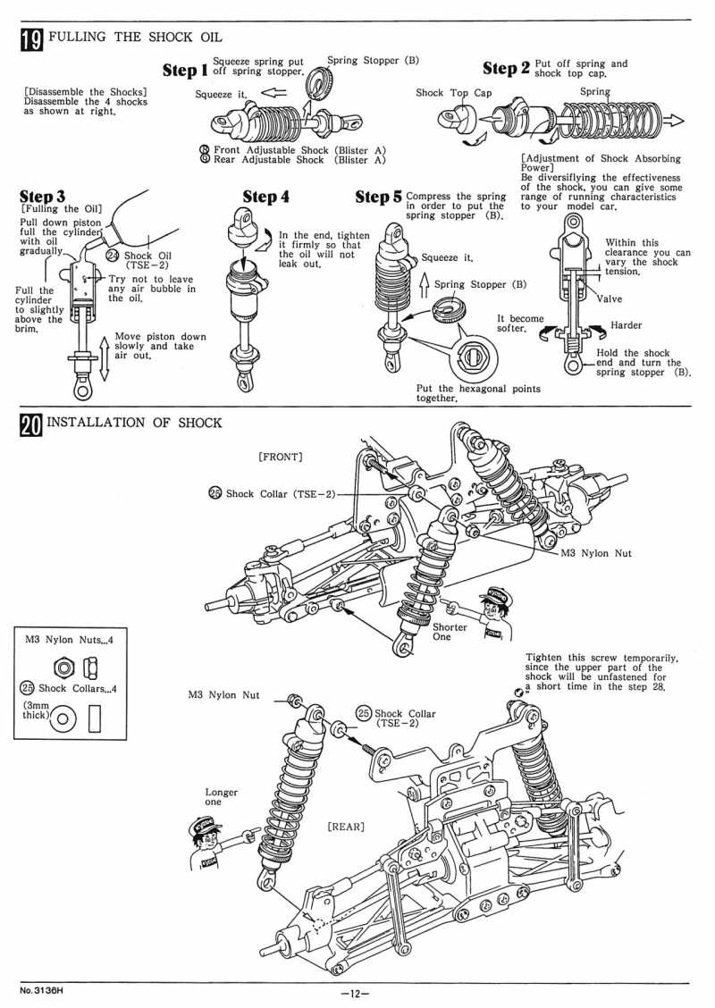

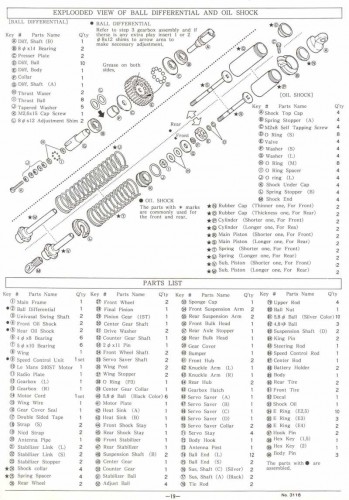

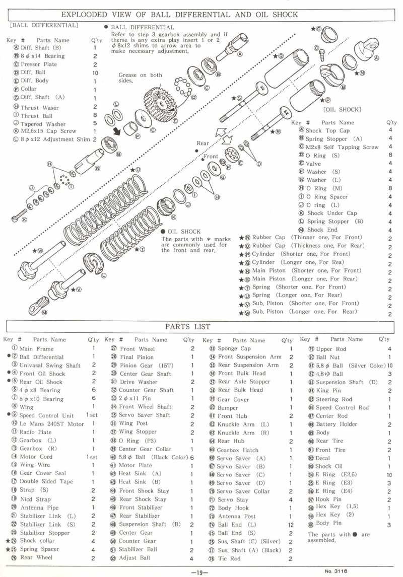

The idea of platinum shocks were that You can adjust piston without opening the shocks. This mechanism require more parts, more leaking points and more mass. I found two pics about those platinum shocks that might be helpful.
Jirka
