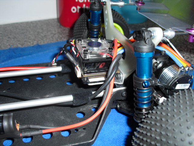

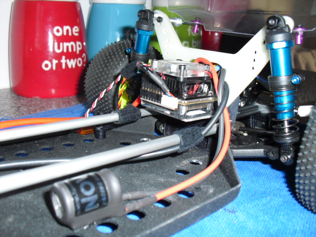

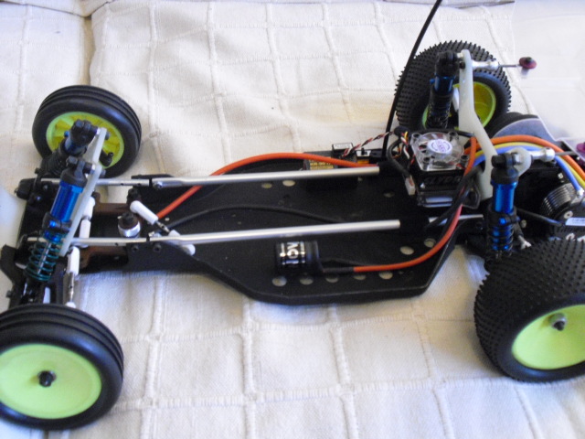

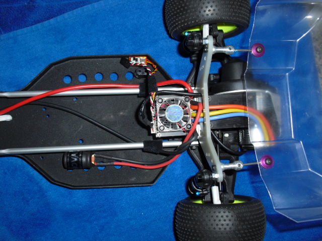

nearly there just need to put the servo in i am goin to fit a stealth av got one some where il rebuild it soon looking good.
- DerbyDan
- Posts: 1837
- Location: Northampton UK
- Been thanked: 19 times
Re: project rc10
Hey, looking real good! I bet thats going to be capable of kicking some serious B4 Ass
BTW what brushless set-up have you fitted??
