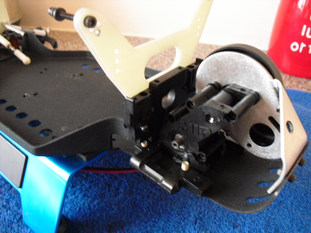

ive got the mip tranny rebuilt and in .does any one no which slipper i can use on this. the rear robinson racing rear blocks are in now i need to drill the alloy poles what go down the middle and get them fitted.

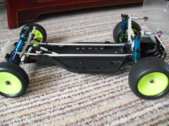

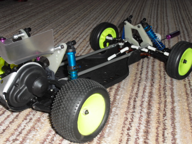

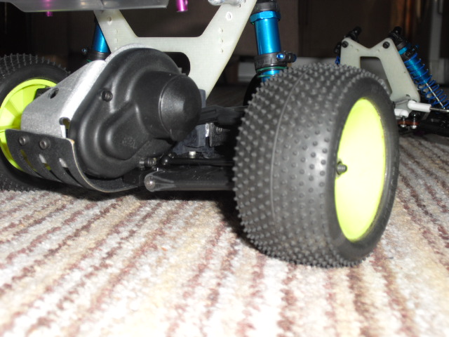

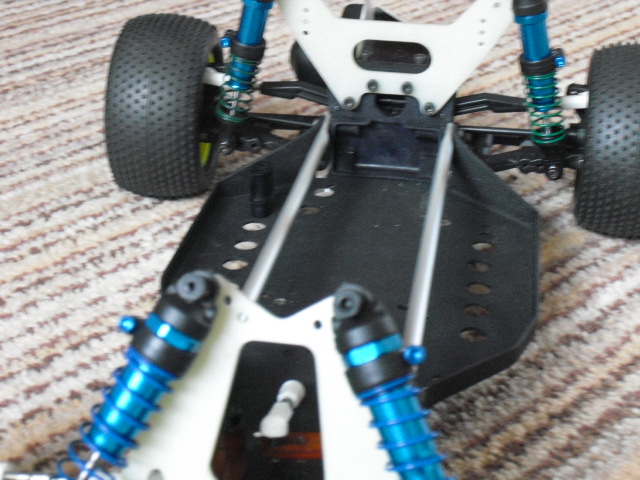

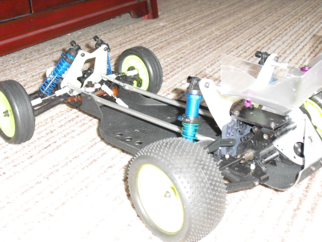

Well its almost built ive got the 10t steering on so its a bit longer im gona get a pair of 10t front axle to make the front a bit wider . It took me two goes with the alloy tubes down the middle the first pair were a bit to thin so i decided to go with the fatter ones ive flatend both ends so they fit better just need to fit the battery cup for the lipo. The rear ive got a mip tranny robinson racing arm mounts b44 cv's b4 hubs the lest is on the right and right is on the left so the ball ends and rods sit straight the cv's catch a tiny bit still waiting for a new pair of out drives . am gona try and fit a stealth top shaft in the mip tranny so i can use a slipper but il have to change the cog from the mip shaft to fit the stealth shaft not sure what to do yet .

Post by SnoopMaxx »
Is it these hubs ?
9584
and the rear CVA 9756 for the B44
with RPM buggy arm's 70542
Just want to be sure b4 I order any parts :wink:

The Stealth top shaft will not adapt to the MIP tranny, the pitch is metric in the MIP and imperial in the Stealth. Anyway, if you plan to run it, I would really consider buying a used/useable Stealth tranny, easier to get parts for it, easier maintenance and definitely better performance/durability...

yes them are the bits using b3 wheels it ends up being slightly wider than the b4.

ive got a stealth lying around . are these mip trannys not up to much .

well the Stealth is directly inspired from the MIP tranny and is, in my opinion, way more better and reliable, especially with today's electronics.
