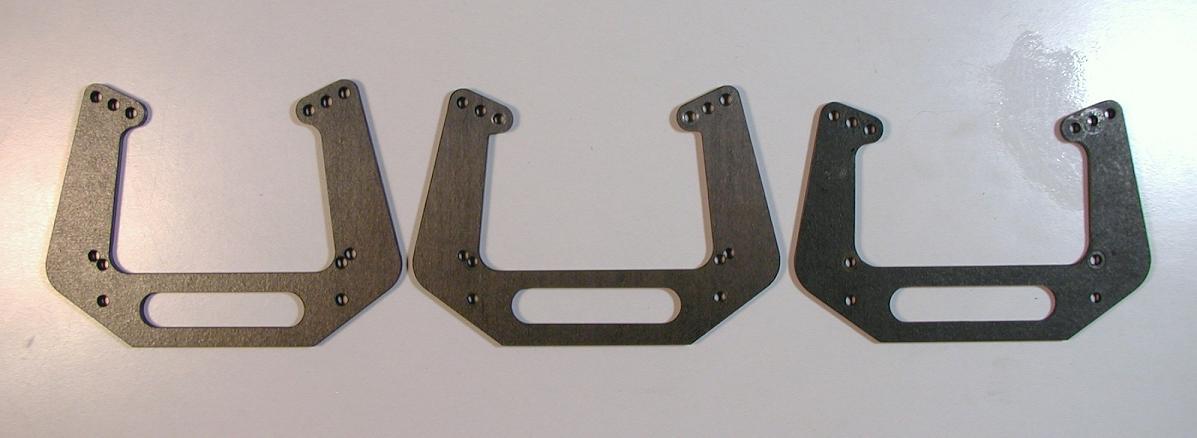

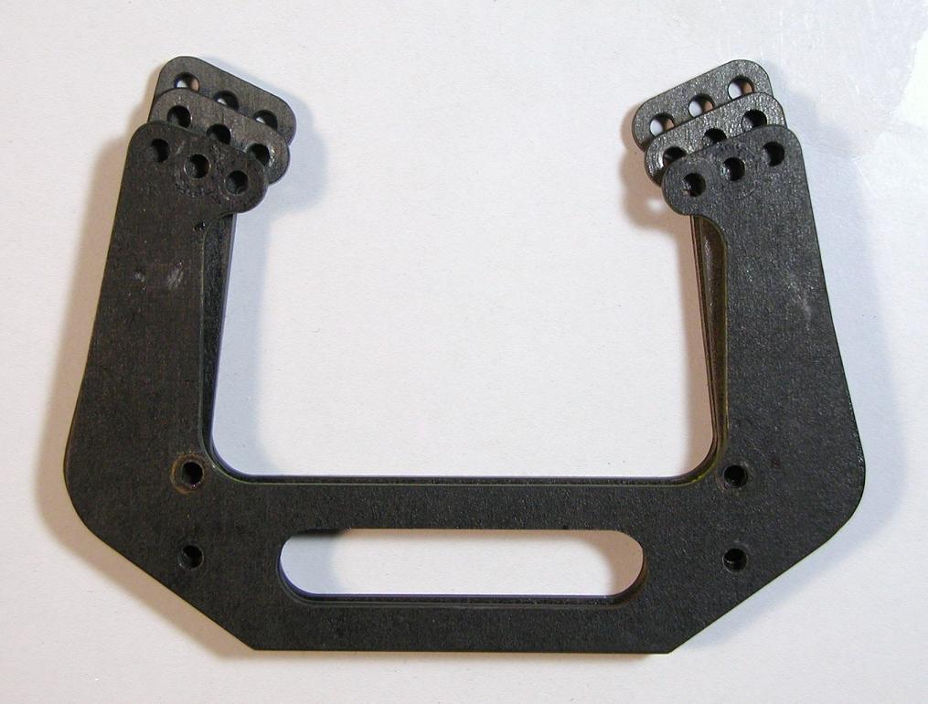

Here is the latest. The original is on the right, and the two succesively longer units are on the left. -Jeff

are they cnc milled?
Jay Dub
Posts: 1136
Location: San Jose, Ca.
Re: Finaly built an RC10...
Post by Jay Dub »
Yes :D . -Jeff

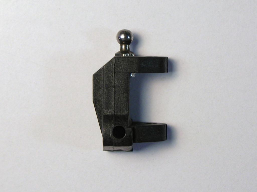

Little update. I tried a castor block mod today, hoping it would allow for a vertical adjustment on the front end. In my particular situation it won't work. So to all of you who are thinking about it, don't bother unless you are running in a situation with limited suspension travel (oval maybe). This mod puts the new location in the same vertical plane as the stock location, and out about .020 in. The problem, is that its movement bottoms out at the top of MY travel, and won't allow for any further vertical adjustment -which defeats the purpose :roll: .

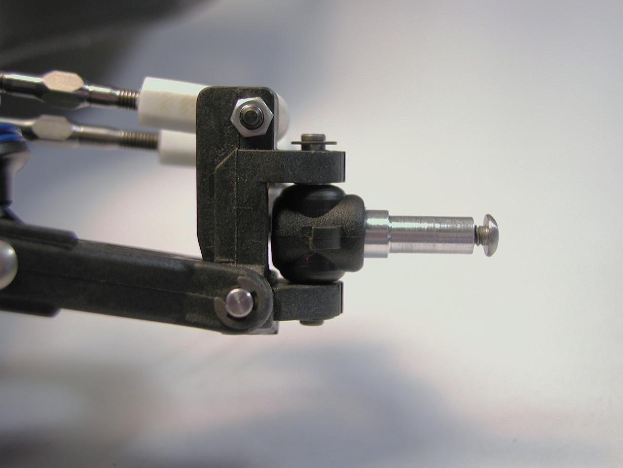

The next item, was to turn some extended axles to bring the car out to max legal width in the front. They are extended about 3mm per side, which is perfect for the rims I am using.

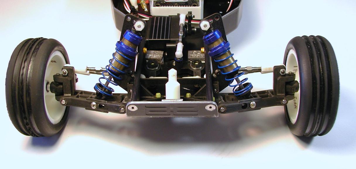

And finally is the finished (for now) front end. In the pics you can see the long axles, the preload adjustment (which was limited before) available via the new towers, and the revised camber link position above the std. team car/worlds hole.
