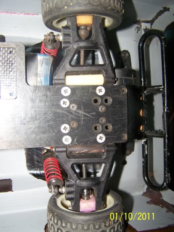

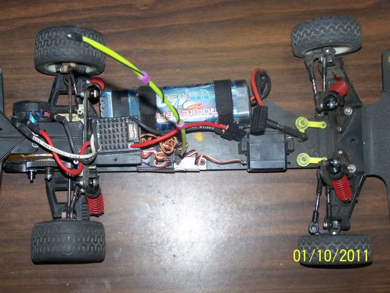

Re: Brushless RC10 buggy/oval
what are the toe and camber settings?........I do not know I do not have a gauge to measure that.
The cross weight feels good in my opinion
I will certainly loosen the diff before my next run. Had snow this week so I didn't get to the track.
Also I do not have enough wire on the esc to relocate further forward the best I could do would be to lower it.

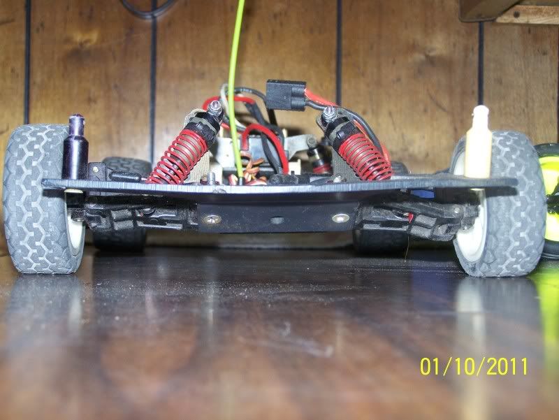

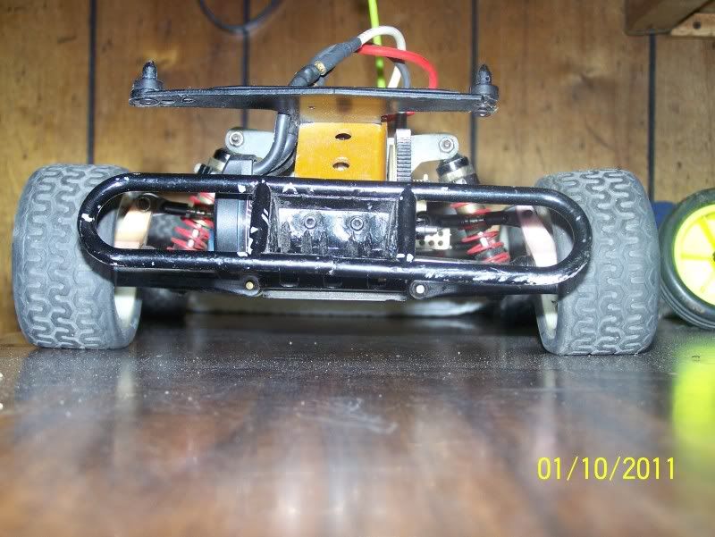

Ok the rear has no droop and and yes the front shocks are in different holes but it 3wheels if not like they are. . There is no spacers on any wheel how ever none of them rub I am not using CW wheels either I have a set of Assoc. wheels on it. Duratrx flanged bearings out front.
This is as straight as I could get. If you need others lemme know.

Okay, you need to get droop travel in all the corners of the car, not having any basically means that as the car goes over any bump the front or back of the car is going to skip around and not follow the terrain of the track, even if the track is very smooth there is still enough change to upset the car. With that said I think we've discovered a fundamental problem with your car that needs to be fixed. seeing as your spring collars are all the way up you can't soften the suspension with those springs any more, you either need to: go to a softer spring and a lower ride height, or: a longer shock with a taller tower, or: a shorter spring.
What springs are on your car now?????
I always ran .71 bodies in the rear and .56 bodies in the front with .56 shafts all around for what it's worth. I think you're should be able to make what you have work though.
those are 3* rear arm mounts and 0* hub carriers by the way.
If I can make a 74 monte win a race with a rookie driver and a junk yard motor I can work with this.
Anyhow I do not know what springs are there. The fronts are like truck springs squeezed on to tc3 shocks and the rears I guess are tc3. So honestly I do not know.
"those are 3* rear arm mounts and 0* hub carriers by the way." Thank You for the info here.
go to a softer spring and a lower ride height, I cannot do this out back man, I am already bottoming out in places as it is. I'm not trying to be an ass or go contradict what you said, but I don't want to trash my chassis either.
My biggest deal with this car and racing now is that so much crap has changed and I used to be so good with nitro that I do not want to make a legit series race and end up looking like a fool because the car I have wont work. If I look like a fool I want it to be because of my driving and not the car. I will make the changes and adjusments that you listed tomorrow. With the snow then freeze and no sand on the roads yet I am not even going to attempt to get out tomorrow.
