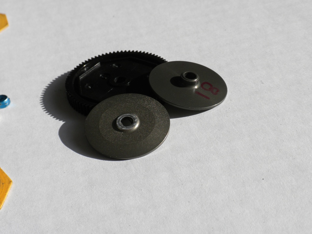

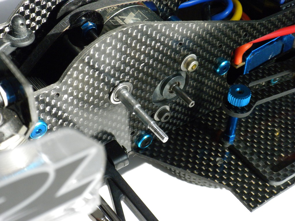

Here's a couple pics of the slipper. It's a B4 assemble that has the inner hub milled to move the spur gear closer to the chassis. It fits over the main shaft, which was turned from a solid piece of pulley stock. Again, thanks to bigjeepz for all the help on the machine work!!!!

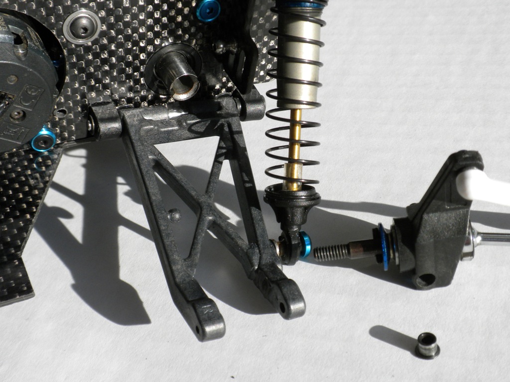

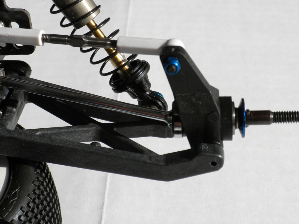

Here's a couple shots of the rear arms and carriers. You can see the outer brace was removed on the arm and the hinge pin hole was enlarged in the carrier to allow the metal sleeves. The sleeves make it possible for me to use the standard B4 outer hinge pin. I wanted to stay with that design because the pin is captured.

Jeff the car turned out great. Thanks for ginving me the chance to work on some of the parts. I will be waiting to hear what the first drive is like.
One of the changes as well was going with the 5 x 9mm bearings for the slipper shaft. The 4 x 9mm bearing was too small to allow the entire shaft to be mounted in the car.
