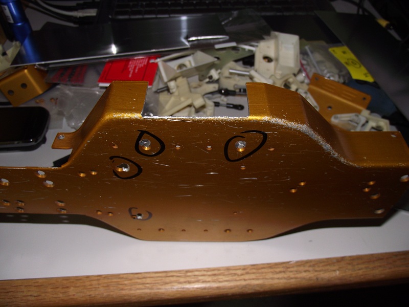

As I've mentioned previously, at one point someone decided to modify the chassis, possibly for running a recent battery pack, and that requires repair. I found some nice aluminum sheets of the proper thickness at the LHS. I've never brazed aluminum before so this will be a learning experience. I'll also attempt to fill in the extra drilled holes.

Yeah I can't wait to see the outcome of this. My buddy owns a shop that works with aluminum and I was thinking of taking some pans over to see if he can weld up the extra holes. He happens to own a powder coating shop as well which I think will come in handy.

Did you guys know that the difference between a 'brazing flame' and a 'cutting flame' is only a 1/4 inch according to the 'mnual' that came with my setup?

Did you guys know that a 'cutting' flame will melt an RC10 chassis where you direct the heat?
700 degrees my a$$
700 degrees my a$$

I'd personally silver solder it. It's all technique but it is strong and doesn't need to get near as hot as what you are trying. Just use a very good flux.
