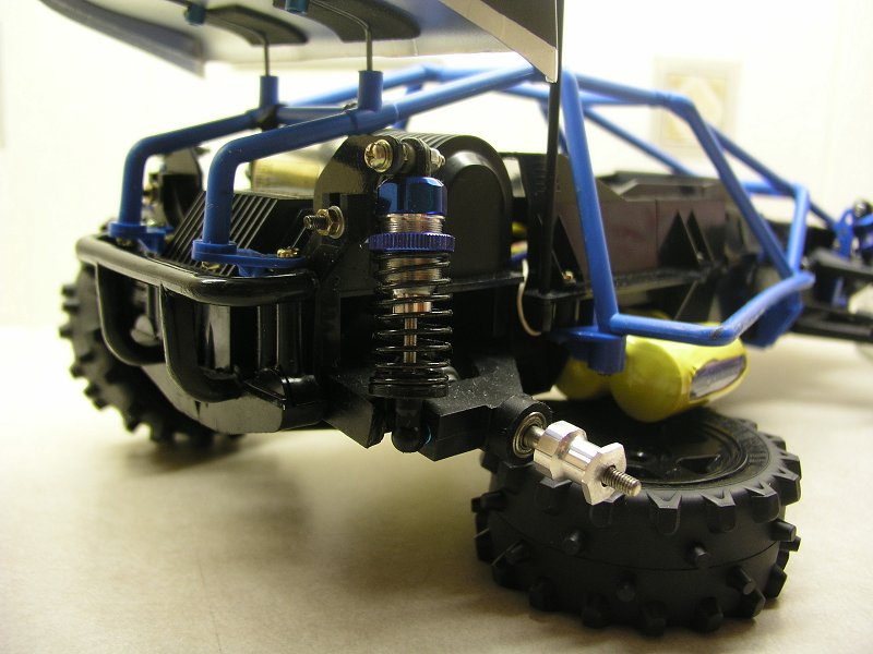

On the rear wheels, did you leave the tamiya hub off to mount the wheels?
The wheels are mounted using a optional hex adaptor - pretty much similar to the one Tamiya offers as an option for the FROG. Let me know if you need a pic/part no. :)
Thinking of trying to fit a ball bearing into the rear suspension setup to eliminate the friction... I heard it's been done before - anyone have any references of such a setup?
Do post pics of your steering setup when done... I'd love to see your take on it. :)
Pics of the rear adapters would be great. I already bookmarked this thread. :lol:
I have a few projects ahead of the blackfoots and frog, but I will definiately post pics when I'm done.
Tamiya #53913
Hope that helps. :)

Cool set up. What ball joint did you use to attach to the steering knuckles? The Frog and the Sand Scorcher have the same steering arms right? I want to put some stronger turnbuckles on my Scorcher, but I'm not sure how to mount a regular ball end to the knuckle. The stock ball joint seems to be 2.5 or some odd size.

Tamiya #53913
Hope that helps. :)
oh those look good. Thanks

Those also work great to mount modern 12mm hex wheels on the rear of a Marui Galaxy or Hunter, too. They just need to be shaved down a tad.

MelvinsArmy wrote:Cool set up. What ball joint did you use to attach to the steering knuckles? The Frog and the Sand Scorcher have the same steering arms right? I want to put some stronger turnbuckles on my Scorcher, but I'm not sure how to mount a regular ball end to the knuckle. The stock ball joint seems to be 2.5 or some odd size.
Sorry I missed this post...
I'm actually using the standard ball on the knuckle with the white rodend. I drilled out the rodend to 2.5mm and then threaded the 3mm turnbuckle into it.
Tamiya does have some 5mm balls with a very narrow threaded portion (I have some in my F104 knuckles) but I'm not sure of the part number. I think those would probably be perfect for this particular job.
