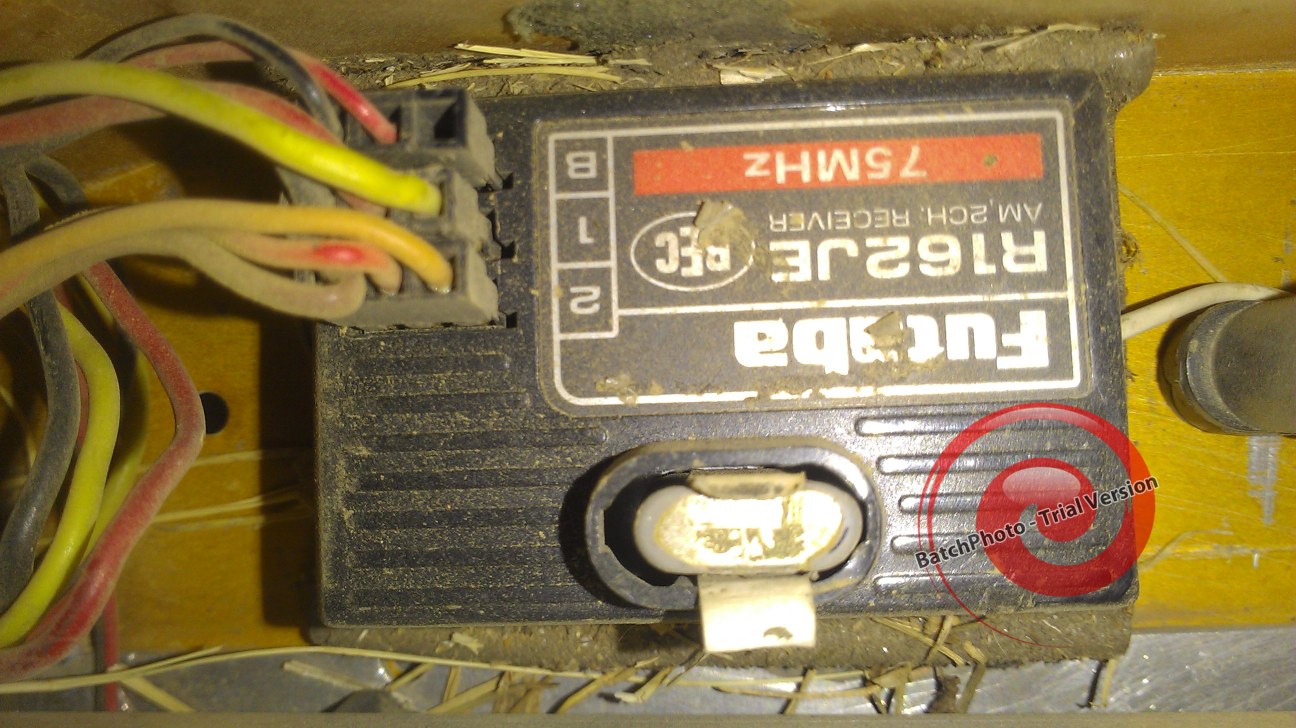

I see some big problems here. Your radio for one thing - if it randomly glitches and doesn't work, yeah, you're going to hit things. Next, you really need modern rubber and spiked or pin tires won't do squat on pavement. Most new tire compounds will work fine even in grass because they are softer.

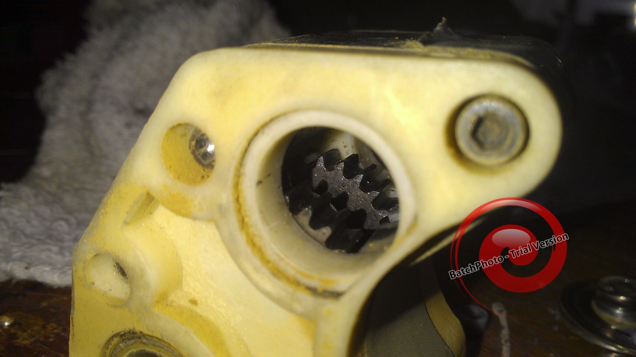

To avoid making excuses, I was trying to replace them with my video because then i could explain what everyone was seeing rather than typing it. The video is 22 minutes so YouTube wouldn't take it. Then Google videos wouldn't tame it and froze my computer. I finally settles on Dailymotion to upload it to and I'm waiting on that.
Re: A very heavy goldpan...
Oh yeah and doea the compound if the bearing matter? Is it really better to get ceramic bearings over steel?

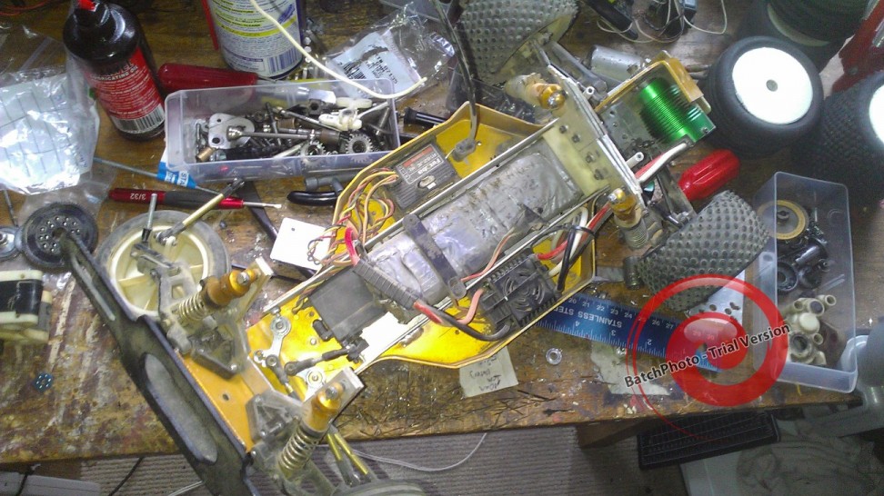

dave, we don't need a video, body off pics would be better. you've described what it's doing well enough.
take some body off shots and maybe a 2 minute video if you want.
the siezed bearings are most likely the major contributor for your issue.
you don't need ceramic bearings, just get the regular metal ones, if you get avid's get their "revolutions" if available in you size.
they have a rubber shield on one side (the side you put out towards the dirt) and a metal shield on the inside. can't beat a buck a peice.

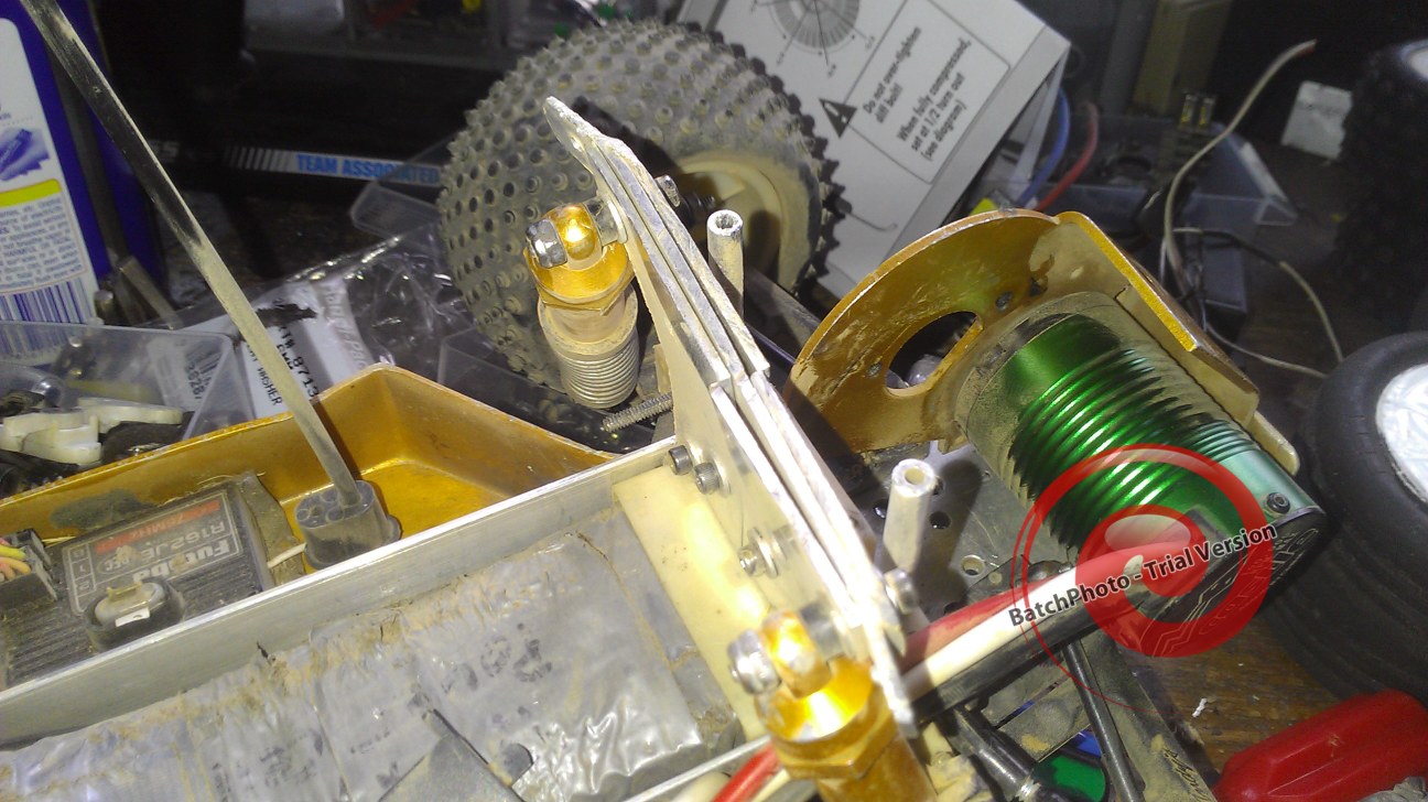

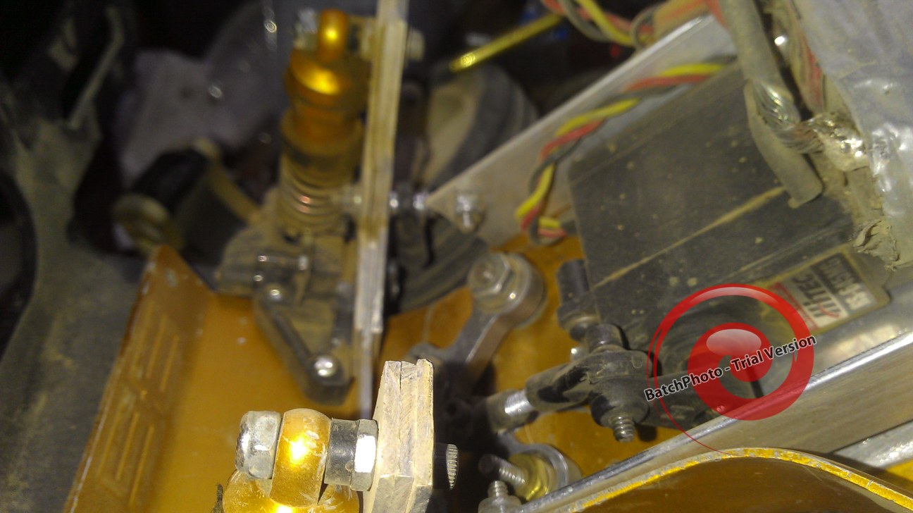

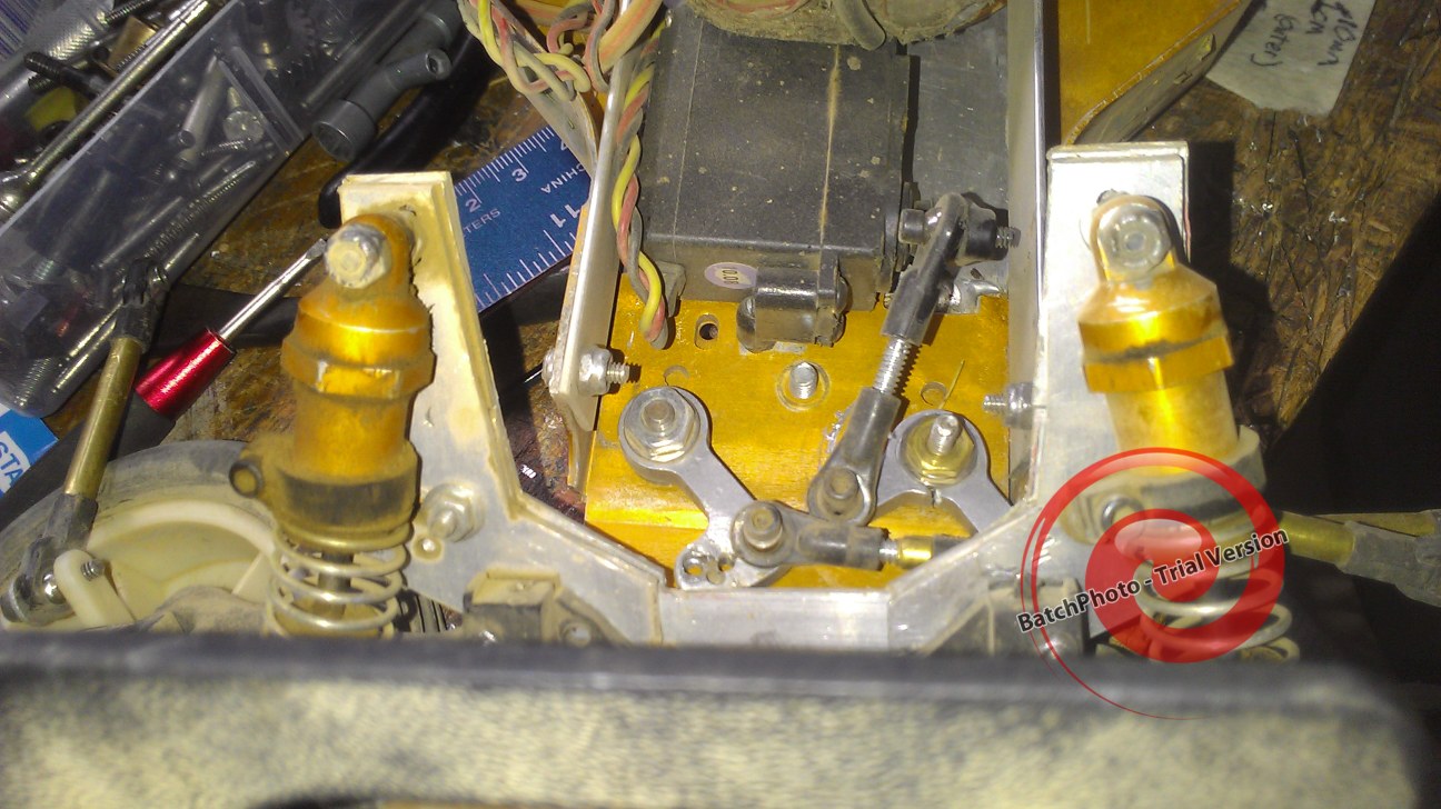

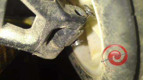

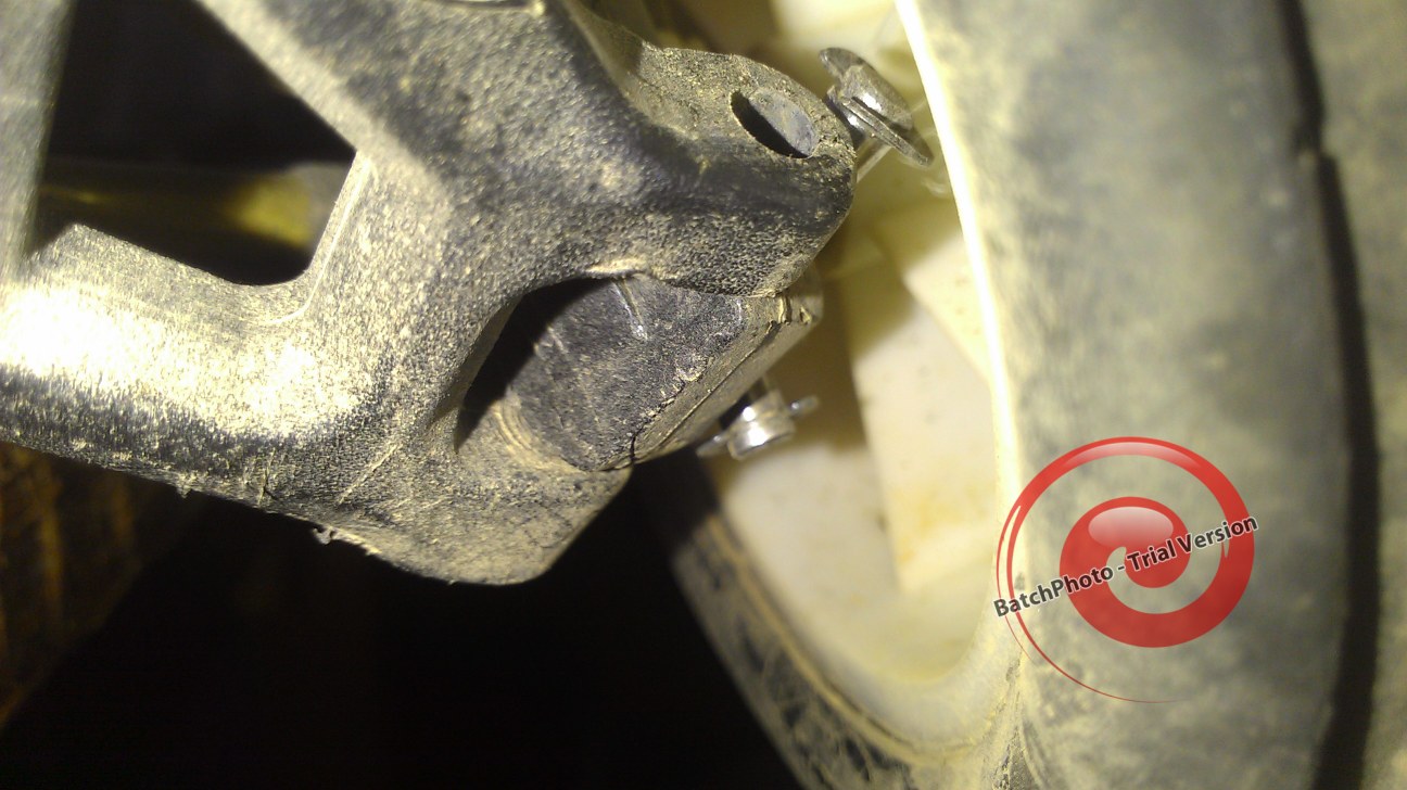

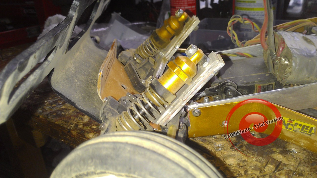

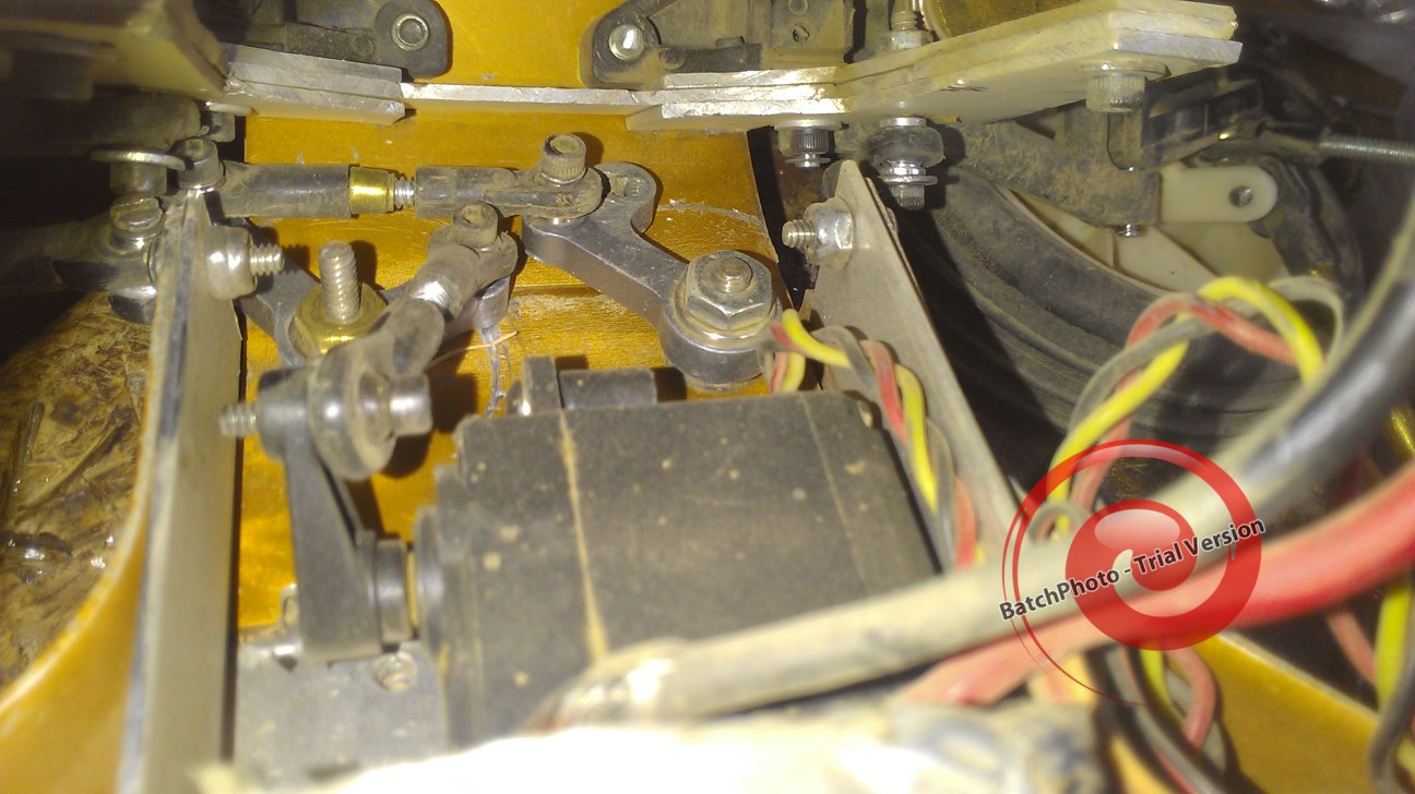

ok here are the pics of the car. Mind the watermark, it came with the trial program i had to use to shrink the images.
Finally... Dave145's Gold Pan Runner Build
I guess it's about time I do this considering how often I'm on here and how often I need to post pictures of my mangled car so I've decided to start fresh with some new parts, my manual, and a "bang head here" sign (you know there's nothing like discovering the previous owner of your car/part stripped the hole
). Anyway I'll post up pics of it in all its various stages, and hopefully get it running again. Here's what it looks like now.

The ones that are flat on the pan are. I had a machine shop make them and weld them on when my chassis cracked.
ouch....
i would keep whatever is still usable, then take the rest out back and shoot it.
