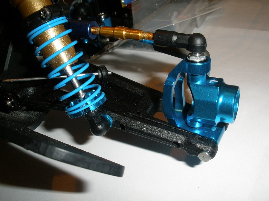

ron wrote:Those anodized blue rod ends are from HOR racing in HK. $3.20 a pair, I think. $5 flat shipping cost no matter how many pairs you order, so I got 12 (6 pairs). They function great, but I would say are less stronger than standard 3mm plastic rod ends, they would fail under extreme condition like crashes and stuff, very SCALE looking, no I think its in blue only, and silver. The description will be wrong, they will say the thread size is 2mm and ball hole is 3mm, actually its 2mm all around.
Man, that's too bad, I was also going to ask you about those alloy ball-ends, they look awesome, until you said they're 2mm. Indeed, they wouldn't be too durable. If they were 3mm threads with something in the neighborhood of 5mm captured balls, I'd be buying me a whole wack of those for $3.20 a pair. :?

Don't worry Coelacanth, its also available in 3mm standard, with 3mm ball hole diameter and 3mm thread diameter. check out HOR racing site, and I think its $3.64 or something for the pair 8). The 2mm ones pretty solid built, but for all of them, the rod end is AL, ball is steel and the bushing around the ball that hold it in the rod end frame is aluminum, unlike the $30 pair that have brass. Well if you want a diff one, go visit RC channel, they have beautifully rod ends too, at $2 one, it has the brass bushing holding the ball in place, but the ball is a little loose within the socket of the rod end, around 0.3mm or so. But try the HOR 3mm one, its great looking. Yeah get a link that has reverse or opposite threads on both ends, plastic rod ends can easily adapt to the threads.
Userunrelated -nice looking washers :D Yeah why not put a little bling into the buggy! It'll look great. I have been meaning to point out the orientation of the head on the engine, turn it 90 degree in either direction so that the fines are parallel with the length of the body, you will have air flowing in between the fins for a more effective cooling :mrgreen:
