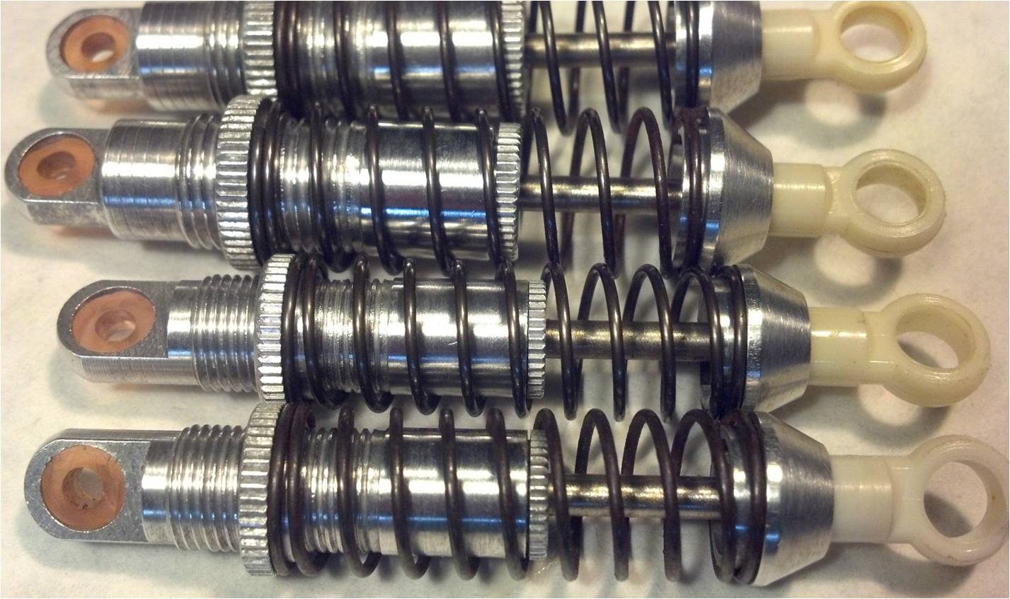

Got a front shock solution. I know the rears will be Kyosho Big Red's, but it the front I wanted something period correct, and rebuildable/functional/tunable, as this is a runner, and (a potential classic class
) racer.
I found these, intended for the front of an AYK Bison (Super Trail), an early 1980's, SRB-esque pot metal monster. The neat thing is that they are threaded and easy to mess with. I just had to lose the You-G like adjustable piston. and just lathe my own down to about 8mm, a bore I'm not used to seeing. And the springs they came with are a bit stiff. I had some cut up old green-gold ones that feel ok at this point.
Here are the instructions, for giggles. I know later on Paranoia got into diffs and gears and stuff, but these are something I've never seen, so I figured why not. Love the "use any commercially available motor oil", and the brass hardware. Takes me back...

LOVE the vintage Paranoia dampers
I dd know there was any after market or upgrades to the ayk, then again I don't know much about the ayks. I like the dampers design, the brass screw cap from the bottom and the screw tensioning of the springs. These look very scale like indeed. Would love to see how they look. Do you have only one set, for the front? What about the back?
these are what I got a few months back from ebay. These are ishipla monster shocks, same dimensions as the kyosho shocks but the bottom spring retainer is aluminum and its got threaded spring adjuster.

Just had one on ebay. I knew I needed the front (shorter shaft) version anyway.ron wrote:LOVE the vintage Paranoia dampersI dd know there was any after market or upgrades to the ayk, then again I don't know much about the ayks. I like the dampers design, the brass screw cap from the bottom and the screw tensioning of the springs. These look very scale like indeed. Would love to see how they look. Do you have only one set, for the front? What about the back?..
The back of this cars going to a pair of the red Kyosho CB88's. I did figure out how to re-build them too, so I'm set.

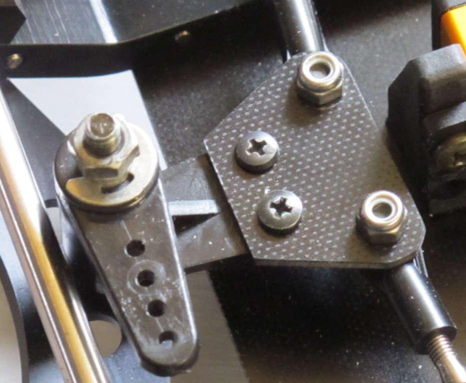

Got the front end mocked up last night. I want to run this, and want to be able to control it, so I could resist re-fabing the servo saver in anticipation of a mg servo. Glued the plastic, trimmed, glued and drilled some black frp onto the arms, drilled it out to accept 3/16x3/8 bearings. With a 3/16 brass tube sleave around a new mounting screw, I got a firm steering setup that has a little better clearance, angle and ackerman imo:
Oh and btw, some of you have probably noticed the odd way the RCH rear tower accepts the rear cage, requiring that it be bent at an odd angle. I don't think I'm going to accept that fit and will be drilling my own holes

I have done the same update on my steering and it works grate and I got rid of the entire bump steer.

I guess grate (actually it would be great
) minds think alike Lars. That's good to hear!

If you have enough room for those mods, I wonder if you could just screw on a steel or carbon plate, attaching it at the center hole at the front and those 2 mounting holes I see on the underside of the black plastic shell, then drill 2 holes in the plate and mount a typical ball-raced bellcrank like the A & L or the alloy kind I fit onto my Optima Mid project? 3 mounting points instead of 1 would lend greater durability for sure, but I have no idea on the clearance. If someone wants to donate me a Scorpion, I'll find a way.
Nice mods by both of you, by the way.

Hcp22 wrote:I have done the same update on my steering and it works grate and I got rid of the entire bump steer.
You've yet to show us any of that Tomahawk right? Holding out for a Vonats surprise are ya? That steering and this are all I've seen of it I think..
