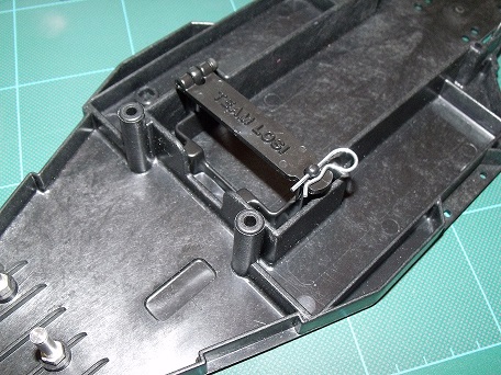

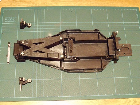

Progress so far....which is in fact not much due to lack of parts that I want to use. However, that should be rectified soon with shipments due in from Wheelspin Models and OLDRC!
Steering posts in...
Losi Jr.2 009.jpg (110.02 KiB) Viewed 2788 times
Battery clip.
Losi Jr.2 019.jpg (120.82 KiB) Viewed 2788 times
Battery clip.
Battery clip.

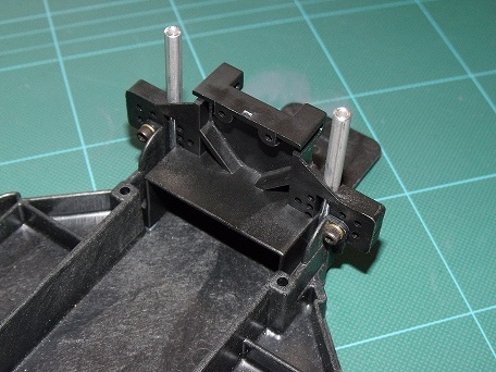

Rear bulkhead.
Losi Jr.2 027.jpg (105.7 KiB) Viewed 2788 times
Rear bulkhead.
Rear bulkhead.

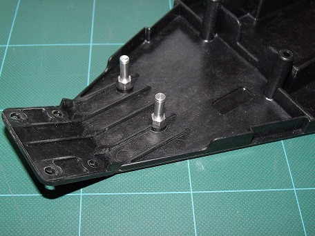

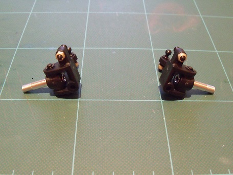

Front axles.
Losi Jr.2 042.jpg (88.5 KiB) Viewed 2788 times
Front axles.
Front axles.

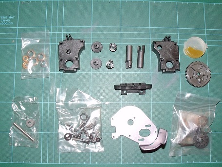

The contents of Bag "C"
Losi Jr.2 051.jpg (117.69 KiB) Viewed 2788 times

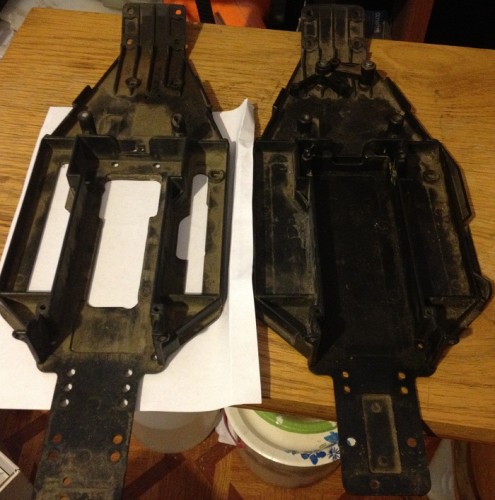

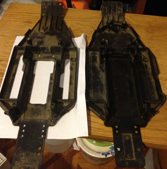

The junior 2 uses a different chassis than the pro se/lxt. The junior chassis is the same dimensions as the jrx pro but molded instead of a flat plate.
"It is not how you finish but how you qualify unless you qualify bad then it is how you finish."
Words of wisdom from the Cox bros at my local track.
clm
Posts: 942
Location: Oregon Coast
Has thanked: 100 times
Been thanked: 205 times
Re: NIB Losi Jr. 2 (New build)
Post by clm »

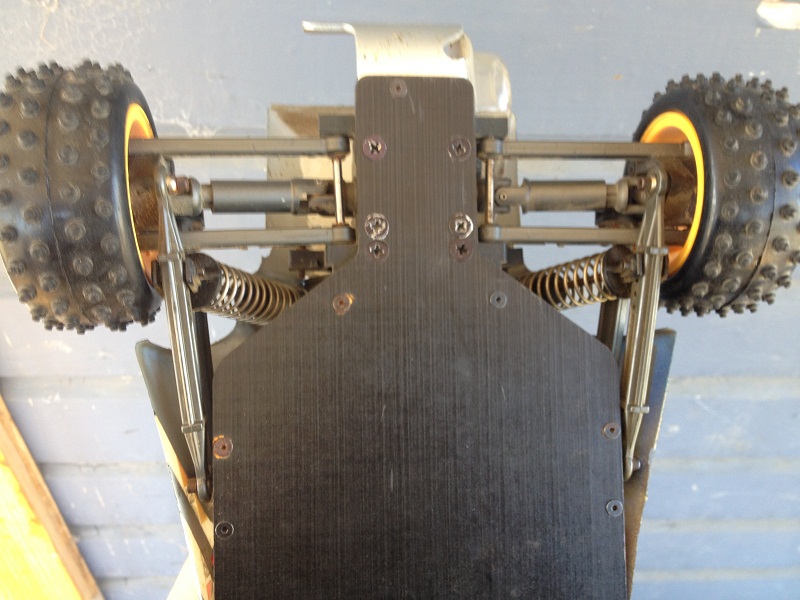

The junior chassis is very very close to the se/lxt chassis actually, the outer edge is removed, a few more holes for wheelbase adjustment are added, and the tail of the chassis is lengthened a bit also for wheelbase adjustment. They also milled out under the battery and in the sidepods.
(paper used to hide one of the side sections of the junior chassis.)
That being said, you could easily make a graphite chassis pro-se by removing that much off the sides of the pro/jrxt chassis or transform a junior chassis into a pro-se chassis by cutting that same amount off
I also think a junior 2 body should work with just a little work with the 5 link, while the jrx2 body does flare out a bit over the links, the links do stay in fairly tight to the chassis.

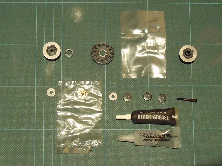

AE diff lube and black grease.... :oops: ....grease is grease, right?
Preparing to build the diff...
Losi Jr.2 Update 003c.jpg (115.08 KiB) Viewed 2676 times

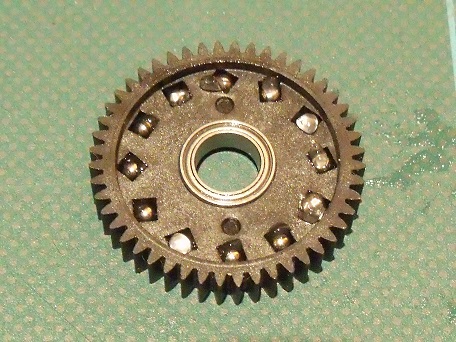

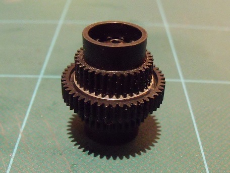

This is the later diff centre gear with bearing and diff balls in place. However, after trying to get the diff to operate correctly, I had to revert back to the standard centre gear. The two 1/4" x 3/8" bearings that I used must be the wrong thickness because all that happened was the diff would not function as a diff should, it just seemed to bind up. Any ideas???
The bearing diff gear.
Losi Jr.2 Update 009c.jpg (123.46 KiB) Viewed 2676 times
Completed LRM diff using the standard centre gear - just waiting on the bearings.

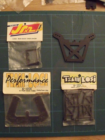

Some new parts from Sabulatech.....plus one from eBay.
Some new parts arrived.
Losi Jr.2 Update 001.JPG (116.33 KiB) Viewed 2675 times

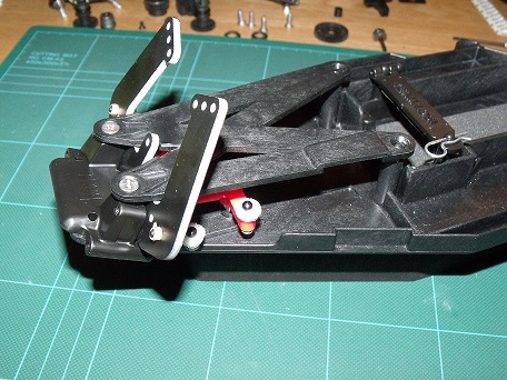

The GF Pro-SE front shock tower installed to allow the use of the shorter front shocks. The standard Jr.2 shock tower is way too... flexible!
Front shock tower installed.
Losi Jr.2 Update 014.JPG (119.34 KiB) Viewed 2675 times
I'm hoping that the Pro-SE rear shock tower will accommodate the Jr.2 body without any cutting/ trimming issues.

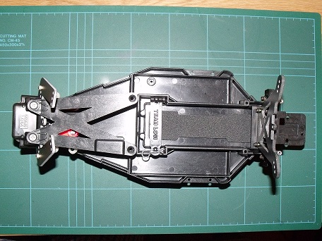

Aerial view.
Losi Jr.2 Update 020.JPG (116.06 KiB) Viewed 2673 times
Aerial view.
Aerial view.

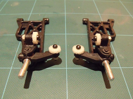

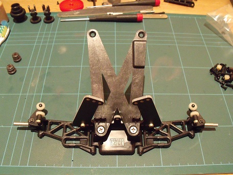

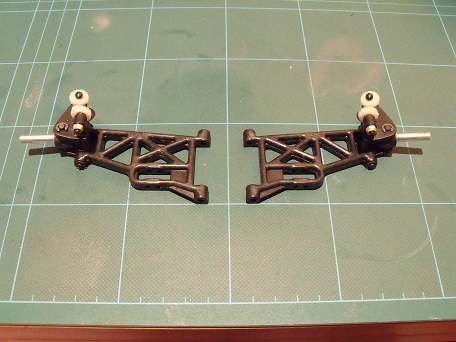

I opted for the later swept A-arms as they do not flex!
Swept A-arms, part # A-1013
Losi Jr.2 Update 024c.jpg (104.94 KiB) Viewed 2676 times
Foam thingy's in place!
Losi Jr.2 Update 028c.jpg (102.48 KiB) Viewed 2676 times
The Pro-SE swept A-arms are made of a composite material unlike the standard nylon(?) arms that came with the kit.
Arms installed - minus shocks and tie-rods.
Losi Jr.2 Update 029c.jpg (111.49 KiB) Viewed 2676 times

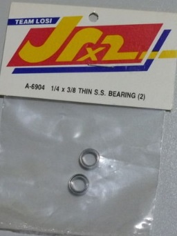

Just waiting on some more bearings so that I can finish off the gear-box.
Posts: 12336
Been thanked: 3917 times
I seem to recall those center bearings being a "thin" bearing....let me see what I can dig up
Looking great by the way!

Yes the Junior body will work fine with those towers. I have one that I used on my Pro SE many years ago.
http://www.vintagelosi.com/JRXPROSE.html#9
