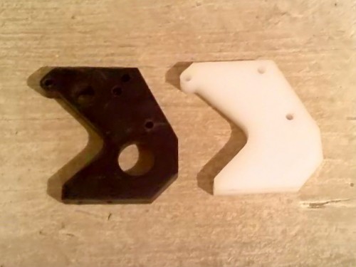

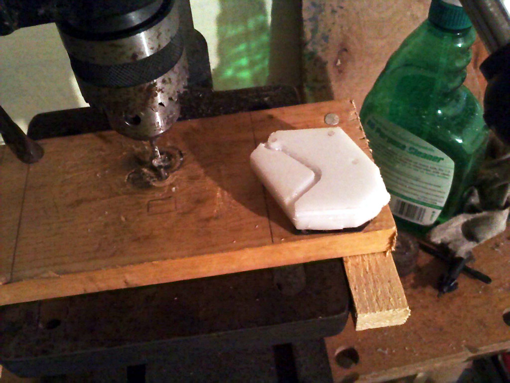

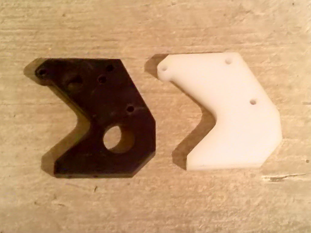

Picked up a TPS chain drive a month or two ago that I want to use on one of these truck builds but the plastic bits are beat up and dyed, and would just ugly up the rest of the new parts on these cars. So I decided to try and make new side pieces for it out of delrin.
Don't have a CNC so using my drill press I took the same basic approach that gomachv does with his pin router and used the old side pod as a template.
Because of the thickness it required several passes, lowering the bit a little each time. Not the quickest method so only got one side mostly complete. I'm happy with it though.

Re: Ruff 'n Tuff
Copy cat!
What bit are you using? I tried using my carbide bit that I use on g10 on some 6-6 nylon and...let's just say "it wasn't pretty"
That looks pretty nice!

Re: Ruff 'n Tuff
Imitation is the highest form of flattery.
Just used a Dremel 1/8" square high speed cutter from the Home Depot. Cut smooth and easy as long as I only took off a mm or two of material on each pass.

Re: Ruff 'n Tuff
The problem I was having was melting, it would cut really well like butter… And then it would melt back together LOL
I had my router turn down as far as it would go,

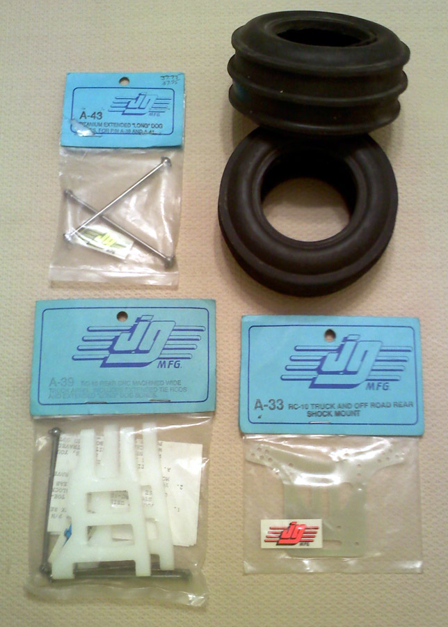

Got a few NIP parts for my JG SRT.
Big thanks to Spydur23 and aip47-2008 for helping me out with the rear tower and dog bones.
Really psyched to have found a set of rear arms. I was thinking about doing a Race Master Trailing link rear suspension to give the build a trophy truck look but the original arms are much better since I won't have to add extra holes in the chassis.
Unfortunately this now means that the B2 carpet arms up front aren't going to cut it and I'll have to keep an eye out for JG fronts.

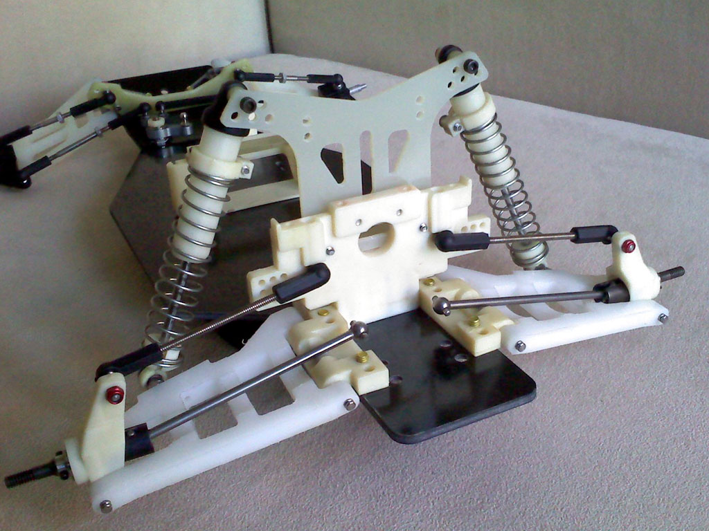

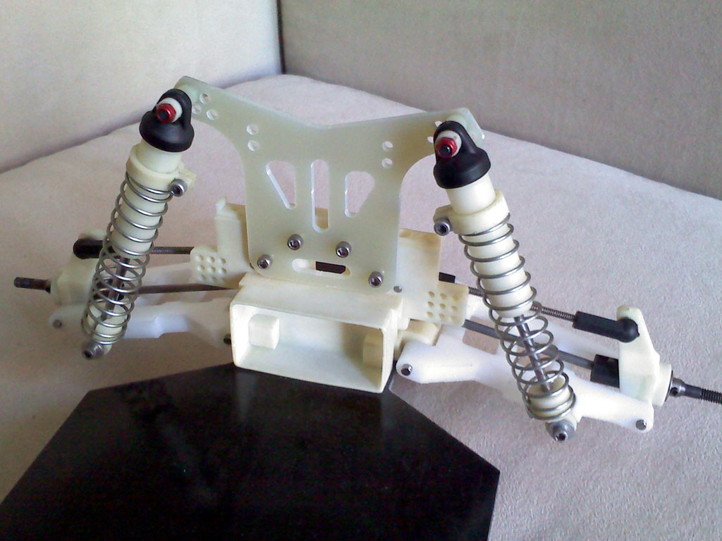

Re: Ruff 'n Tuff
Thanks again.spydur23 wrote:great home for that nip tower, rather than my bastard buggy! Looking good!
Got the rear suspension put together.
