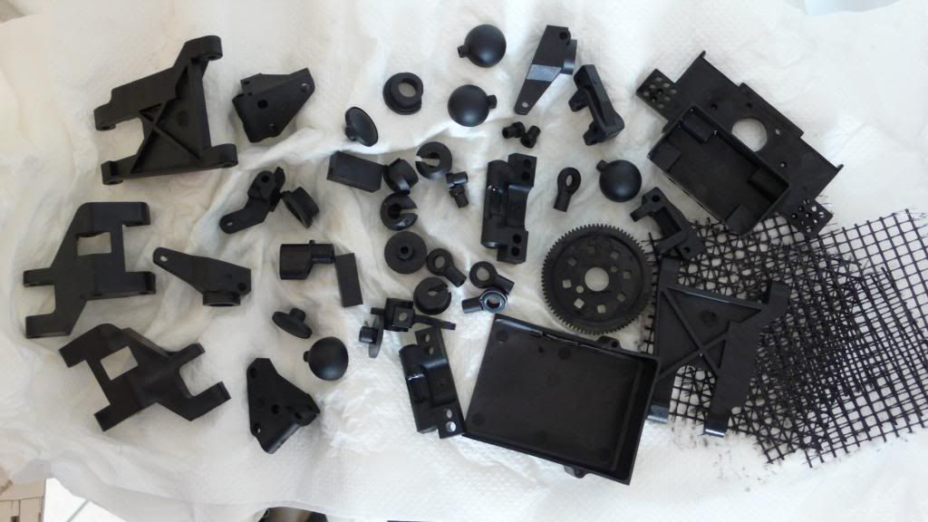

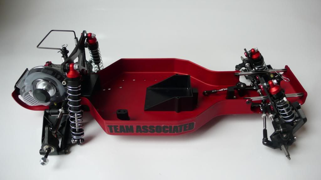

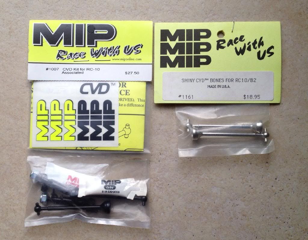

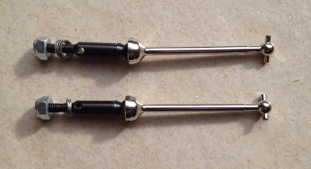

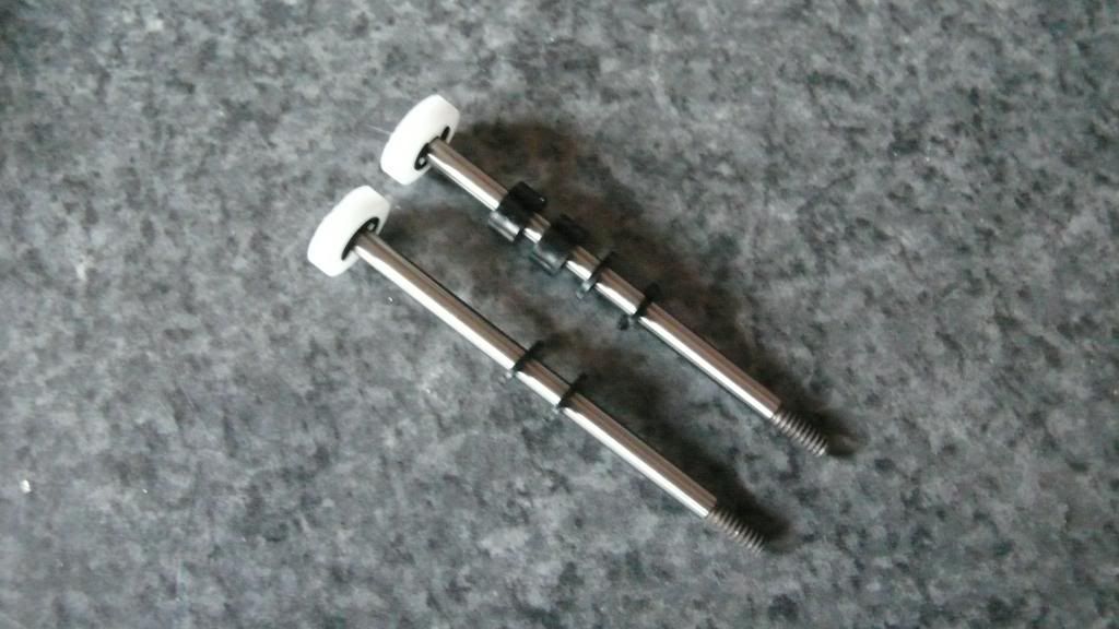

Thanks guys, I'm really looking forward to building it. I think I will dye all the parts black. I also thought about leaving the arms, ball cups (I'll use Yokomo ones) and shock parts white and the rest black. Still undecided... The REC wheels will most probably stay bare aluminium. Today I built a pair of CVD's that were never offered as a kit and will fit the theme nicely I think:

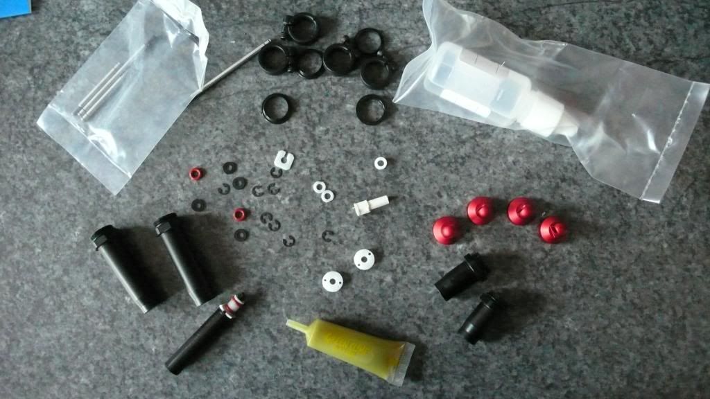

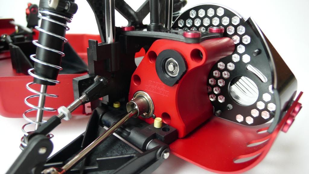

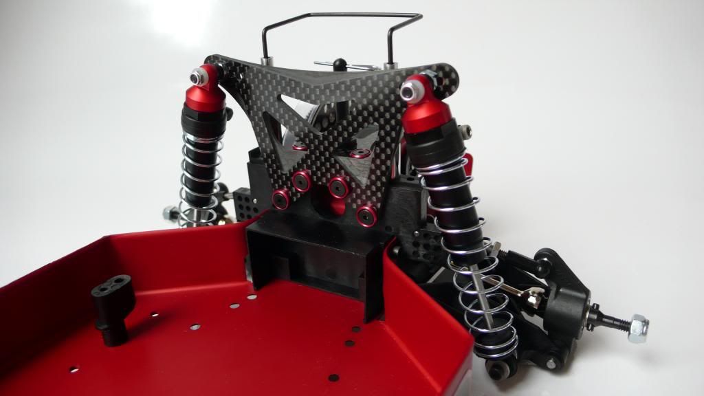

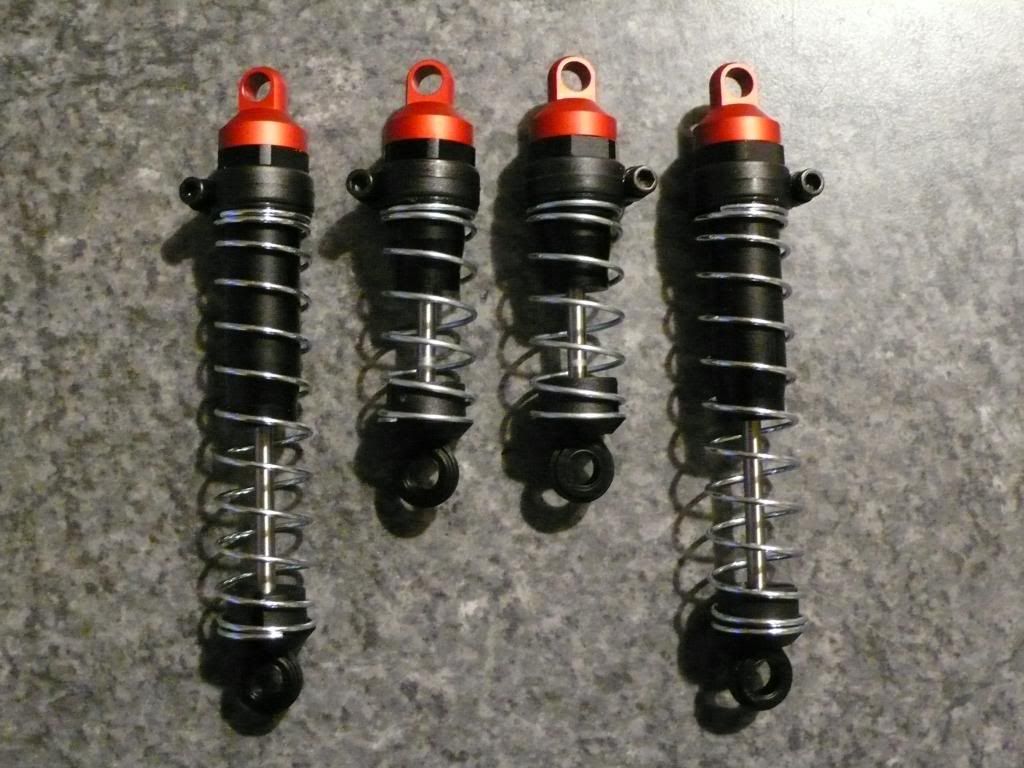

Spent some time on it during the weekend: after an unsuccessful dye bath with a Dylon dye that turned the parts into an awful light blue/grey when it was supposed to be black, I ordered some good ol' Rit Dye on the web as it is not available here in shops and after 30' the parts eventually came out pitch dark.
I also spent some time on the shocks, two extra spacers were added to each rear shock and they could probably even get a third one but then removing the two super thin ones included in the kit. The infamous Green Slime was of course used throughout all four shocks. Pityfully enough I lost one of the shock collars (why didn't they include a lip on these collars or at least a centering collar?) and had to go through my stash to find an alternative, I ended up with four DS/B2 era black shock collars which will do the job nicely. What is nice about this kit is that you don't have to worry about period correctness
Today I will order some black yokomo rod ends as I don't feel like dying old perfect white ones along with hardware to fabricate the front and rear sway bars
Next step is to start building that awesome tranny from REC! Sorry for the crappy night pics. Stay tuned...

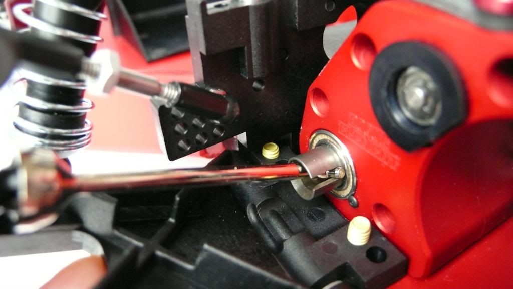

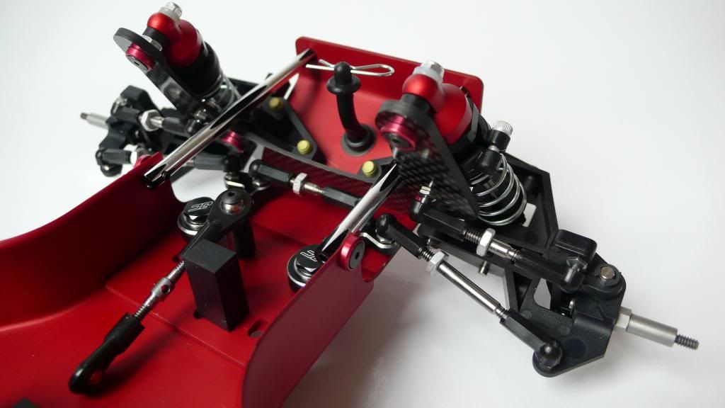

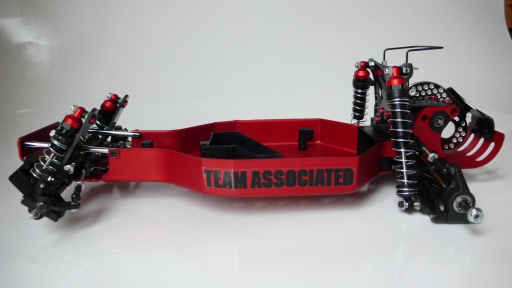

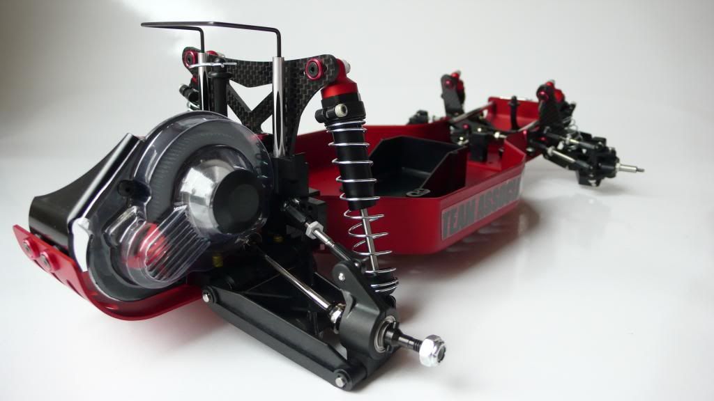

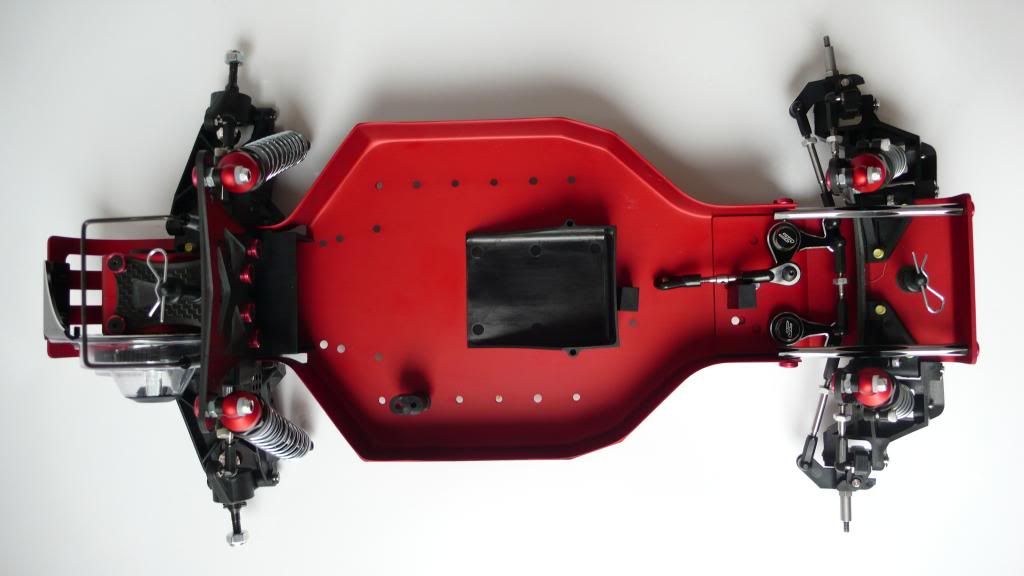

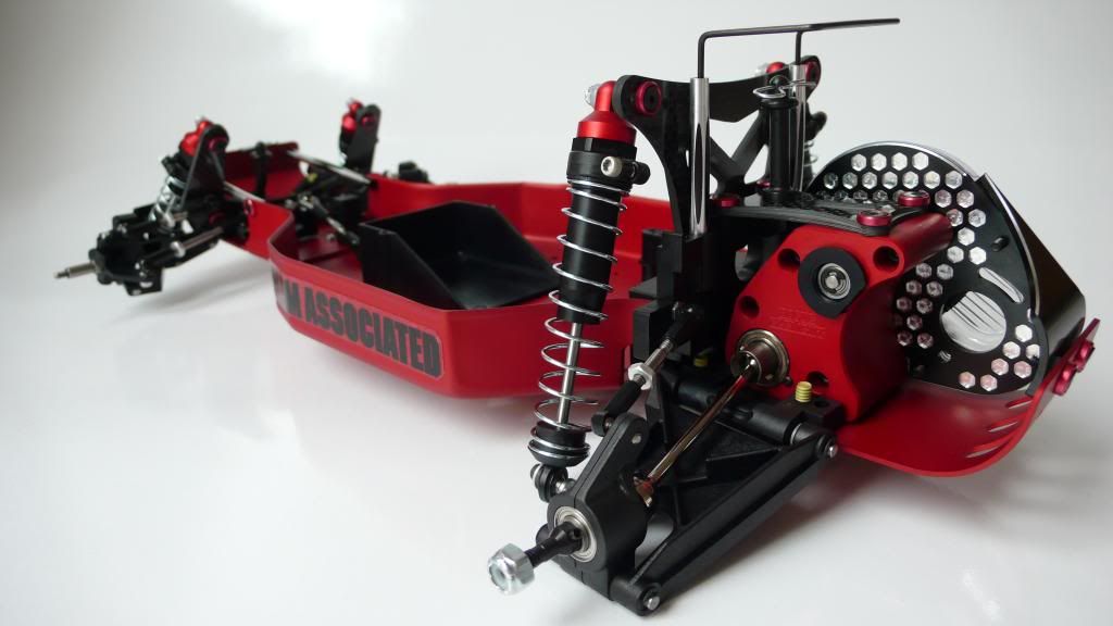

So true, but I guess it's human, when resources are scarce you tend to try to save them, and when it pours you tend to use them at will. For me the Classic was a real opportunity to try different things I never dared to do before with a genuine vintage example but always wanted to. I really felt more free in terms of imagination and cutomising methods, not even mentioning period correctness. And I think this also shows in the other Classic builds on this forum, it really boosted creativity IMO. On top, I really wanted to give a real tribute to this legendary kit and tried to offer her the best clothes availableflipwils11 wrote:So ironic, now that we have re-re and a supply of white parts, everyone is fine with going the dye route!
Anyway, back to the build, my wife is away for a few days and I spent the whole evening (and part of the night
While waiting for the re-re World's rear hubs to be available, I played with some RPM GT rear hubs but they will unfortunately not do the trick as they slightly narrow the rear track width and cause some binding issues when shocks are fully compressed. Too bad as they are looking good on there.
I also had to use one plastic shim between the rear a-arms and their respective mounts as I experienced too much play at that spot.
I am now patiently waiting for the REC wheels to arrive and I also ordered a Keil/Yokomo front/rear sway bar kit that I plan to modify and adapt to the car. It has some nice red anodised alloy bits that will look da bizz on there
