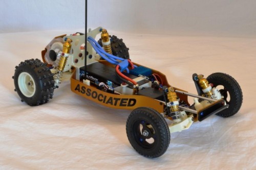

I still have a visually noticeable amount of toe-in. I think I'm going to correct it some more. Toe-in is better than toe-out, but I'd prefer almost zero.GodSpeed wrote:I also removed some toe-in which was a result of the measurements from the manual.
Here's a picture of the fronts. There's ~6.75mm between the spring collar and hex on the shock body. It's about as far as you can go before the shock body starts to taper --
On the rear, there's 6.5mm on the left side and 5.5mm on the right. The difference is to compensate for the motor overhang, as I mentioned, and it sits perfectly level.

I'd love to measure my ride height for you but yesterday the car suffered its first accident. Broke the front right side arm mount doing about 3-4 cartwheels. #6208 on order. Should be here Thursday....or Friday because today is a national holiday.85Edinger wrote:What is your front ride height? Maybe you should try dropping it a little.
Sure enough it was me driving and not either of my 4 & 6yr old sons. Nice driving, dad. My wife also hit a tree (1 of 3 in a field the size of a football field) DEAD-ON. Lucky. It would have torn the whole side of the car off had she not hit it so square. No damage whatsoever as a result.
So regarding right height, I don't know the measurement but the tie rods sit almost perfectly parallel to the ground IIRC. I'm concerned that if I lower it by raising the spring collar, I'll lose rebound. Overall ride height is higher now with the JC Racing 5-spokes vs. the original wheels.
How about I try adding more camber?
I also need to remove some toe-in still. I'll do that when I get the bell crank steering installed.

I had my classic out to the track with pretty much a stock setup. I found it handled quite well and I'm not going to change anything on it. I'll just work my way down the setup sheet.
Front:
Camber link hole position 1 (inner)on the tower
15deg caster
23.57mm front ride height
25.04mm rear ride height
JConcepts bell cranks
Jconcepts RC10 classic front graphite tower, using the lower hole
1deg camber on front tires with probably 1deg of toe in
Rear:
Camber link hole position 3 (upper most inner one)
0deg hub
Shock mounting hole C (second to the end)
long wheelbase
2deg camber
Shocks:
Silver springs all around
30wt oil all around
#1 pistons all around
Front shock collar 5.25mm from top
Rear shock collar 2.30mm from top
Rear inner limiters: 17mm
Stock wheels and tires
Electronics:
XP digital SC700-BL
Reedy 540-SL burshless motor
Futaba S3305 servo
Batteries, depends on what's charged. I ran Orion 2400 lipo which are light and I also ran a Reedy Wolfpack 5000 lipo, which was heavy and for the weight difference I think I prefer the lighter ones
Gearing:
stock spur and a 20 tooth pinion
Front:
15deg caster
Rear:
0deg hub
long wheelbase
2deg camber
Shocks:
30wt oil all around
Electronics:
XP digital SC700-BL
Futaba S3305 servo
Gearing:

Sounds very "by the book" except for the spring collars. Good to hear it's handling well on your track. What's the surface material?
I received the recommendation from more than one member here to move the rear lower shock mount to the very outside hole (D).
Where exactly on the chassis were do you measure ride height?
Would you mind taking a shot to show the angle of your front tie rods in relation to the ground?

First off, I forgot those front tires are definitely not stock. I also used bearings throughout.GodSpeed wrote:Sounds very "by the book" except for the spring collars. Good to hear it's handling well on your track. What's the surface material?
The track surface was predominantly hard packed dirt due to some unsettled weather that went through the previous couple of days. There were some loose spots too, which is usually how the track is.
I measured the rear ground clearance from the chassis to the ground at where the arms are mounted and I measured the front at where the nose tubes mounts, again from the chassis to the ground. I first dropped the car to get the stance.
I wasn't sure how to capture the tie rods relative to the ground, but hopefully these photos help.

Good pictures. Looks like the rods are slightly higher at the wheel end. But barely.
I'll measure once I get it back together. Might throw the original wheels on for some measurements too, mind you my rears are now bald (see -- http://www.rc10talk.com/viewtopic.php?p=395747#p395747 ) which alone takes off 1.8mm of ride height from brand new spec Champion tires.
