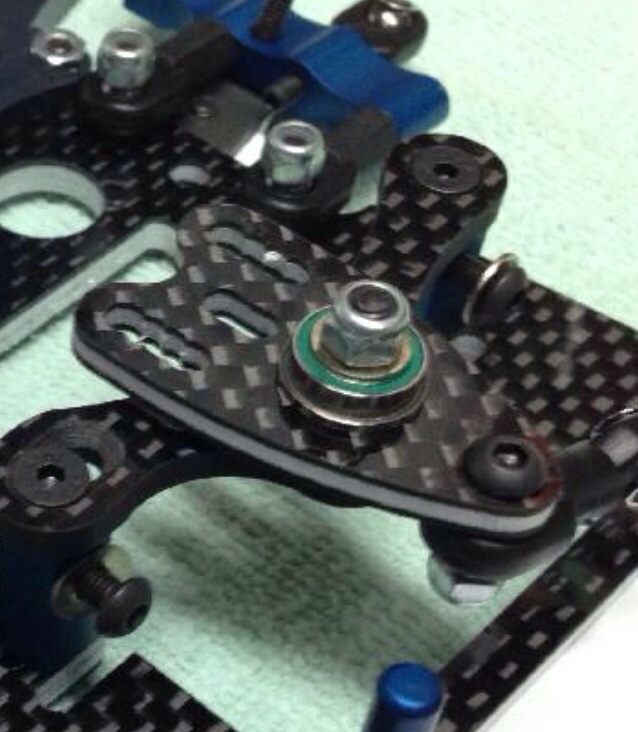

gomachv wrote:The other thing that flattening the nose out helped me with is steering clearance. Have you tried to mock up the bellcranks yet?
yes.... the bellcrank is another big challenge.... need to use a very thin one..... :(
Posts: 12335
Been thanked: 3917 times
Re: Project "RC10 Stealth 4" (June 8th, 2014 updated)
I learned a neat trick building the Tigermoth touring car :mrgreen: you can take a flat g10 plate, cut to fit, and drill for a bearing. Then, to keep it stable, add another flanged bearing upside down to secure it. Might be a easy method for a low profile ball bearing steering setup
