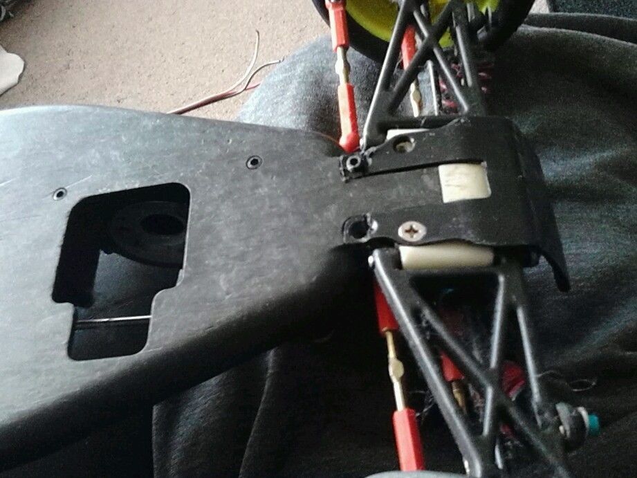

Any of you guys have an easy front bulkhead mod? I have read about the B2/3 hinge pin brace, but there seems to be limited room. I like the brace in this eBay kit, but don't want to buy the whole thing for one piece. http://www.ebay.com/itm/Li-polymer-Battery-Conversion-Ready-Kit-Parts-for-TLR-Team-Losi-XX4-/310738029798?pt=Radio_Control_Parts_Accessories&hash=item48596e0ce6
So what are my options?
Re: XX-4 restoration, road to the VONATS
to run the hinge pin brace fo a b2/3 had to file the arm down or something, other option was guys ran shock shafts and a nut on one side. other hop up was running shumacher fromt arms, stronger than the stock.
I run the associated front brace and with some patient dremel work I think its a worth while mod. hold the front hinge pins firmly taking the strain off the bulkhead in a forward tire tap/crash.

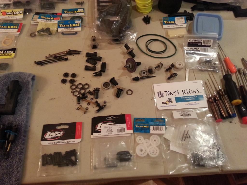

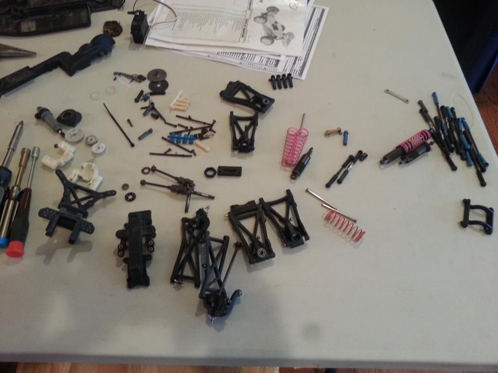

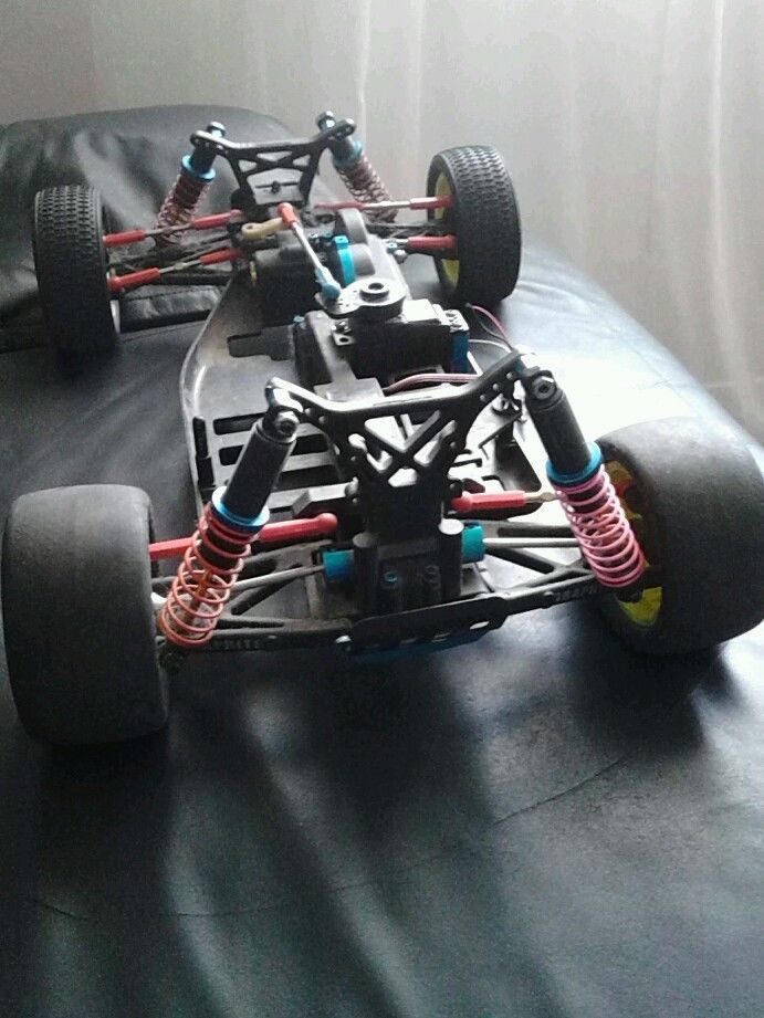

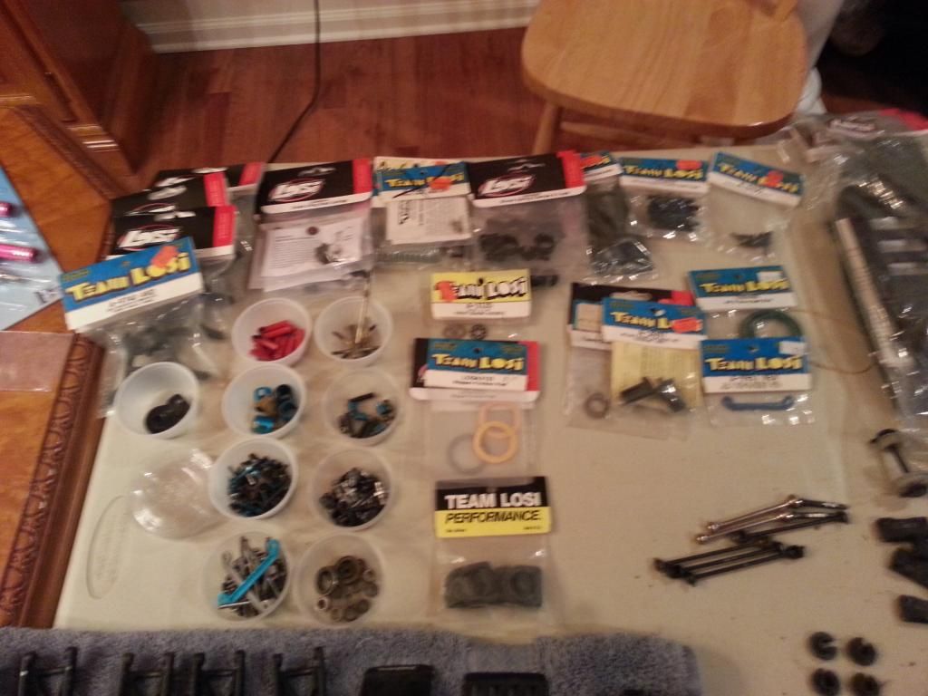

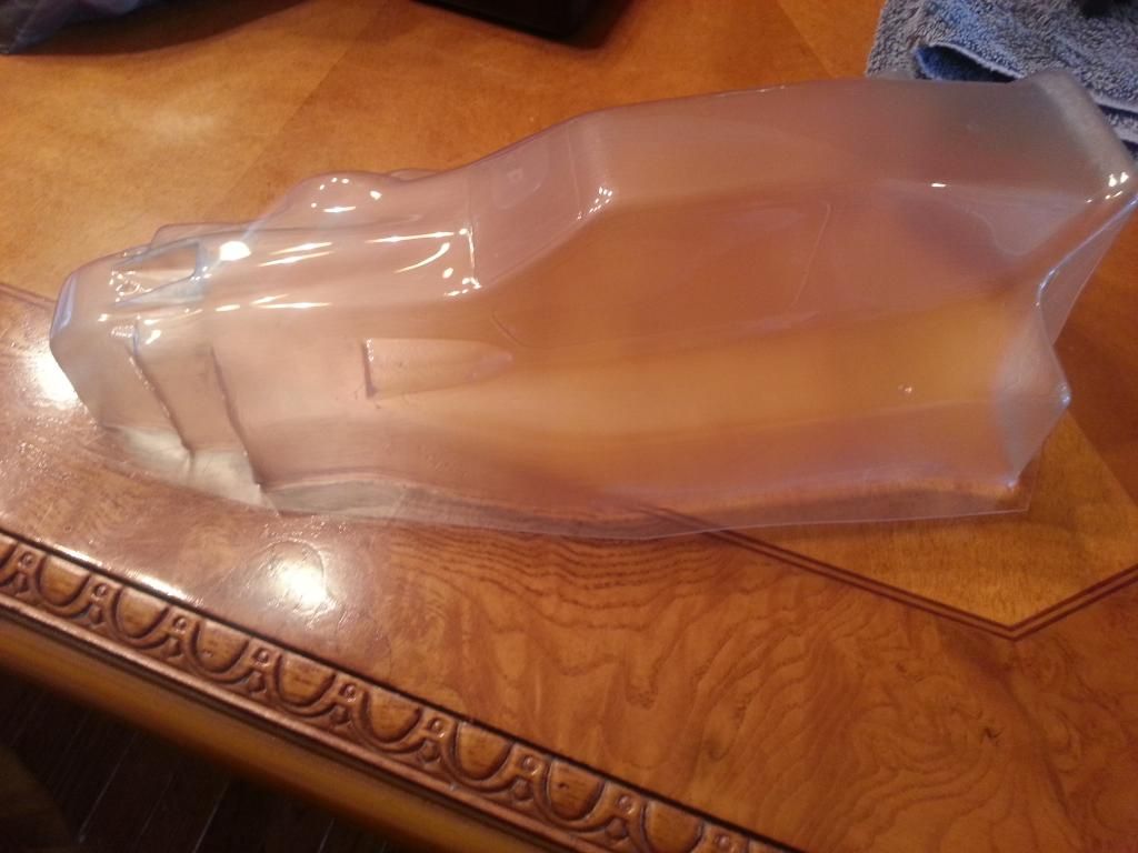

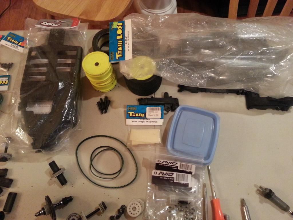

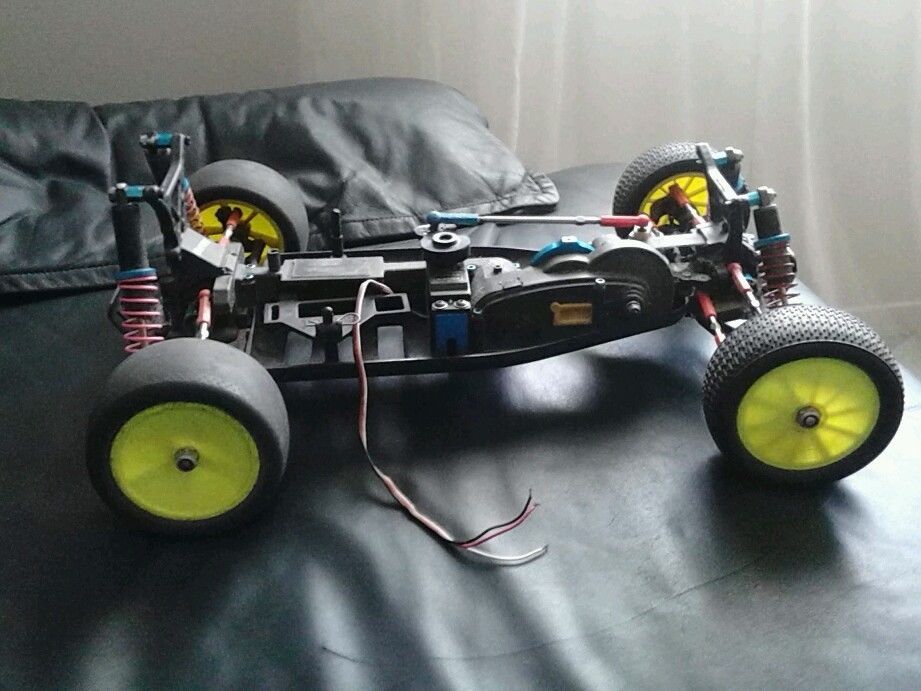

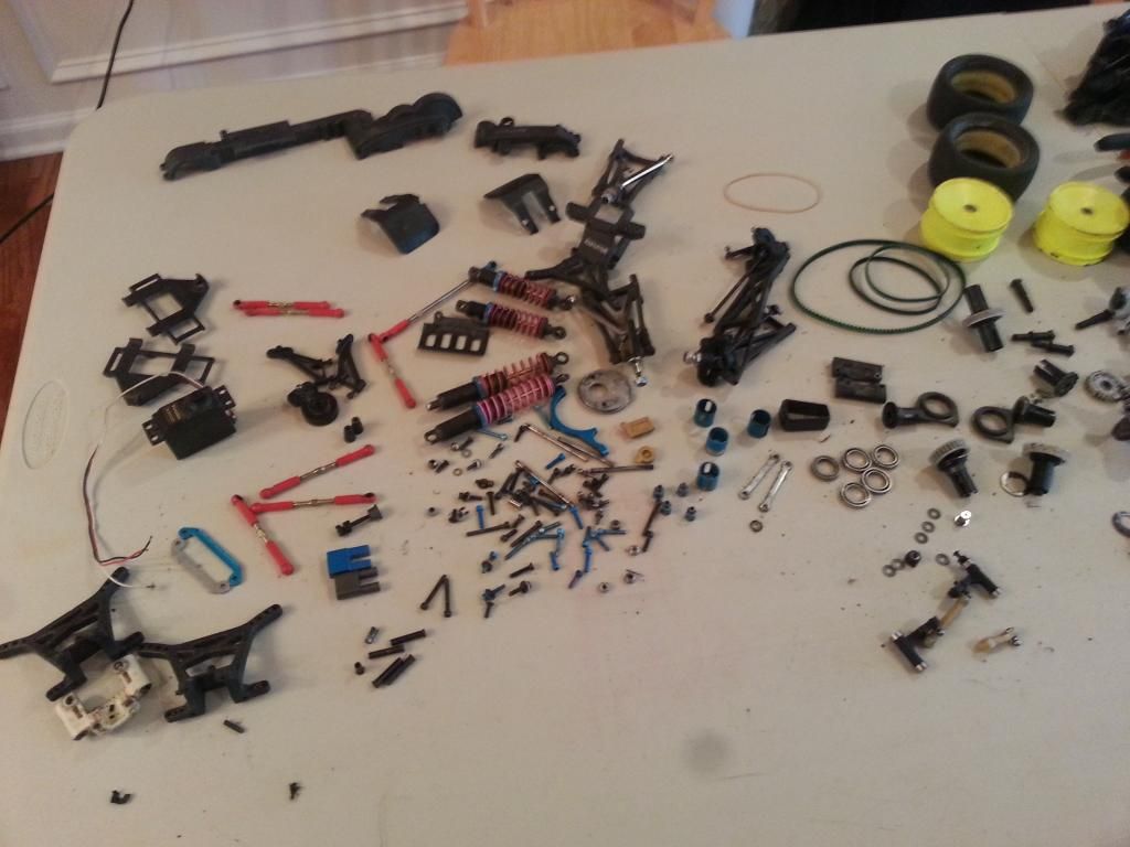

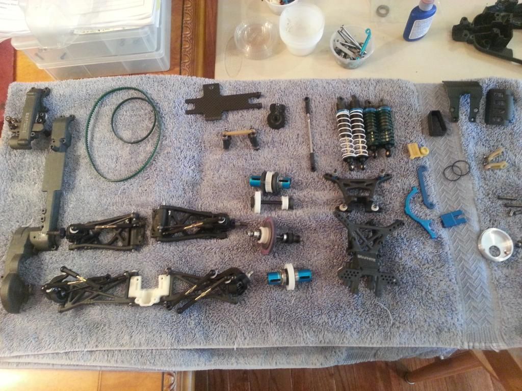

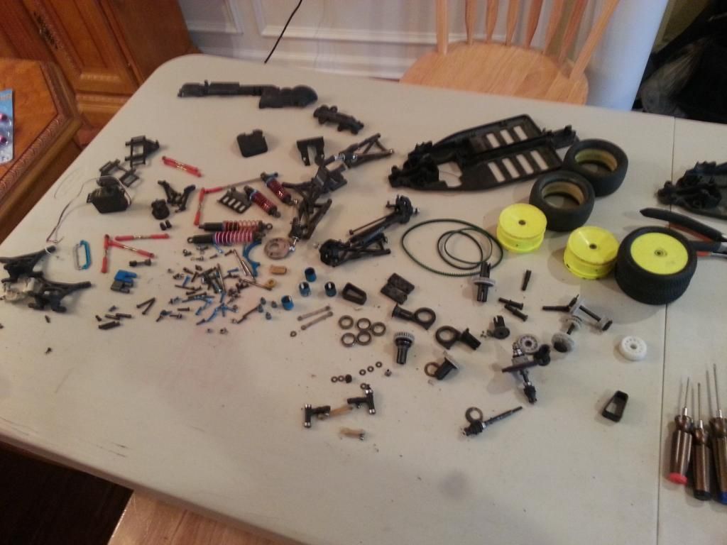

Finally have some progress. Still waiting on a some kind of a side belt. I did order the ToughRacing belts but it takes awhile for the Korea to US shipping. As we all know, until I get the belts, I can't do anything right now! I did build the various sub-assemblies so I can drop everything together once the belts hit the house. I have included the photos from the auction since I forgot to take pics of it when I got it. It was more rough than the photos portray and covered with so much hair, dirt and grime. At this point I have so many "new" parts this is like opening a box and building it for the first time, lol!
Condition received:
Disassembled and cleaned:
New parts (It's like Christmas!):
Sub-assemblies:
Body prepped for paint with liquid mask:
Condition received:
Sub-assemblies:
