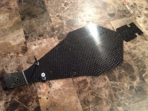

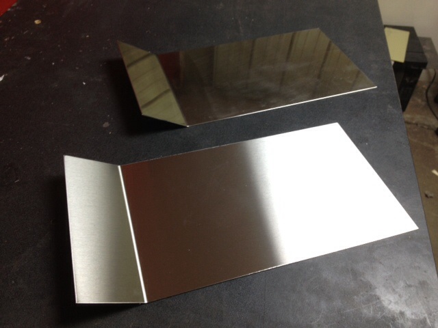

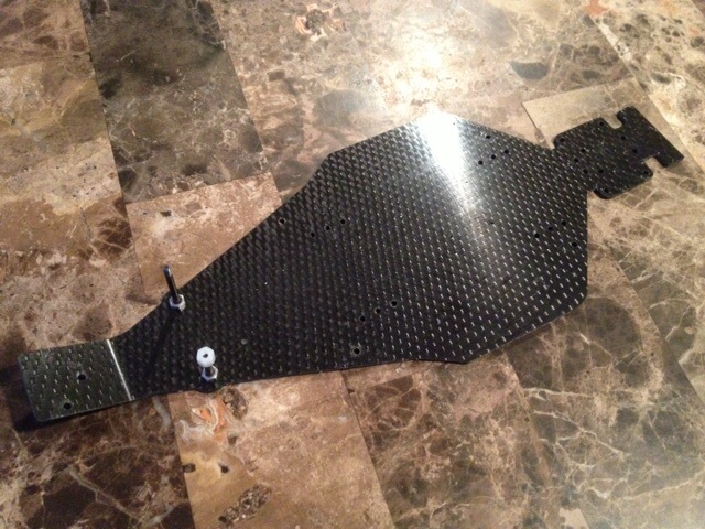

Thanks for your help with the pin router Jeff :) I won't bore you guys with the details but I made stainless steel 30 and 25 degree kick up molds and they worked out great. Chassis template finished and pulled a 30 degree for my stealth car. Now it's ready for the pin router :D Tried to match the weaves from masami's chassis and top deck the best I could. I think it came out pretty close!

Thats AWESOME! You have to share your technique on laying up the chassis, I would love to see it.
BTW, if you can space up your template it makes life easier :mrgreen: I use 3m double side tape but spacers would be great too. That way the router wont kill your template

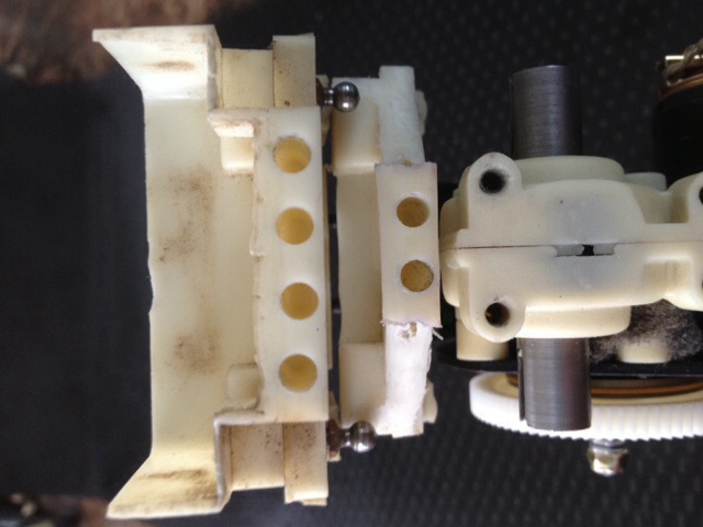

I notice all my rear bulkheads mounting holes are off center from each other. I'm talking abouth the 2 bottom center mounting holes that are not normally used (except for a stealth car :D ) is anyone else running into this issue? I checked 4 different bulk heads and they are all like this. Oh and by the way these are non re-re bulkheads.

Hope this better explains what I'm talking about. The 2 center holes are not centered . Not sure if it's just my bulkhead or if the originals are all like that? I would hate to build a chassis with offset holes and find it only a small batch that was offset :x
Posts: 12336
Been thanked: 3917 times
Re: Minisforever's 91 masami build
I've never noticed, I'll check mine tonight
marlo
Posts: 2071
Has thanked: 18 times
Been thanked: 22 times
Post by marlo »
Why are those two center holes there anyway?

marlo wrote:Why are those two center holes there anyway?
For the stealth car they knew they would create in the future silly :mrgreen:
Honesty... Hard to say. Weight? Can't think of a single reason for them really
DaveM
Posts: 1254
Has thanked: 727 times
Been thanked: 26 times
Post by DaveM »
Hi Guys,
I just grabbed a bulkhead not a re-release from my 10T Team Truck, one of the two center holes is
closer to the edge than the other, so the two are not parallel.
In fact mine looks exactly the same as the pic.
Dave. :)

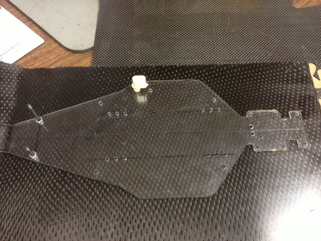

romulus22 wrote:Man I didn't realize you were doing whole chassis with different kickups. 8) are you going to design a new front bulkhead for this chassis?
Just gonna modify the existing nix bulkhead I have. Least that's my plan :D
Cut my first chassis out today on the pin router. Came out pretty good... But I need to make another one. Couple changes with one of those being thickness. So out in the shop I go for another chassis blank :roll:

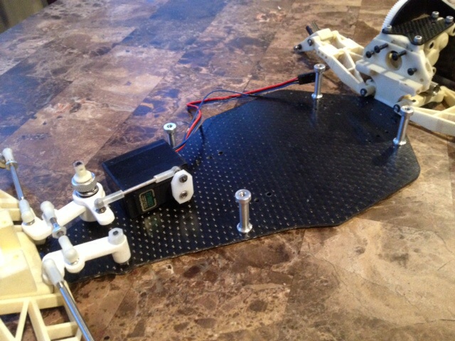

im sure your just testing to see who is paying attention to your photos, but the rear arms are on upside down
ed

Upside down? I hope not, I didn't have that many beers! Lol I think it's just the crappy quality of pic. Thanks for looking out for me ED, I need all the help I can get! :lol:

edwin pibal wrote:im sure your just testing to see who is paying attention to your photos, but the rear arms are on upside down
ed
They look correct to me also, are you sure your monitor isn't inverted?

why yes....
now who turned my screen upside down?!?!?
