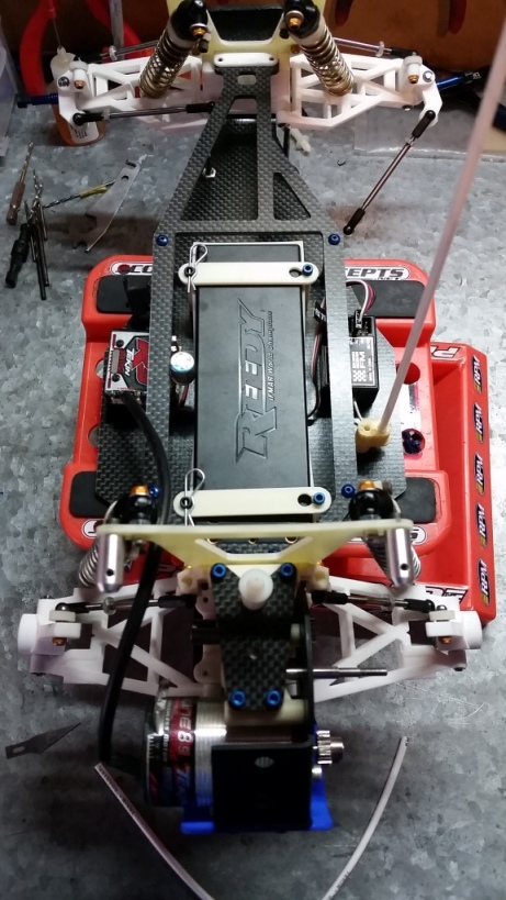

Here is where this thread goes to shit. While waiting for my silver anodized screw set I bought racing parts and started building a runner. I will still continue to acquire parts for a replica build and post both build picks on this thread.
Here is an update, this is my runner
I got the blue rear motor guard to tie in with my racers paint scheme, the blue screw and gold mini nuts helps too.

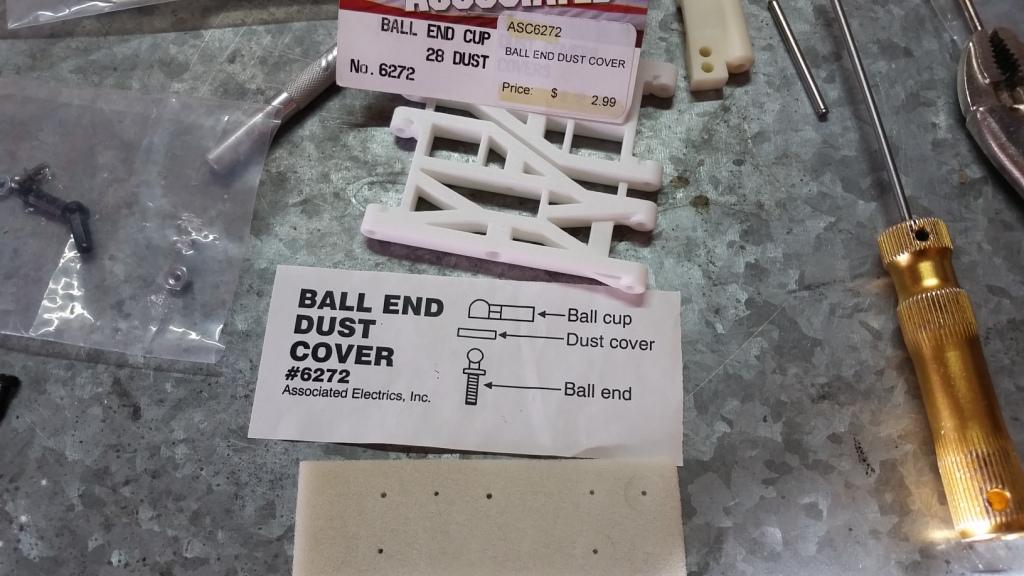

As crazy as it sounds I've seen someone use those dust covers with the ball cups that have the hole in the top of them
vintage AE wrote:Oh yeah, glad I had these dust cover instruction to guide me along

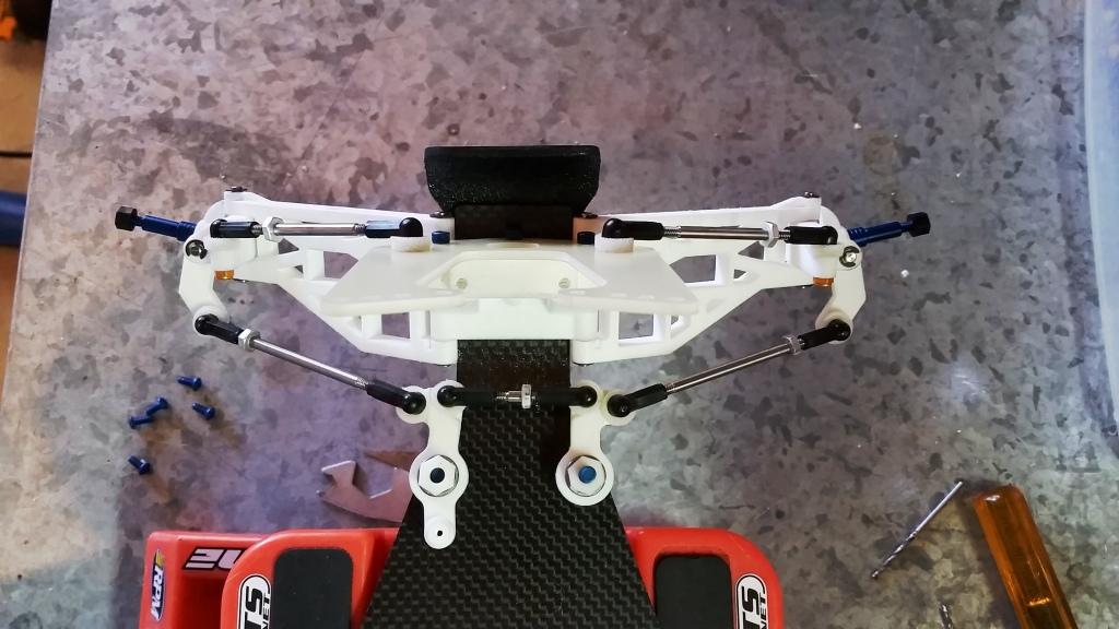

nothing about this steering geometry makes sense at all. I thought the NIX racing bellcranks were longer. The Lunsford turnbuckles are at minimum length too. Looks like I will be ordering the other style of NIX racing bellcranks.

Those are for a standard rc10. There are 2 bellcranks for the stealth car. Standard and race versions.

That's right. Those are not for NIX91 car. You can mount them in a RC10 much better.
This is the Race steering set you need:
http://shpws.me/CpHF
-Niki-

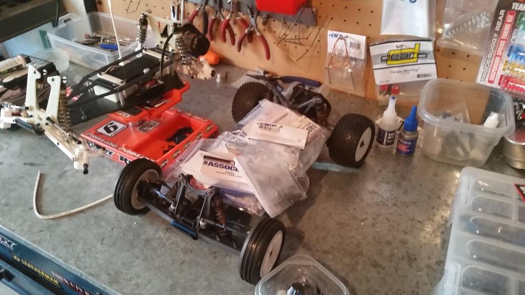

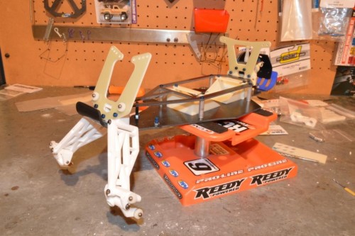

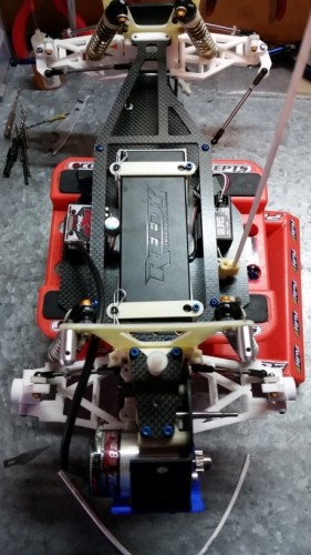

This NIX91 runner build has taken a turn today. Here is a photo of it this morning
I went to visit Rod at the shop and ended up at his place after he got off work. This pile to the right of the NIX91 is what I ended up coming home with
A B4 roller that will be scavenged for a couple different runners I have including the NIX91 and a heaping pile to go along with it. The build is not even going to resemble it's current look, it's going to turn out so nice it's going to be hard to run, but it WILL be.
Different electronics will be in place too. I've got a bunch of rearranging to do with a couple different builds to get this one complete. I will show some more detailed pics as I go along.
Technical notes are typical of the other builds. The trans brace had to be shimmed and the top plate front holes had to elongated slightly to relieve stress on the chassis. The 4-40 holes were reamed with a #30 bit. I used a 1/8" to ream the pin hole, but I wished I had something just a hair thicker. The parts don't move completely free and will ream them again with something else once I know what to use.
