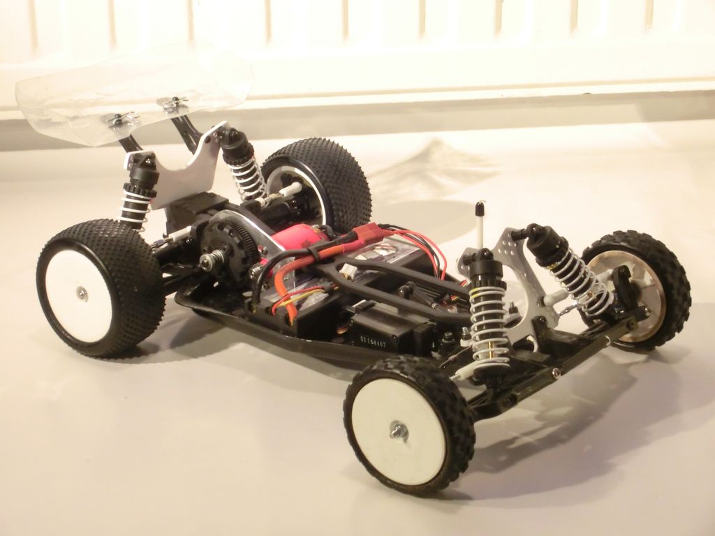

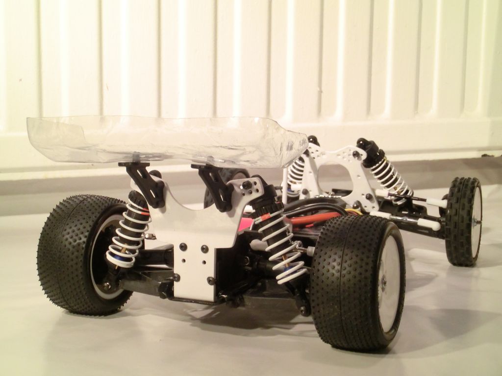

Thank you eugine and Lonestar for the continuing interest to this project. I've been able to put the car back together and decided it would be a good time to take and post some new pictures. Related to the pics Lonestar, the Dropbox hosted images show up properly with all of my devices, but I've now attached them to this (and previous) posts. I'd be interested to hear if others have problems of images not showing? Also, for those interested, there are more photos of the current state of the project available in my Dropbox album.
The status of the project is that this unholy Traxxas / Schumacher Cougar 2 frankenstein of a buggy is in driving condition . Note: not racing, but in driving. This is currently not a problem, because lately I've been building the buggy with my 5yr old daughter and I've been motivating her by saying we are building it for her. So, the parts do not currently have to endure huge speeds nor the drivetrain ridiculous brushless power. The prototype custom parts made from random plastic pieces from my materials bin should do for now.

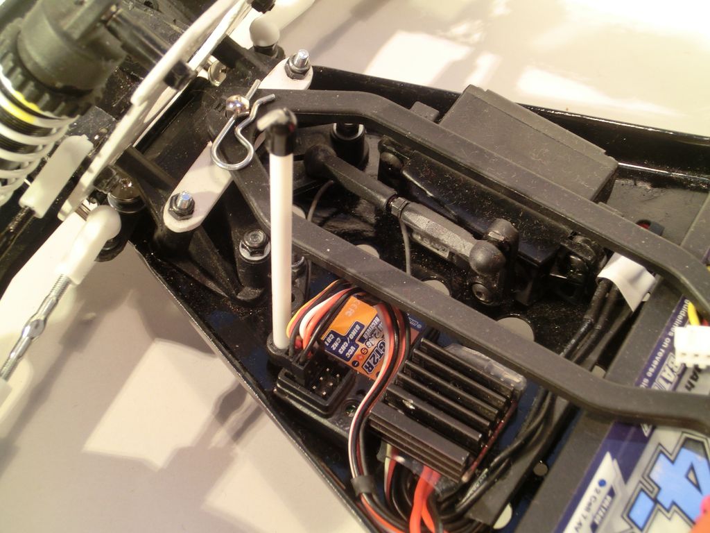

I installed some random electronics I had laying around. An ACOMS AS-12 servo, 27T stock brushed motor from the '90ies, and a cheap Chinese 10A ESC to drive it. I checked with a multimeter that the amp draw from the motor seems to be low enough with conservative gearing, but I did glue an heatsink to FETs to help to keep the ESC alive.
Unfortunately, the winter and snow here in Finland prevents proper shakedown testing. There is an indoor track which I've been planning to to visit it this winter, but it's some 100 km away. However, if we are able to go there, I'd like to take some video footage on how the buggy behaves with the moderate electronics currently installed.
I have some future plans and upgrades for to take the "C2KF" to the next level:
- Drill the steering levers to fit small bearings. I'm currently using short pieces cut from a brake line there because I did not have spare U749W steering pivot bushings. However, there is quite a lot of slop causing, e.g., bizarre effect of varying bump steer. Again, not a problem at the current speeds, but if I ever wish to properly race this thing getting rid of the slop is a must.
- Purchase more contersunk hex hardware. Currently there is some buttonhead screw ends sticking out of the bottom of the chassis, and it is not good.
- Cut the rear shock tower and steering rod out of FR4 (they are currently made of soft and brittle plastic).
- Fit longer inner telescope drive shaft halves. I'm currently using the 4-tec ones and they are way too short to handle any serious amount of torque.
- Replace the differential pulley and driving pulley as they are rather worn out. While at it, also replace the drive shaft with a one that allows adjusting slipper with a nut instead of inserting spacers.
- Make a new motor plate that takes two shafts and gears. This was discussed earlier with DennisM and Mr ED and the idea would be to allow rotation of the motor to push the rear wheels down instead of the front wheels as it is done in a modern mid-motored buggy with a 4-gear transmission. At the same time I'd be able to swap the last undersized 8x5 bearing in the powertrain to 10x5. As and additional advantage this would allow changing spur without removing the entire gearbox assembly

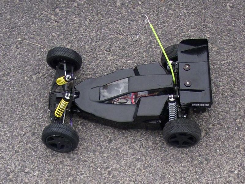

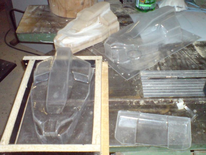

Regarding next steps: Some years ago I made a mold Cougar SV style body that would fit a vintage Cougar, just for laughs as SV was new back then and I sometimes took part to local races with my vintage Cougar which caused some confusion. The idea was to confuse people even more. I have one clear pull left from my experiments. It's not perfect, as the PETG plastic is too thick and the mold should've been smoother, but at least the one I used with my runner for some time looked OK.
