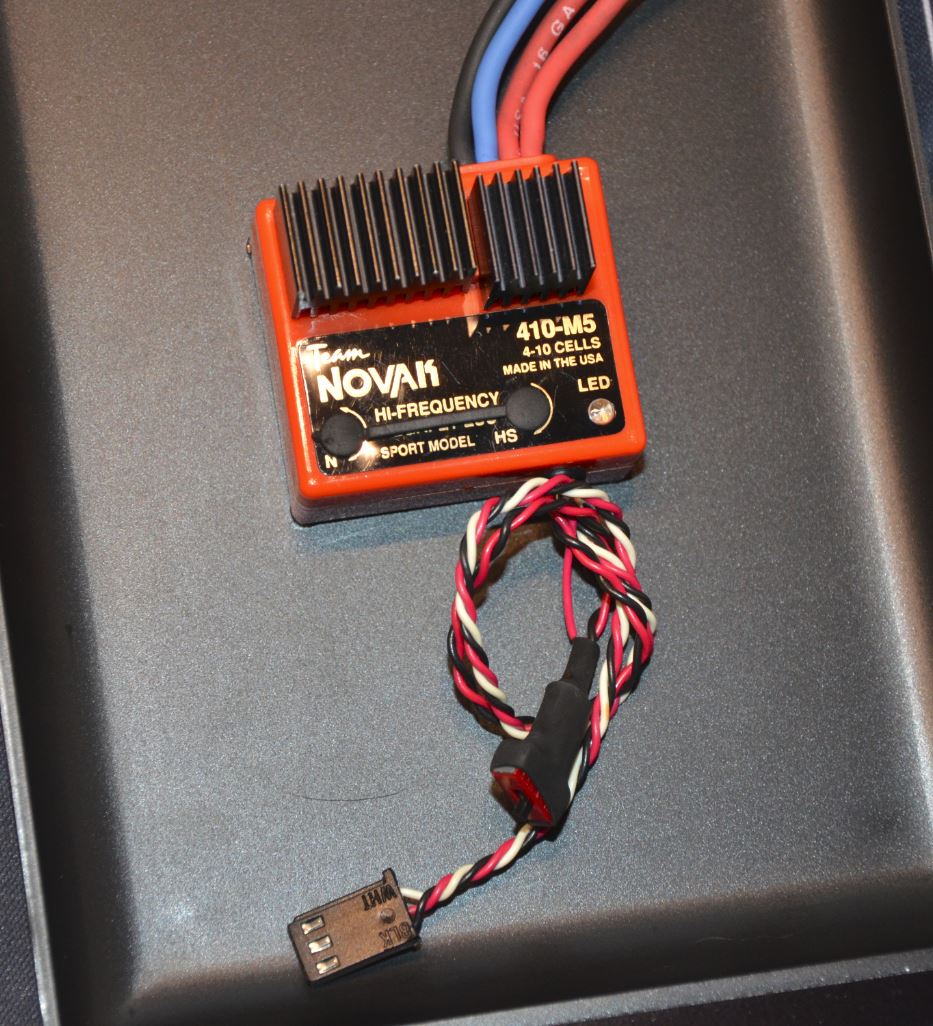

I purchased a vintage Novak ESC on ebay. I got it quite cheap, and am currently cleaning it up and possibly changing out some wires. Am am happy with how well it cleaned up. It should hopefully pass for new once I am done with it.
I have a brand new vintage Novak T1X, as posed above, but I don't think I want to use that on this build. It has a larger physical footprint, and may not layout as nice in the chassis.
Can anyone tell me what model Novak receiver would have been used in 1991-1994 era? I have a couple vintage Novak receivers, but am not sure if it is from that time period. Thanks.

Finished cleaning the Novak ESC. I'm thinking I will recover/change the 4 power/motor wires once I get further along in the build. I am thinking of going all black wires, for a very clean look. Is it considered a faux pas to change the wire colors on a vintage build? I do this with all my modern cars and trucks. However, I was also thinking of maybe going with something crazy early 90's color style like purple, pink, or something. Not sure yet.

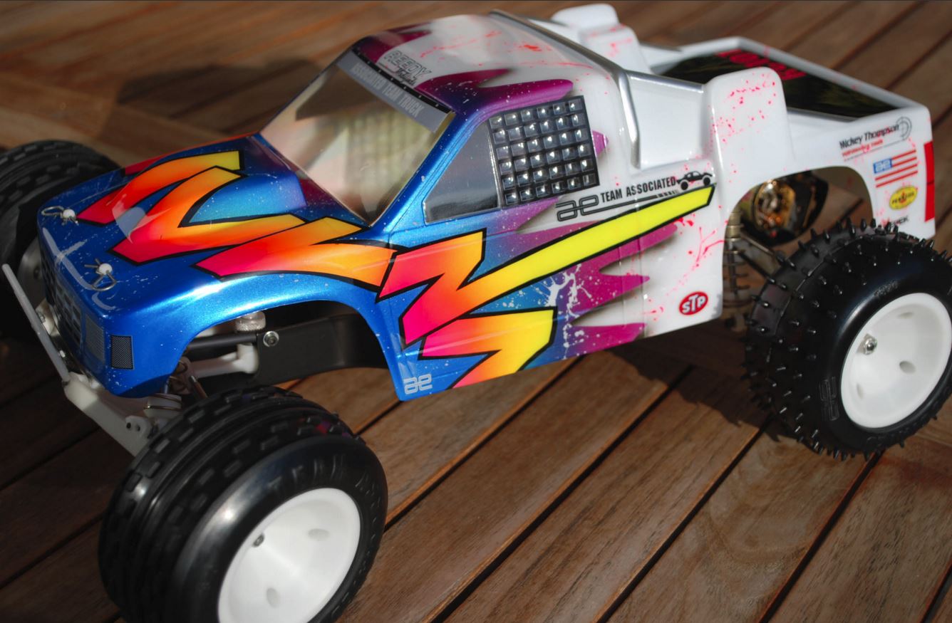

I am still trying to decide how to paint the body. My RC10T rebuild I did in box art. However, it was a reproduction body, and the paint is not exactly true to the original. It was painted by that guy on ebay (gonracing-rc) who does nice work, but again, the design was not exact to the box art.
Since this body and decals are original, I thought it may be good to have a quality painter give it a true box art paint job. But, I also really want to do a colorful early 90's style as well, which would tie in well with the vintage electronics. The body that member LONESTAR had painted is absolutely amazing (see below). It is my favorite RC body art.
Decisions, decisions....

I like the look of "box art" 10T's but it seems to be what 90% of the guys are doing. If it were a poll my vote would be for a 90's style paint scheme.

Same here, I've been pondering what scheme to do on my 10T as well. I had the team truck scheme when I raced in the 90's, but I did modify it a bit. Same with my buggy schemes, they were the Team Car colors. Better pictures of the 90's top racers would help I think.vintageguy wrote:I like the look of "box art" 10T's but it seems to be what 90% of the guys are doing. If it were a poll my vote would be for a 90's style paint scheme.

I vote a box art paint job on the original body and a 90's scheme on the "new" Associated Body or TBG copy.

Your original esc wires look to be in good condition and long enough to hard wire to the motor. I would keep the oem wires!
An Novak NER-2X or NER-3s would be correct for this build.
