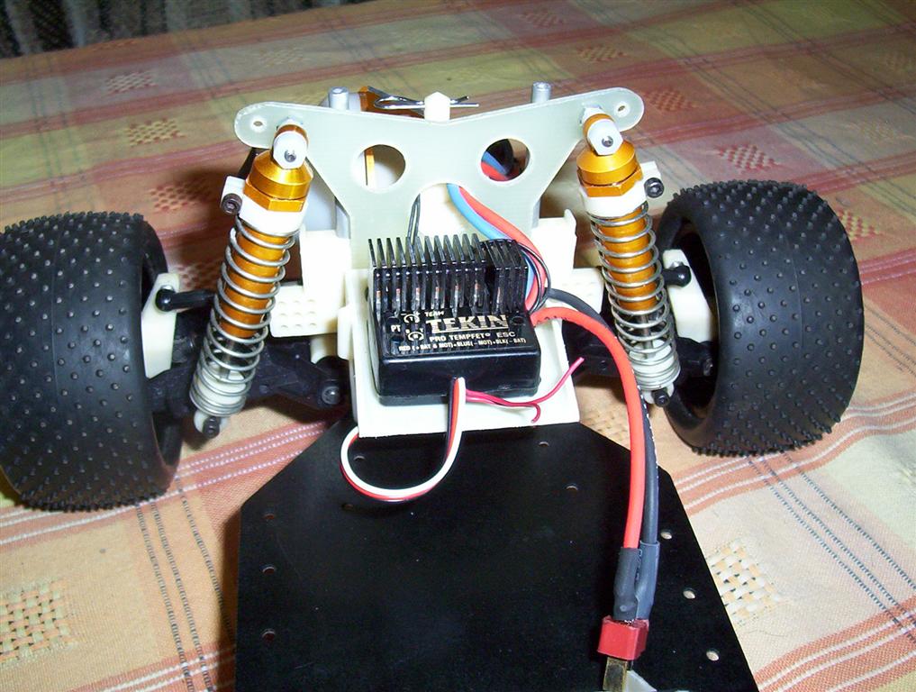

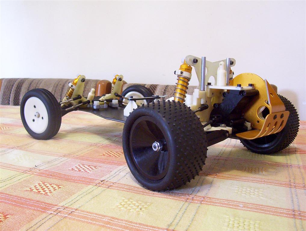

Hi Guys,
I redyed the Trinity Rims to black and added a pair of Pro-Line Flat 80's tires and a pair of CE wheels
with tires.
Onto the electrics!
Latest pics,
Cheers, Dave. :)

Not trying to knock the buggy at all. If it were me, I would dye the fronts to match, or add some black TQ front wheels and some period correct Ti links . The chassis/arm/trans/trinity wheel/RPS bellcranks bothbellcranks all scream 1988/1989 to me, just needs a RCPS Mirage SS and paint!

I don't know.. I may be nuts but I kind of like the mismatched wheels, it is very back in the day racer like :)

Hi clm,
Thank you,
With the black arms and black gearbox, white suspension mounts, white bulkhead etc,
the mismatched wheels actually look really good, much better than in the picture.
Cheers, Dave. :)

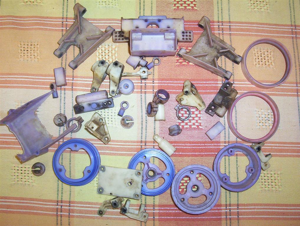

Hi Guys,
I bought this washing bag to wash all the plastics in my washing machine.
Any parts that are completely white will stay white and any parts that are partly dyed/ or have dye
residue will be dyed black.
Then I will see how the original bulkhead looks.

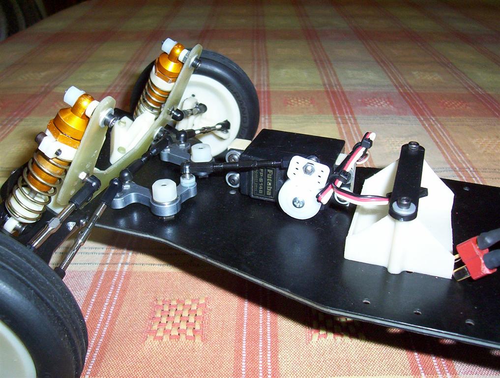

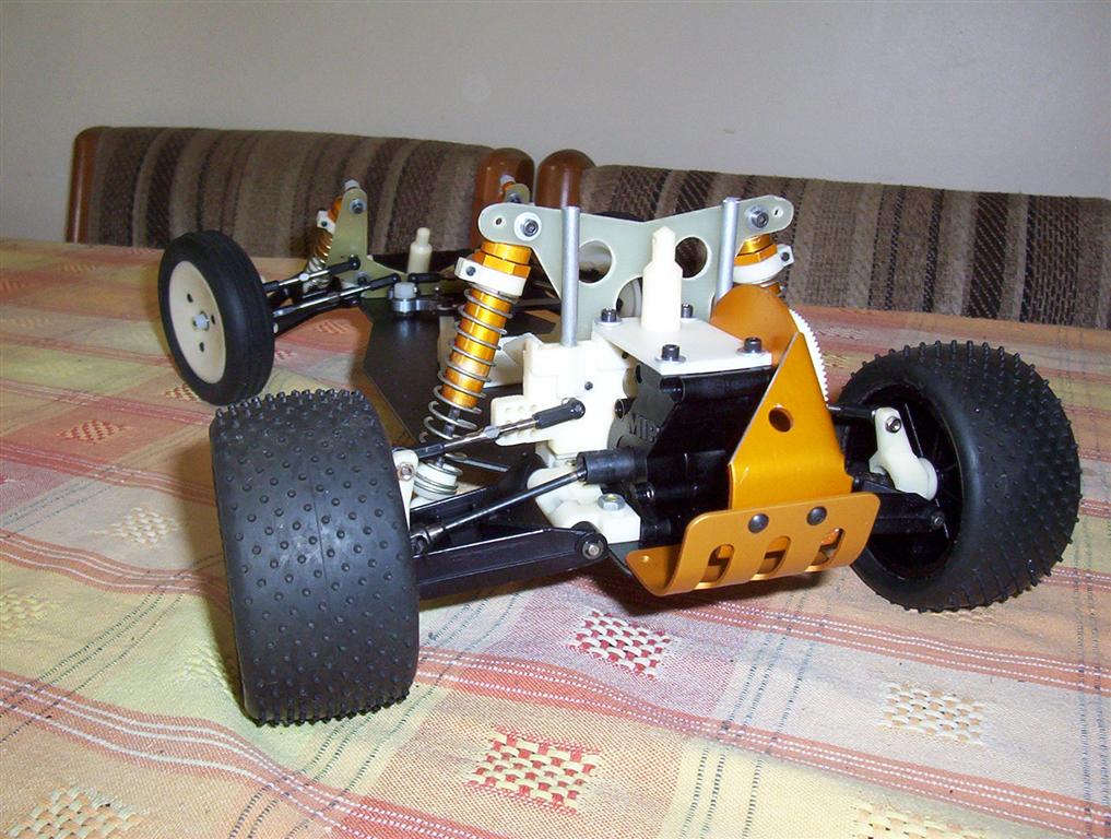

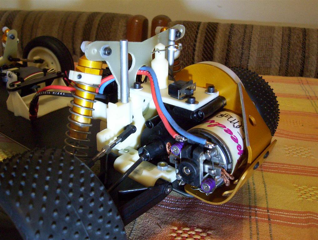

Hi Guys,
I have been working on the electrics.
The motor just needed a good clean, with the speedy I had to change the receiver wiring.
The servo I swapped for one that I had, same model, that has good wiring.
I just need to mount the receiver, but also need to get a antenna.
Latest pics,
Cheers, Dave. :)
