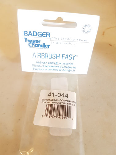

Coelacanth wrote: Thu Feb 09, 2017 1:46 pm You also mention using a detail tip & needle for shading...do you happen to know what size that is? My shading skills definitely need some help. :)
It took some looking around on the internet, but found it eventually. When buying the different combo kits at the store, there are no sizes, but found a website that had the background knowledge to post it.
http://www.dickblick.com/products/badger-airbrush-needlenozzle-replacement-kits/
This is the finest one I use for detailing... Pro-Production Super Fine Detail Kit, 0.3 mm
This one for small areas... Pro-Production Fine Detail Kit, 0.4 mm
And this one for larger areas... Pro-Production General Purpose Kit, 0.5 mm
This is what you'd see at the store
