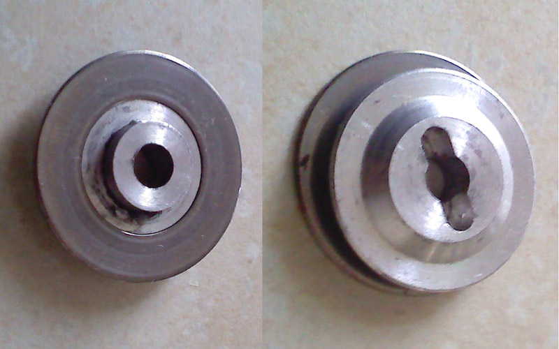

Re: MIP question for the pros
So you want to hear funny?
I'm looking at those pics and the spring, of all the pieces in the package, sets off a trigger of familiarity because I'm using a spring very similar to it on the modded Duratrax slipper on my MIP trans. Then I remembered the spring came in a lot that had a few 6-gear outer diff plates and a few other slipper parts that I couldn't identify....one of which I recall looking pretty similar to the inner slipper hub in that package.
So went and dug it out to check and surprisingly it turns out I've got most of the parts to a Bullet Slipper Clutch.
Not for a MIP though as it fits a 3/16" top shaft....which unfortunately I don't have. Will snap pics in the morning for confirmation.
- Posts: 1166
- Joined: Fri Mar 11, 2011 4:20 pm
- Location: Houston
- Been thanked: 4 times
Yup that's it. I need to see if Barry has any top shafts lying around in his parts boxes. I don't remember seeing any but then again I wasn't looking for them.
