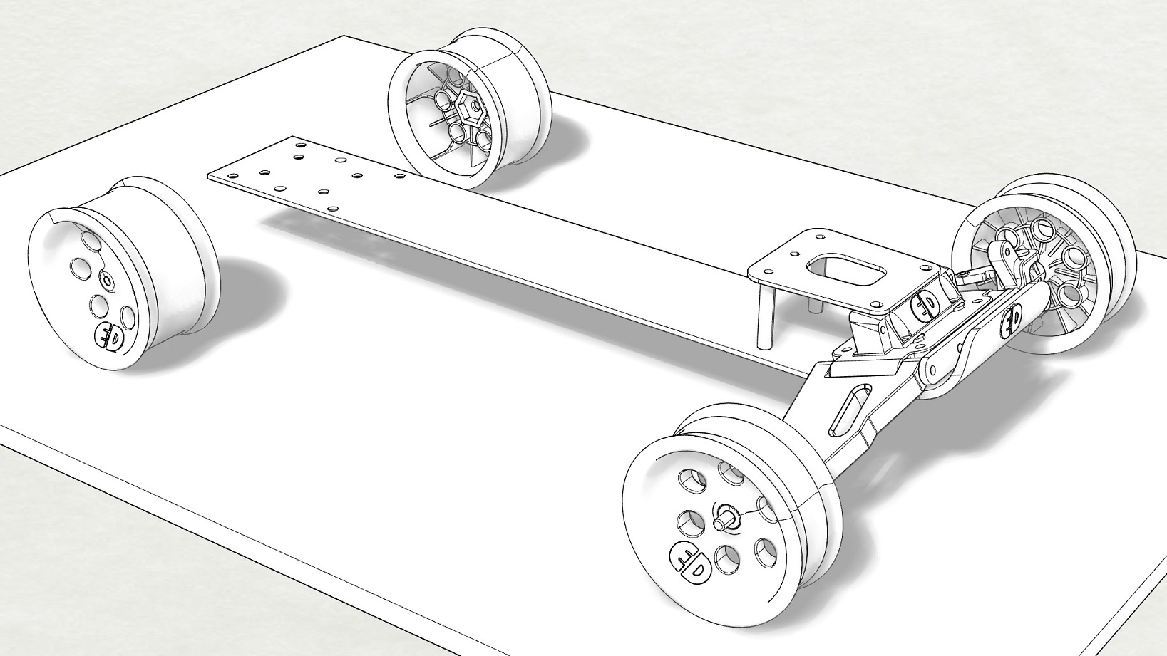

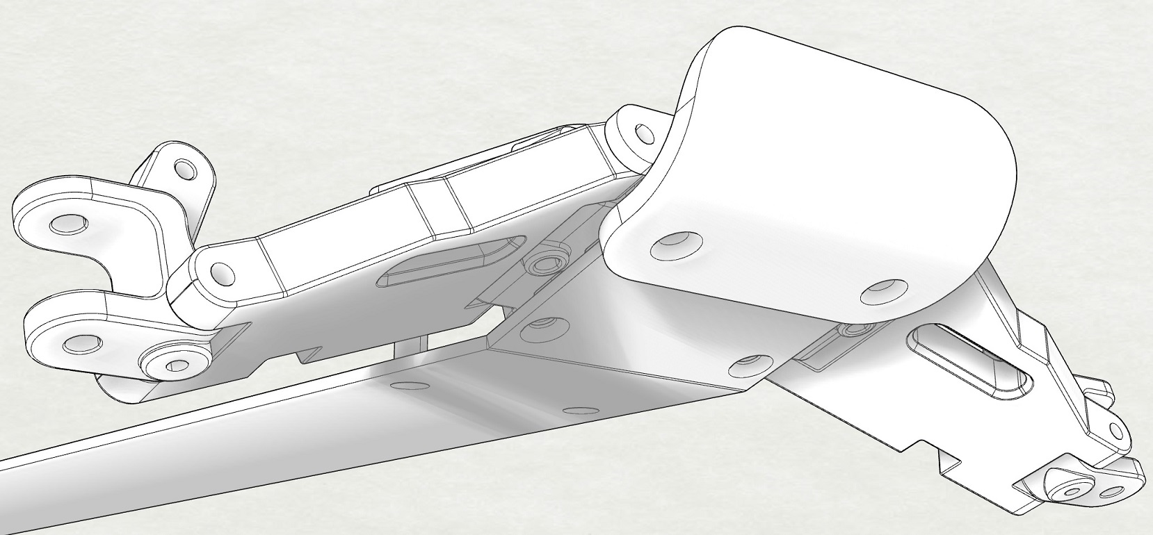

I'm in the Us at the mmoment and can't do a lot without the parts to measure up. But here's the finished up C-carrier with provision for a grubscrew (M4 again).
If someone wants to give me dimensions or a discarded b3 C-carrier I can make acustom design to use with B3 steerringknuckles and axles
I'll also ask ORB about whether a printed wheel is worth trying.
Icould get that designed without needing much measurement: just the bearing surface length on the standard ultima axle so I can calculate how much space I need between the bearing surfaces

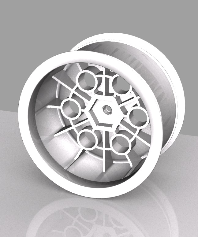

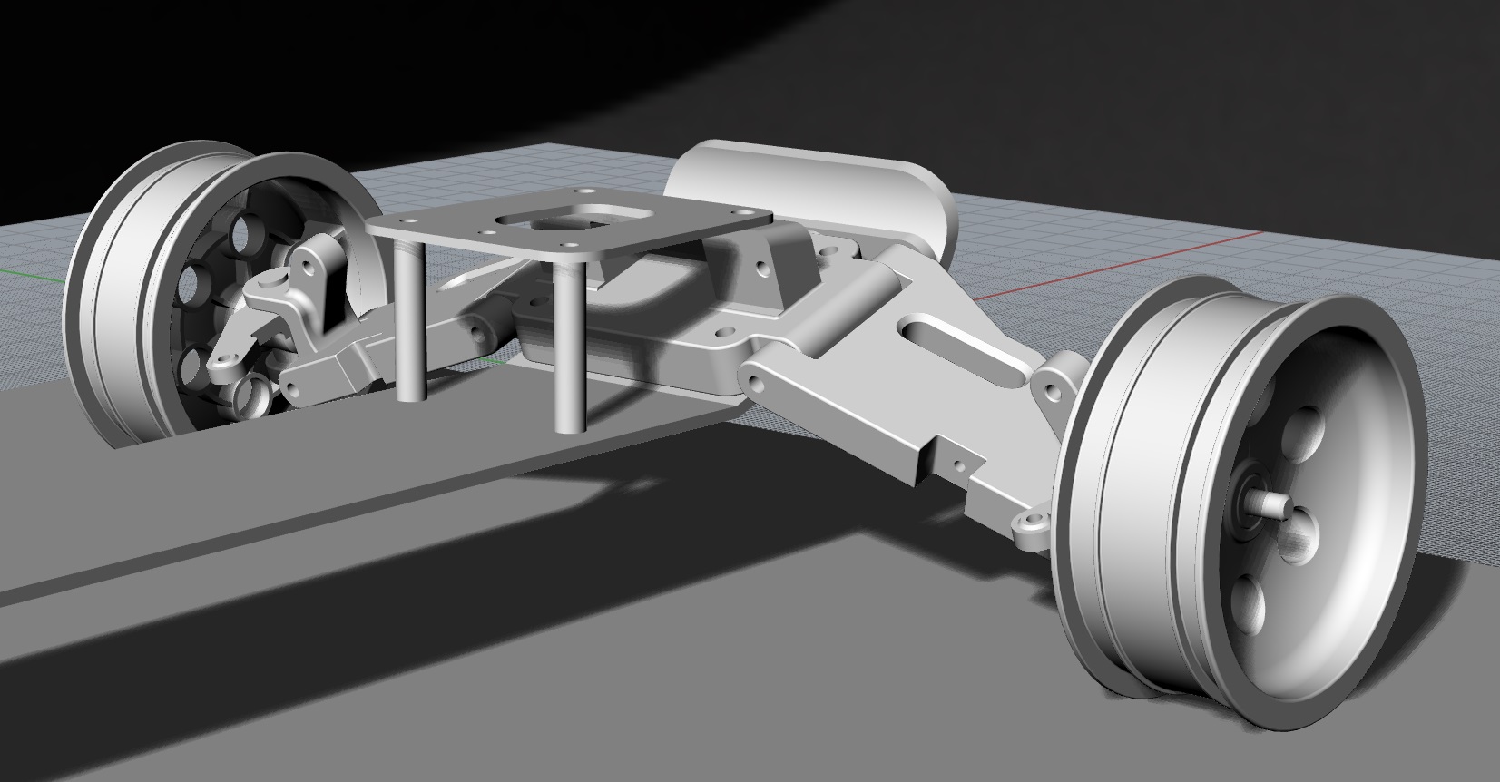

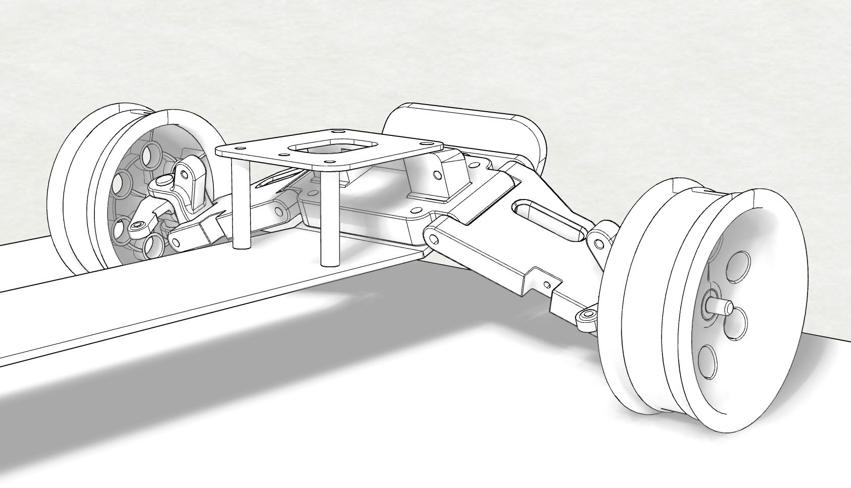

Orb told me a printed wheel should work, but is probably on the expensive side.
So, this design for a 2.2" sized front wheel on 4 by 8 mm bearings is just for fun really: I also drew up some the axles and bearings, steering pin and steering knuckle. Just going for visually more or less correct copies of the original as I had no specific ideas on improvements for these and no plans to print, or, produce them in another way.

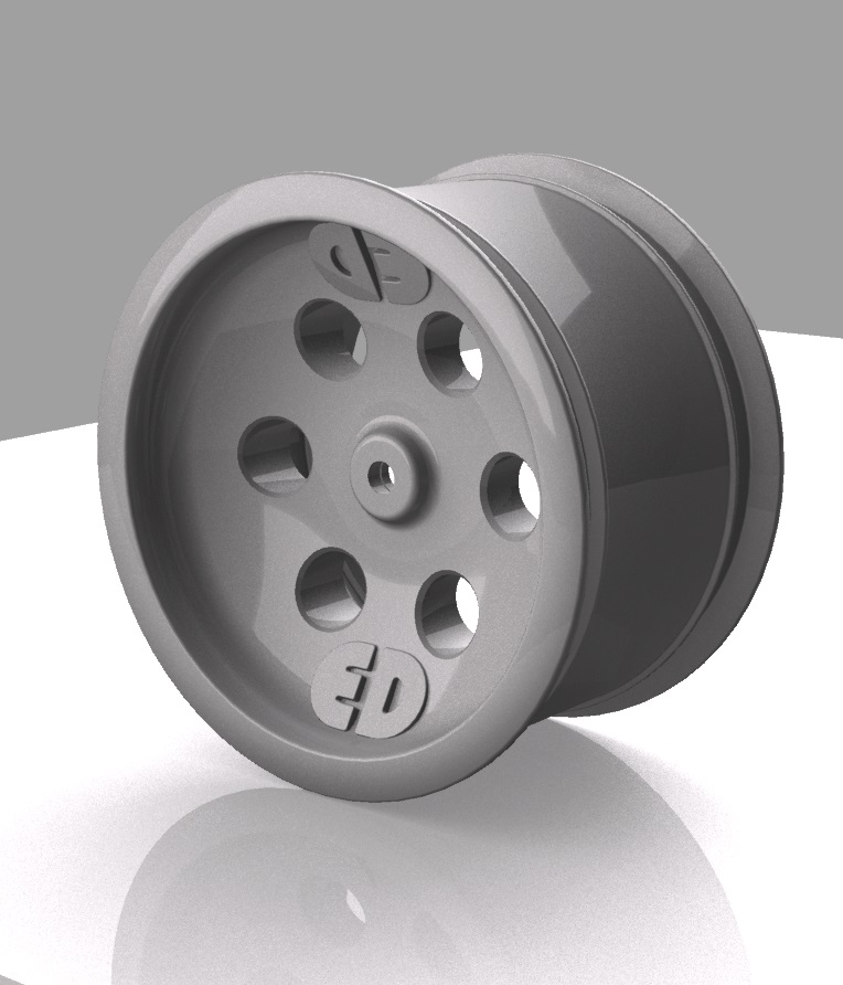

Real cars have 4 wheels
Andd I couldn't just leave it at fronts only. So here are the matching design rears. 2.2" and offset copied from the 1.9" 2 piece optima mid wheels.
These renderings show some of the work put into the design: trying to keep in thin walled but strong. the prints will be much duller. No way to print a shiny part just yet.
