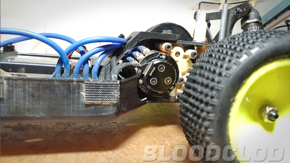

Re: BloodClod's RC10 Mid-Motor
Just a few more pics. The chassis had to be cut to accommodate the motor and gear covers. To do this neatly I actually drew up a simple template and printed it out so I could mark out the curves to be cut on both sides of the chassis. After this it was relatively simple to use a dremel to drill out some holes, break off the unwanted portion and then dremel again to sand it smooth. Motor is easily accessible.
As most conversions go, the chassis will require more holes to attach the flipped transmission to. Initially I was going to just drill 4 new holes for the gearbox and 2 more for the bulkhead, but after I mocked it up I realized that a number of the holes would be really close to each other... this meant would not only be aesthetically unpleasing but also weaken the chassis quite a bit. Another downside to this would also be that by retaining the stock suspension mount positions, the wheelbase of the car would be shortened as the suspension arms would need to be flipped for the conversion...
So after taking some measurements, I was happy to find that I could actually shift the suspension mounting holes back by 15mm. With the flipped arms, this would take my wheelbase to about 280mm which is up to spec with current cars for a more stable drive. Doing so would also reduce the amount of rear overhang of the chassis as well as further center the weight on the chassis of the car. The other upside - there would be a lot less overlap of the new holes on the original ones for a slightly cleaner look and stronger chassis.
