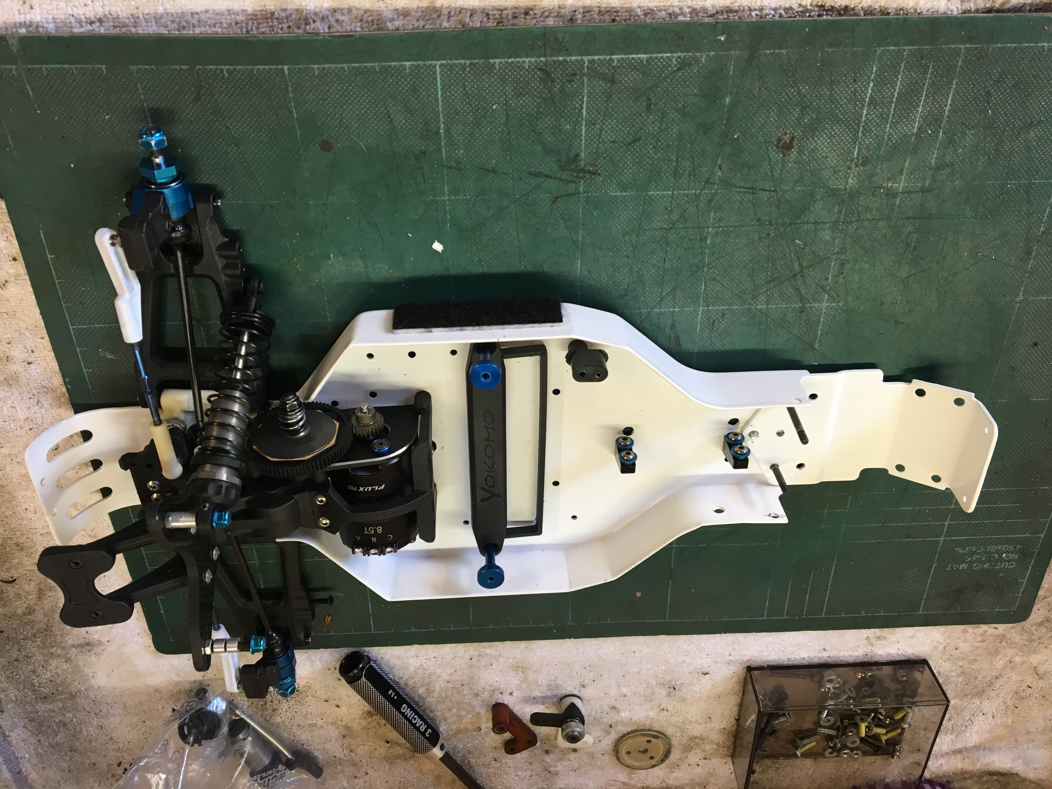

Re: RC10-YZ-2 hybrid is turning into a truck!
Post by Headling »
Rear driveshafts sorted, b4 axle, mip t4 shaft, axle shims and a Tamiya 12mm hex and we are business!

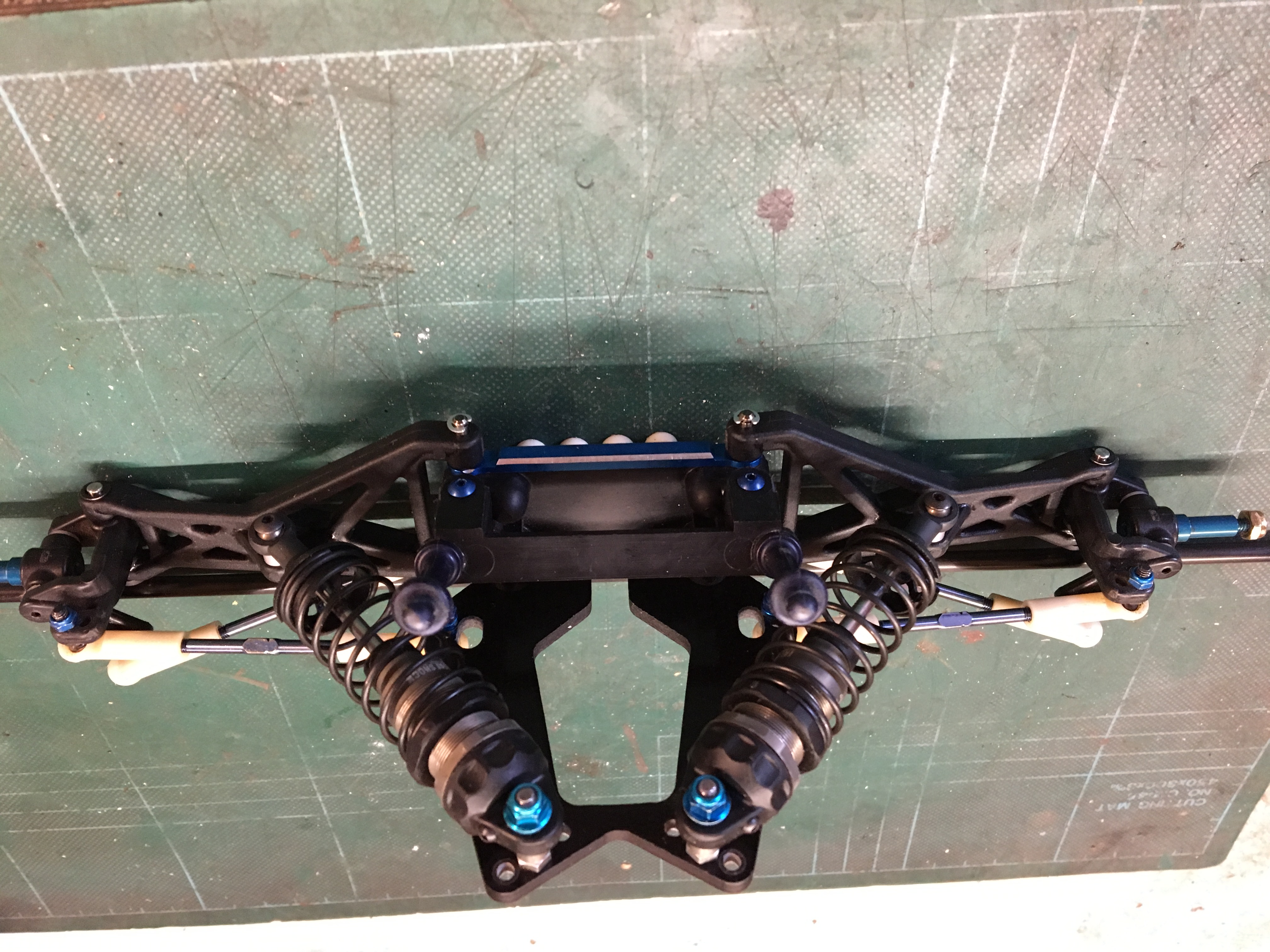

Post by Headling »

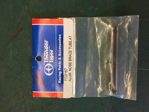

Scored this front brace off eBay for £4 and the front end is nearly complete!
Carbon tube in the pic is for me to make up some nose tubes!

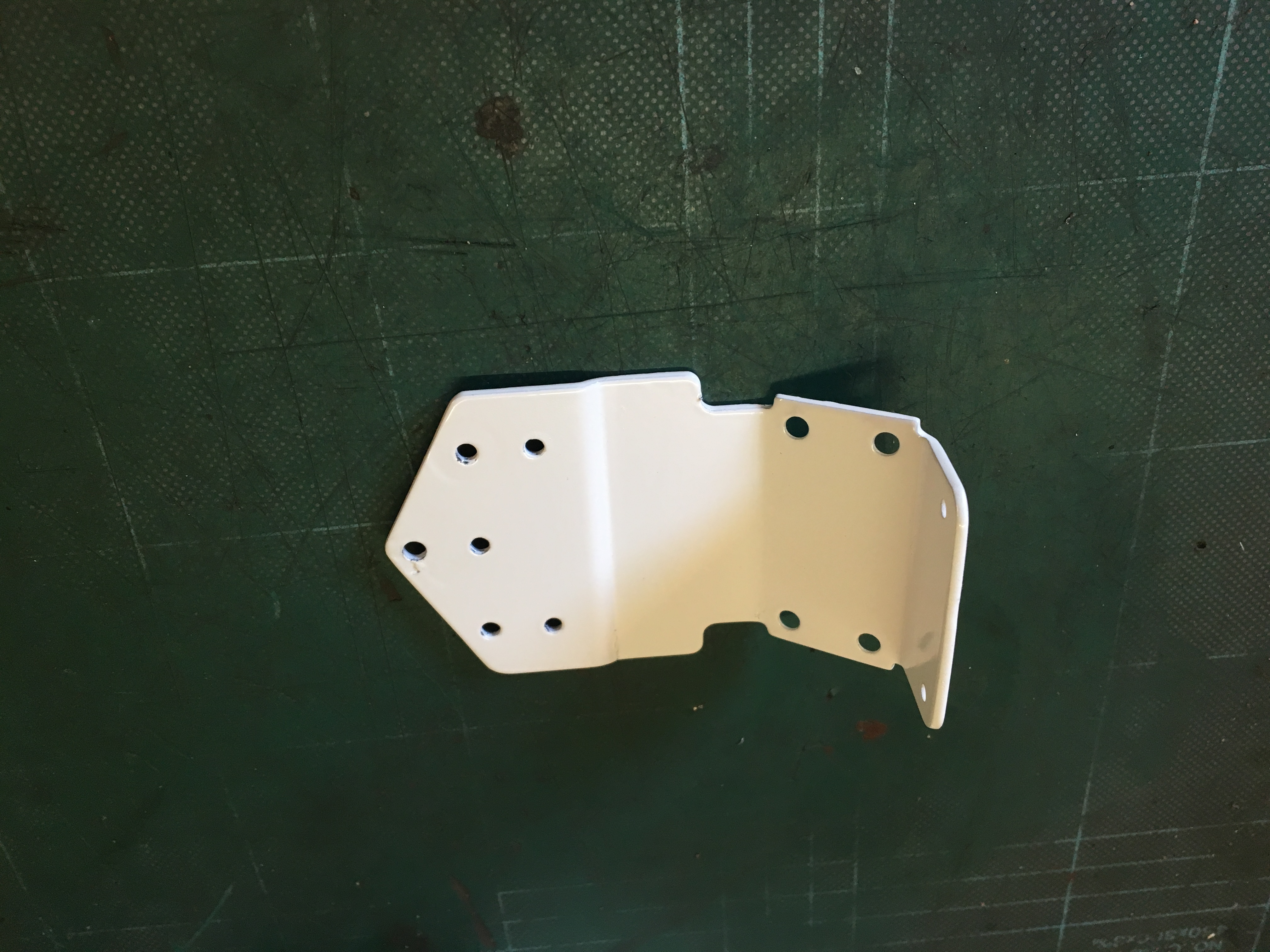

Headling
Posts: 545
Joined: Tue Dec 06, 2011 6:17 am
Location: Kent , UK
Has thanked: 25 times
Been thanked: 29 times
Post by Headling »
Nose plate powder coated to match the main chassis

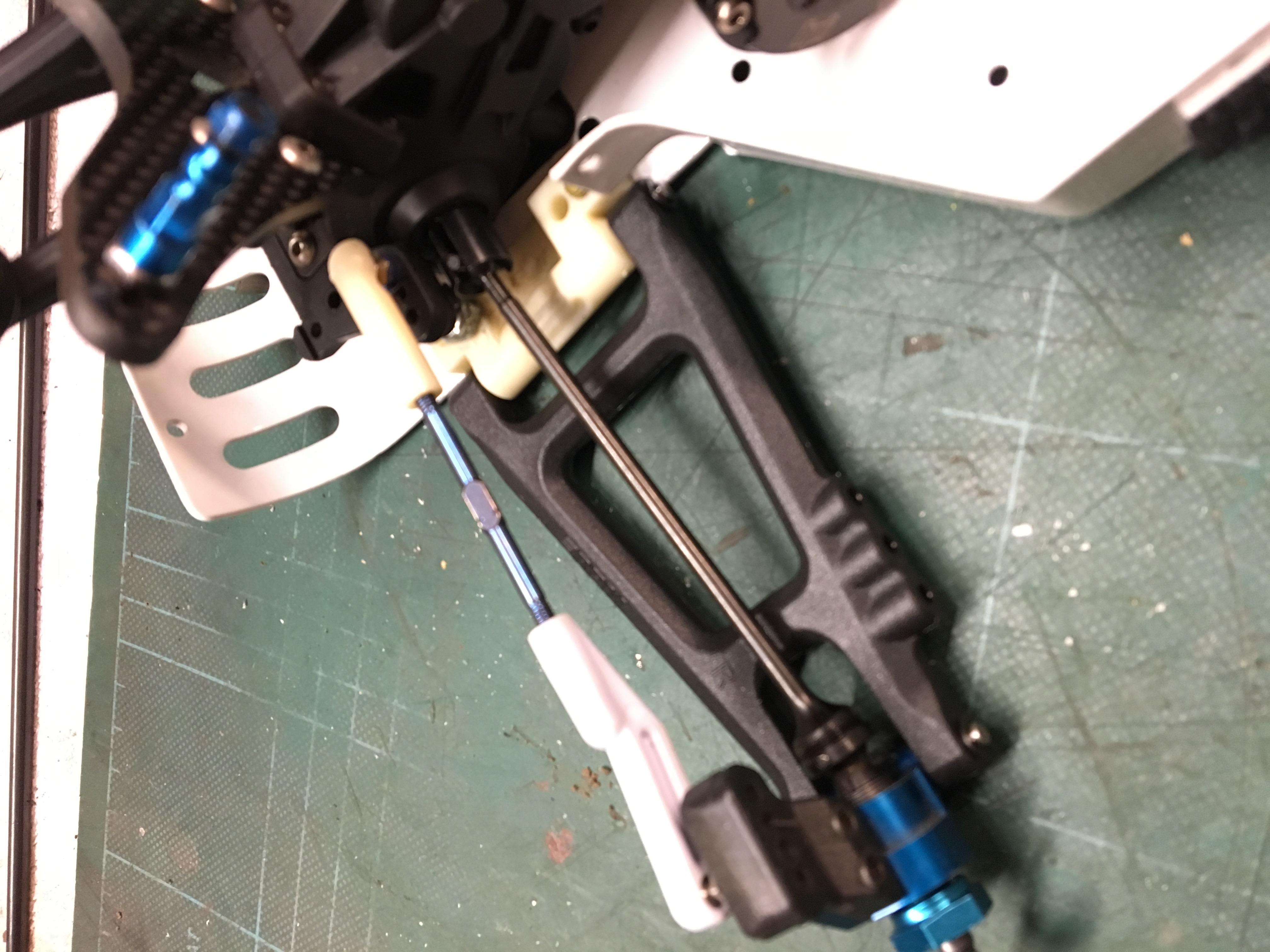

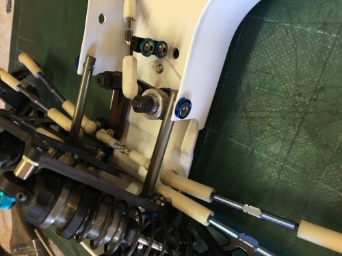

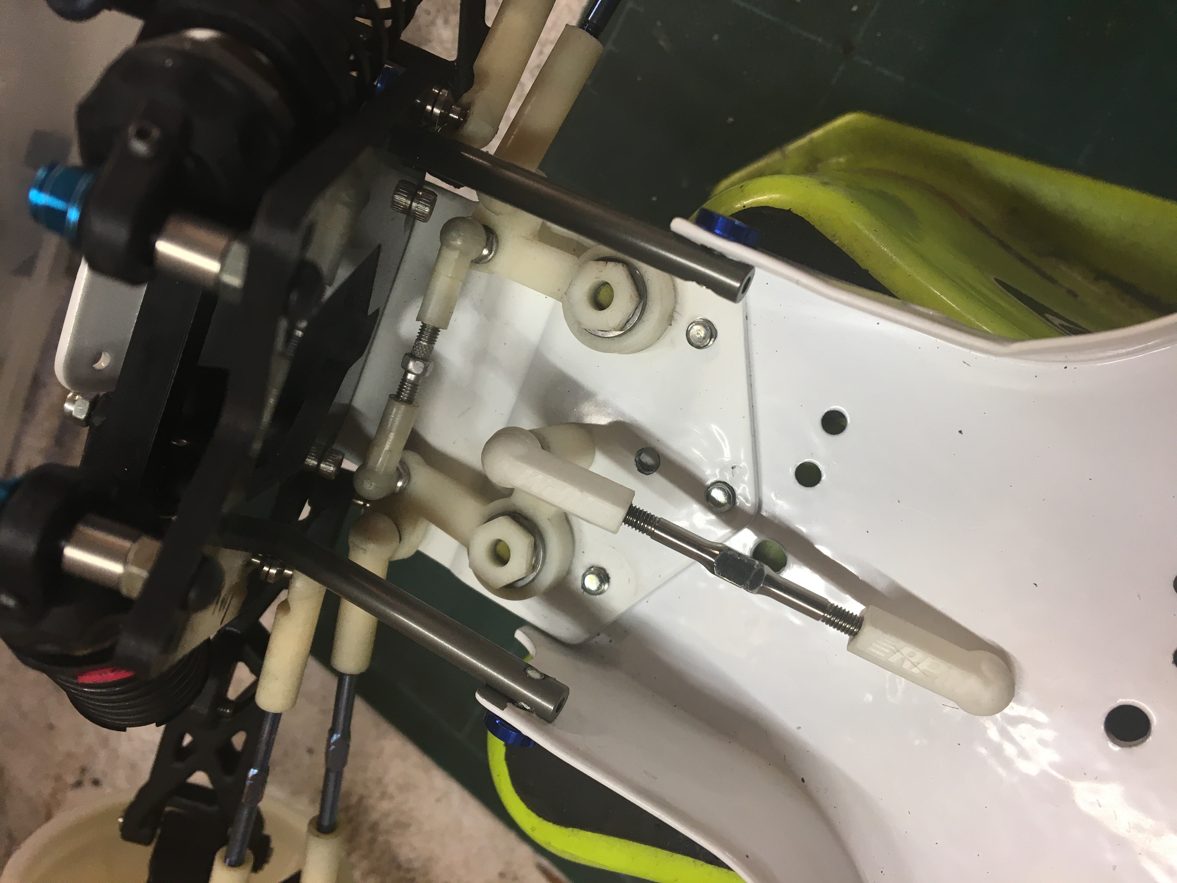

Quick question, any benefit of using buggy steering set up/Bell cranks over the truck ones??

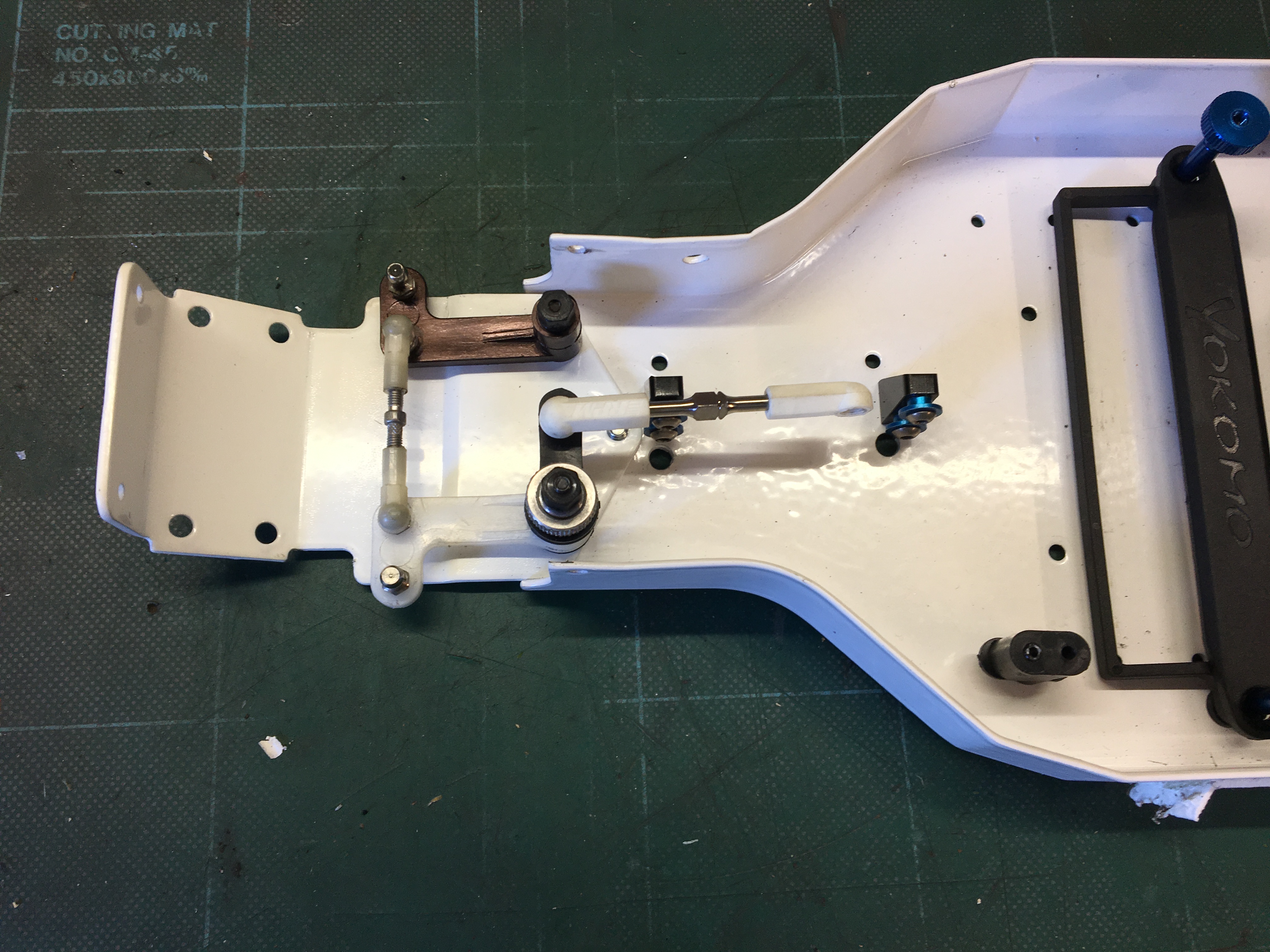

Headling
Posts: 545
Location: Kent , UK
Post by Headling »
Steering done, will get some dye and do it all black

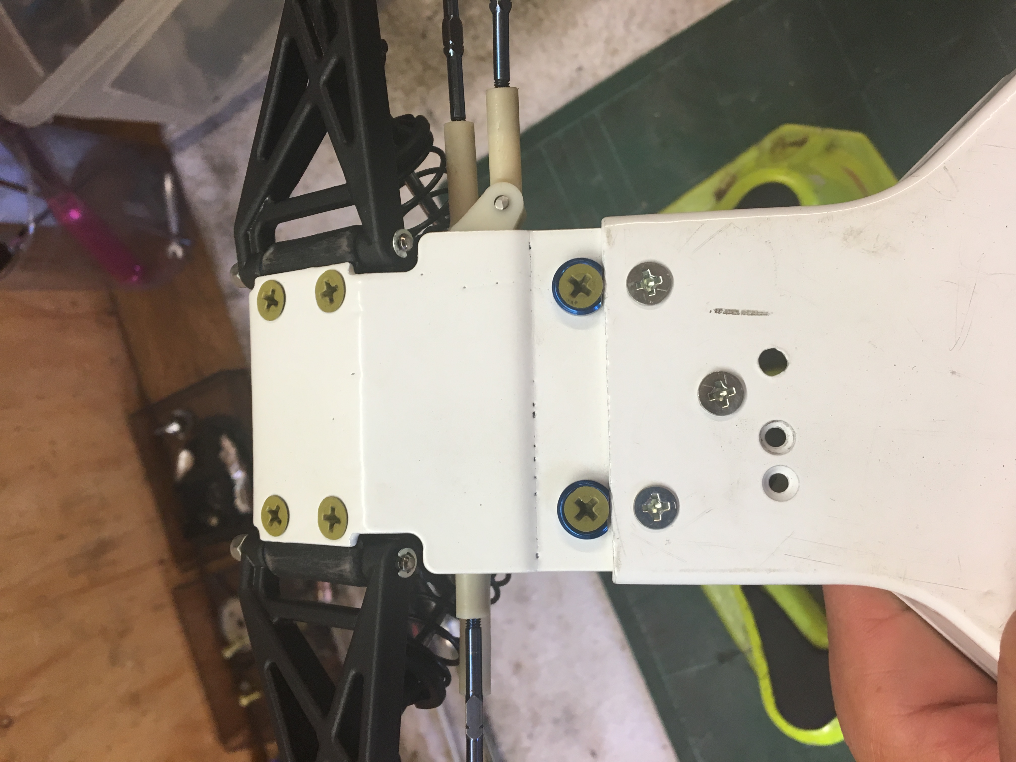

The front end is on!! :)

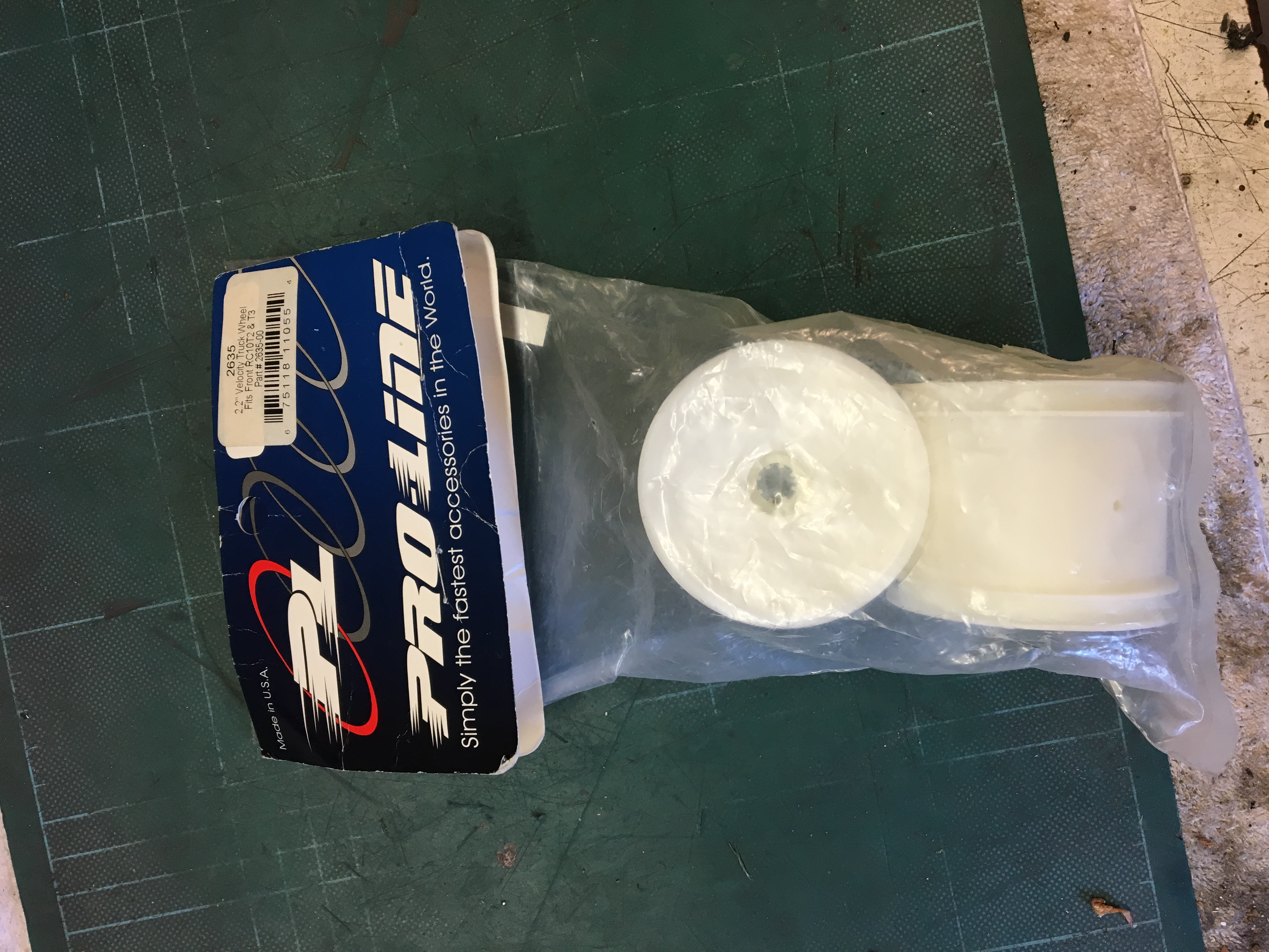

Found some NIP front proline T2 wheels

RC10th
Posts: 4705
Has thanked: 50 times
Been thanked: 1495 times
Post by RC10th »
Looking good, can't wait to see the finished results.

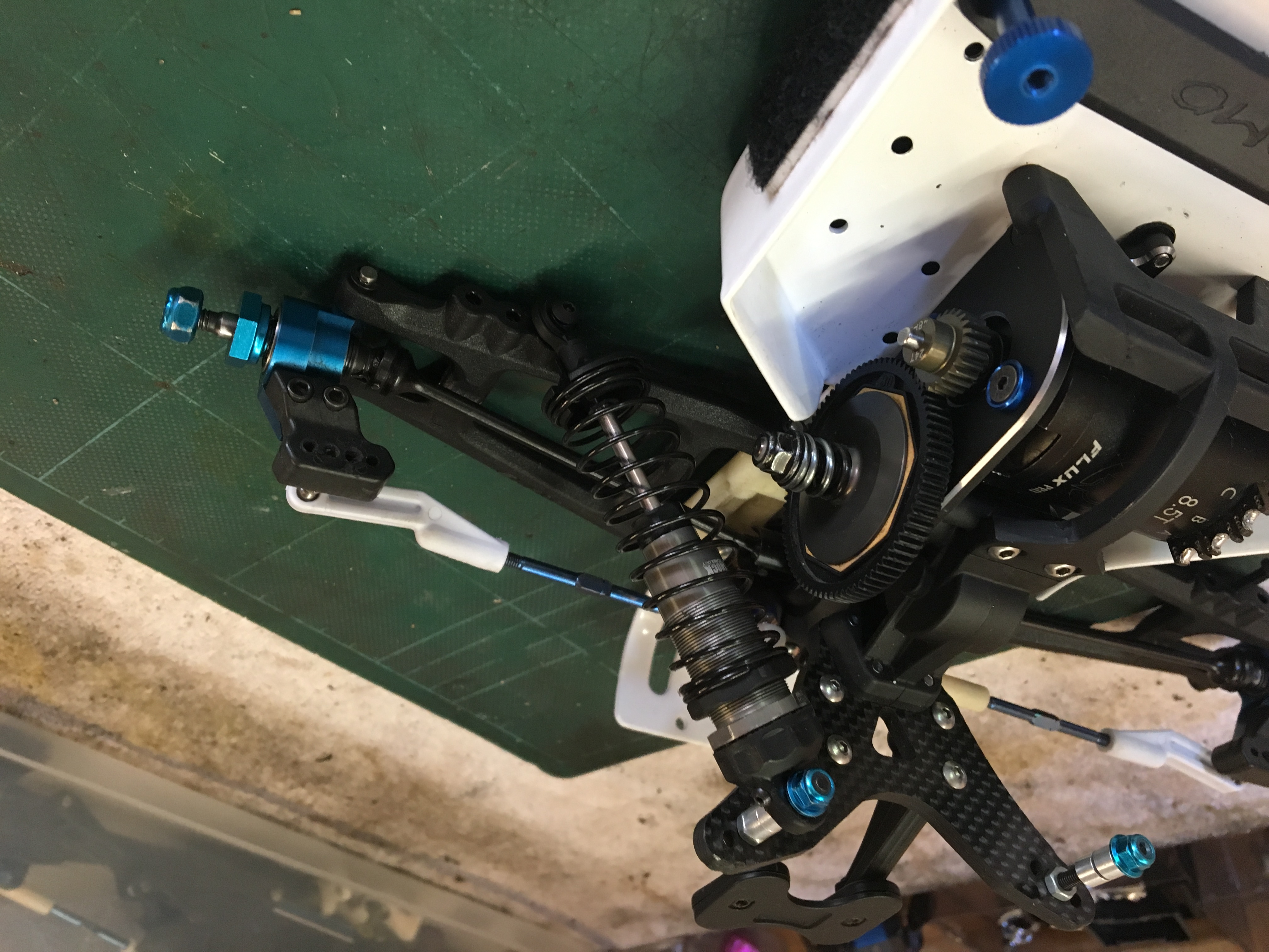

Ditch the 10T bellcranks, they are horrible on anything other than a shelfer. Use the worlds steering as it's much better, especially with bearings. Also, pick up some button head 8/32 screws to use for the steering and that will be one serious truck!!
Headling
Posts: 545
Location: Kent , UK
Post by Headling »
Thanks! Appreciate the input, will get the steering swapped over
Post by Headling »
As per the advice I’ve fitted the worlds steering set up now
Took the grinder to some CS washers so the Ali AE screws don’t take too much of a hammering
If in doubt go flat out!

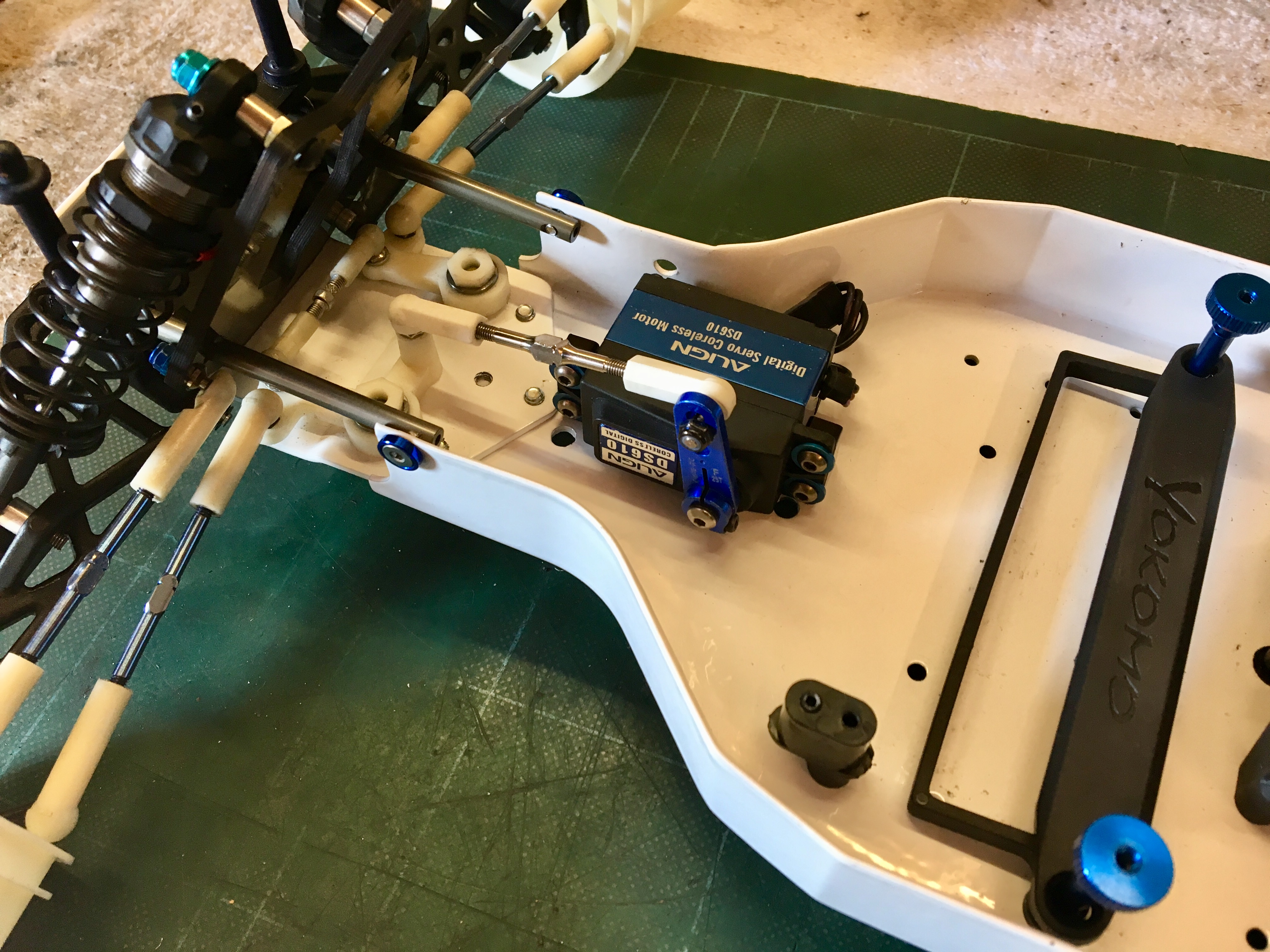

Servos in

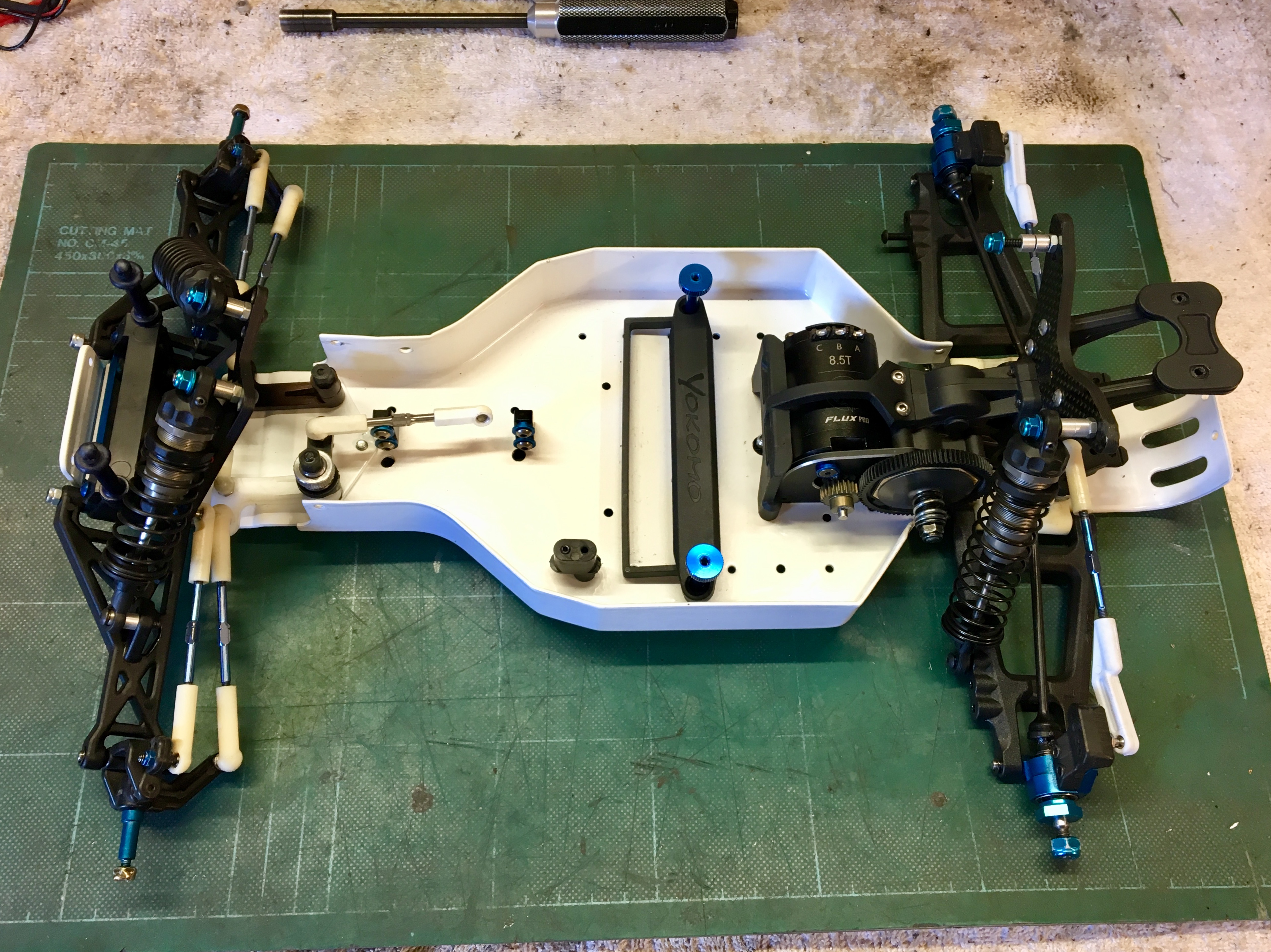

Post by Headling »

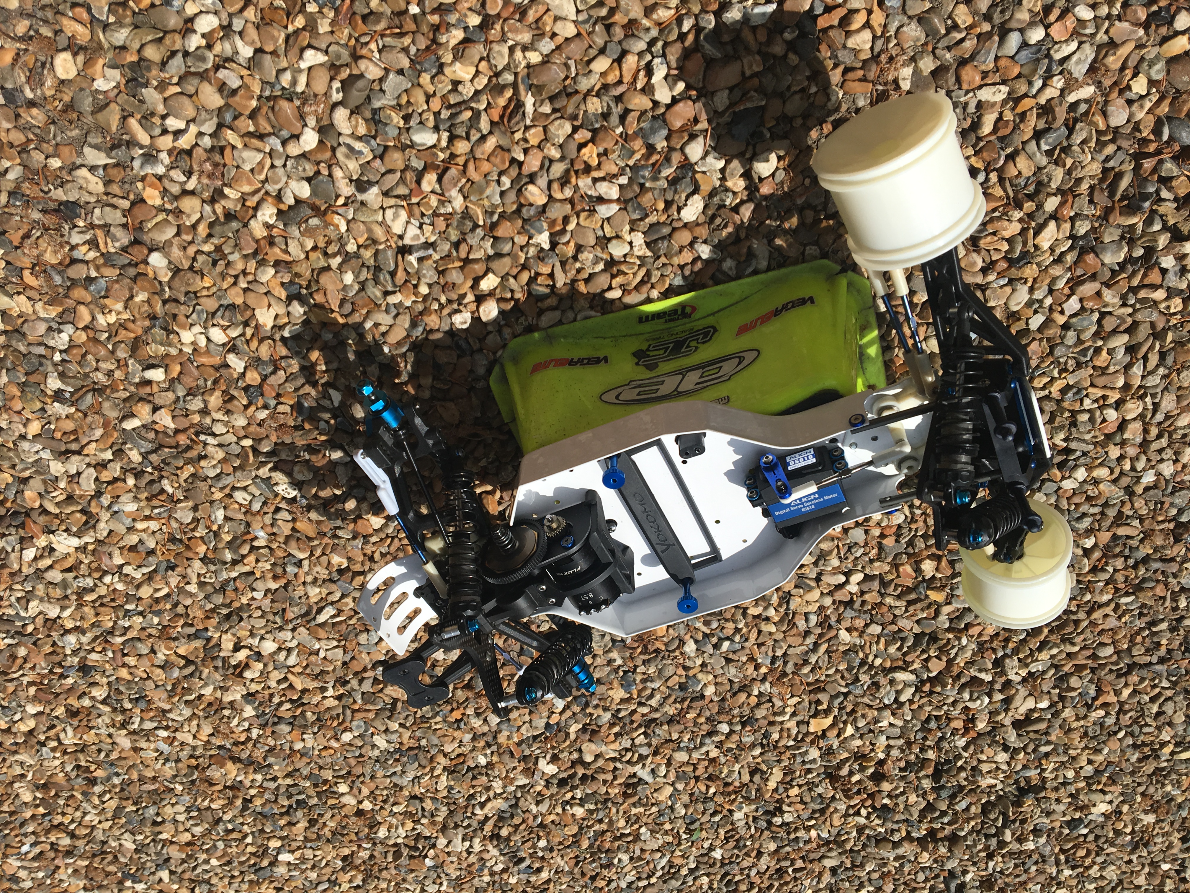

Got the parts to re build the rear shock so here is how she sits at the moment
Going to get the esc/rx in it this weekend and decide on a body for it, prob j concepts retro style one

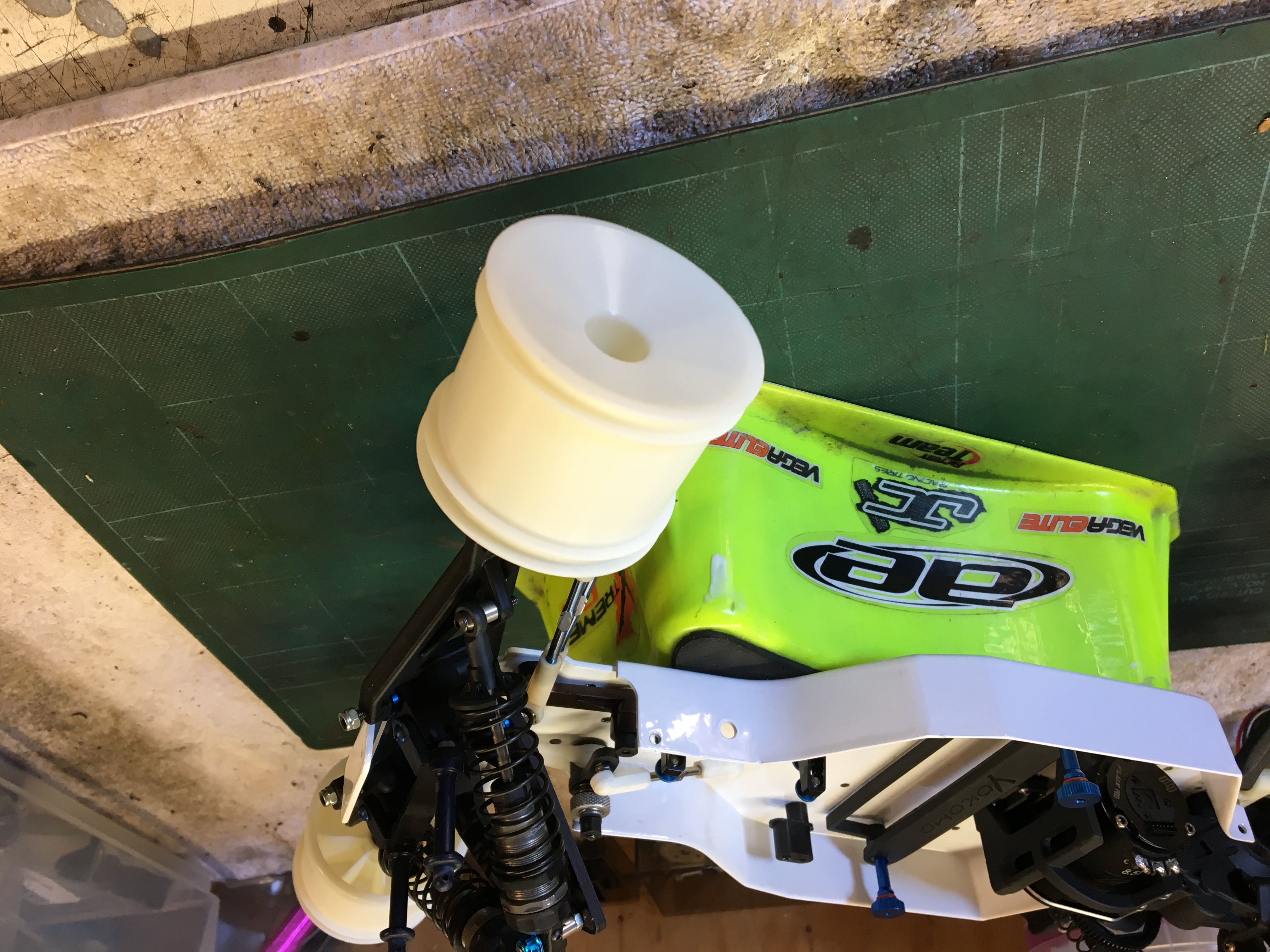

Headling
Posts: 545
Location: Kent , UK
Post by Headling »

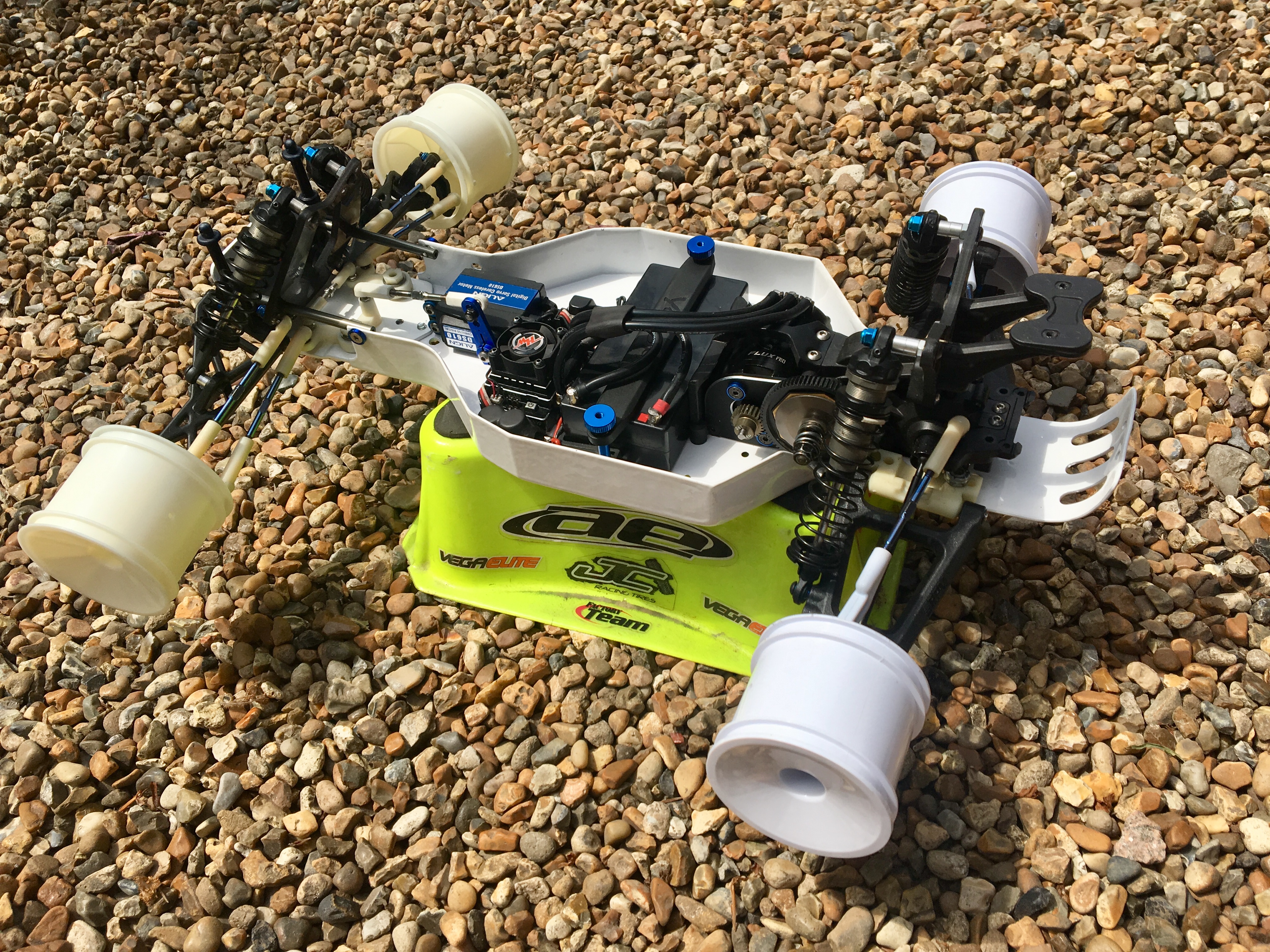

Got the soldering iron out this weekend, tyres and a body and we are in business!
