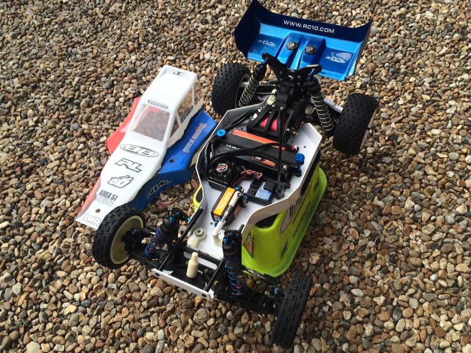

There is a build thread on here and pics/videos of this car on rc10 vintage mania and YouTube
It’s been out of action for a while and I’ve decided to convert it into a stadium truck
When it was finished:

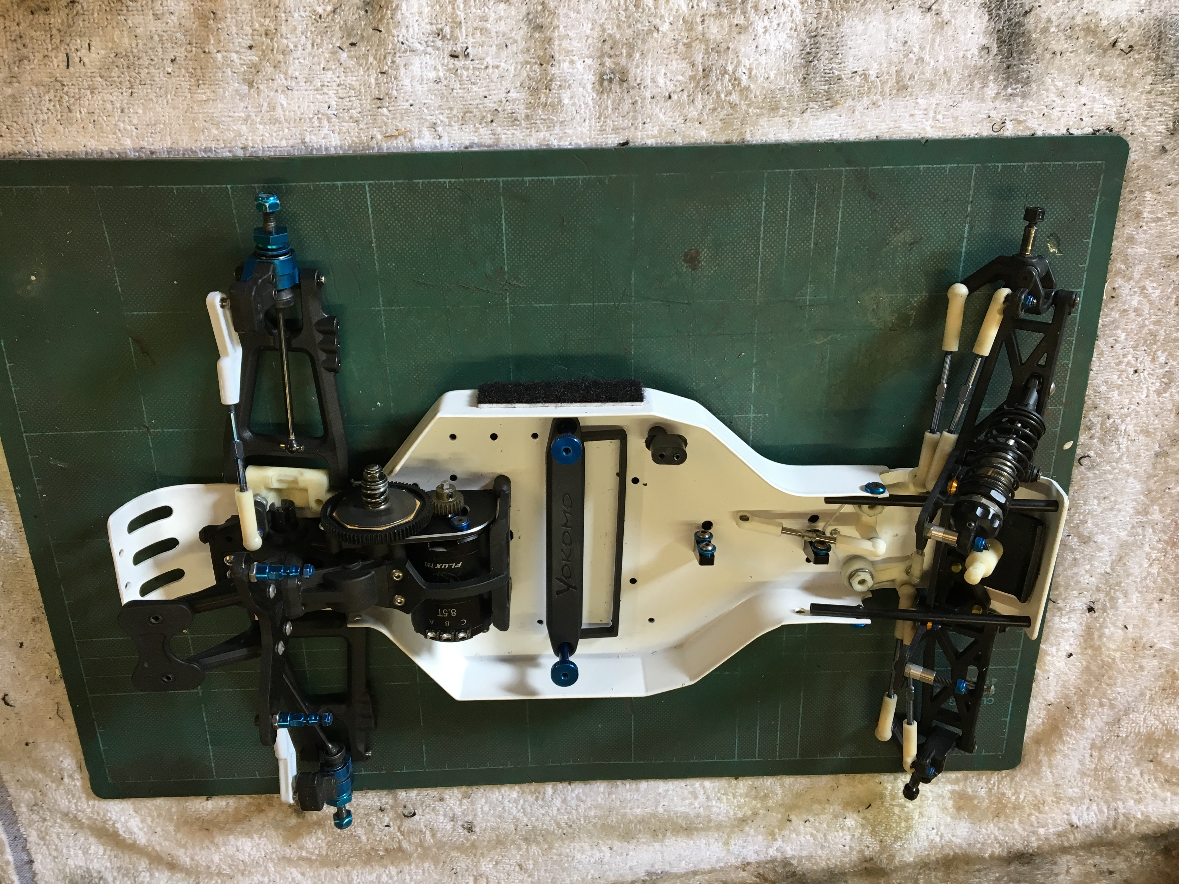

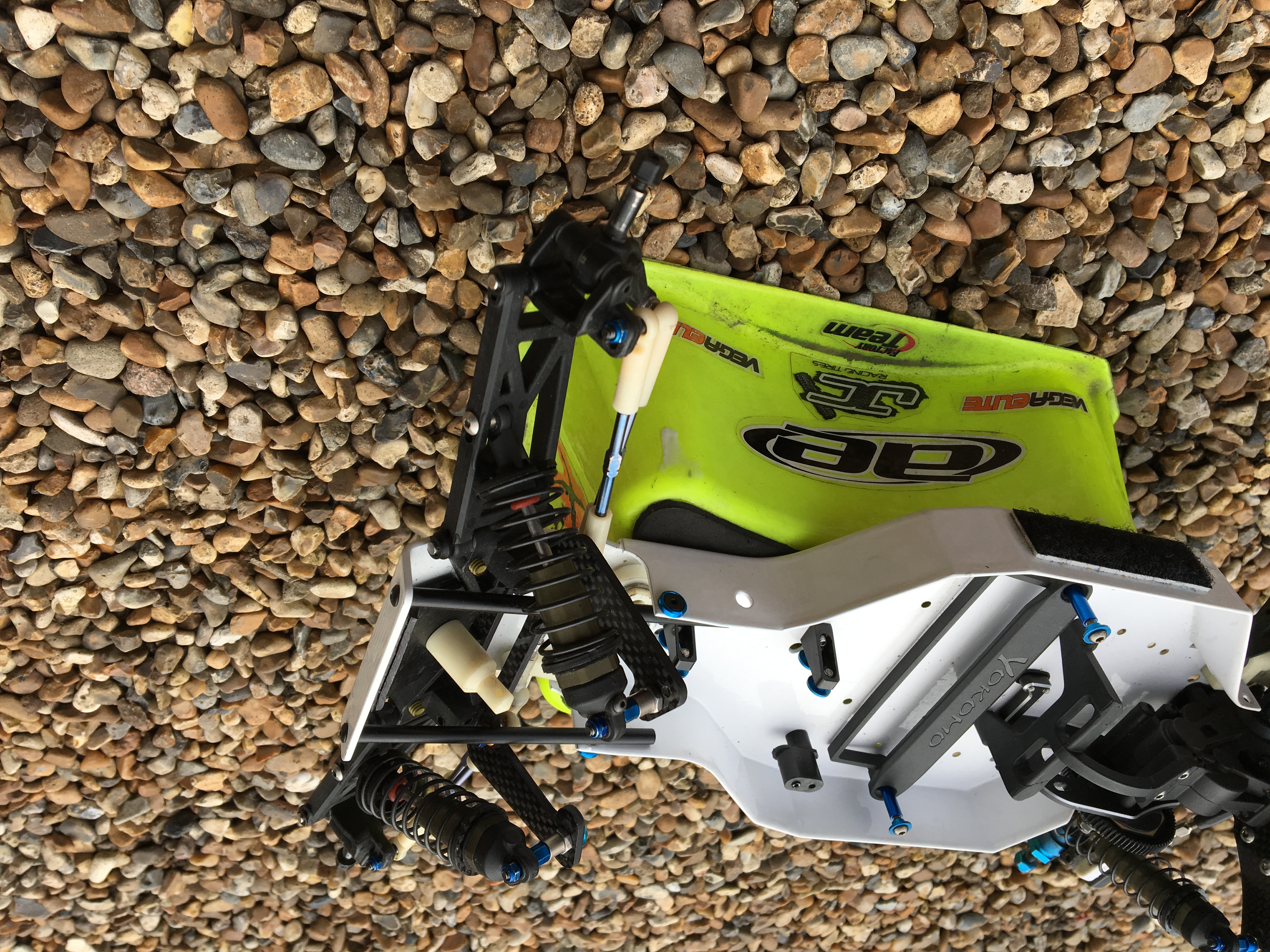

How the car is sat now after robbing some bits from it for my yz2

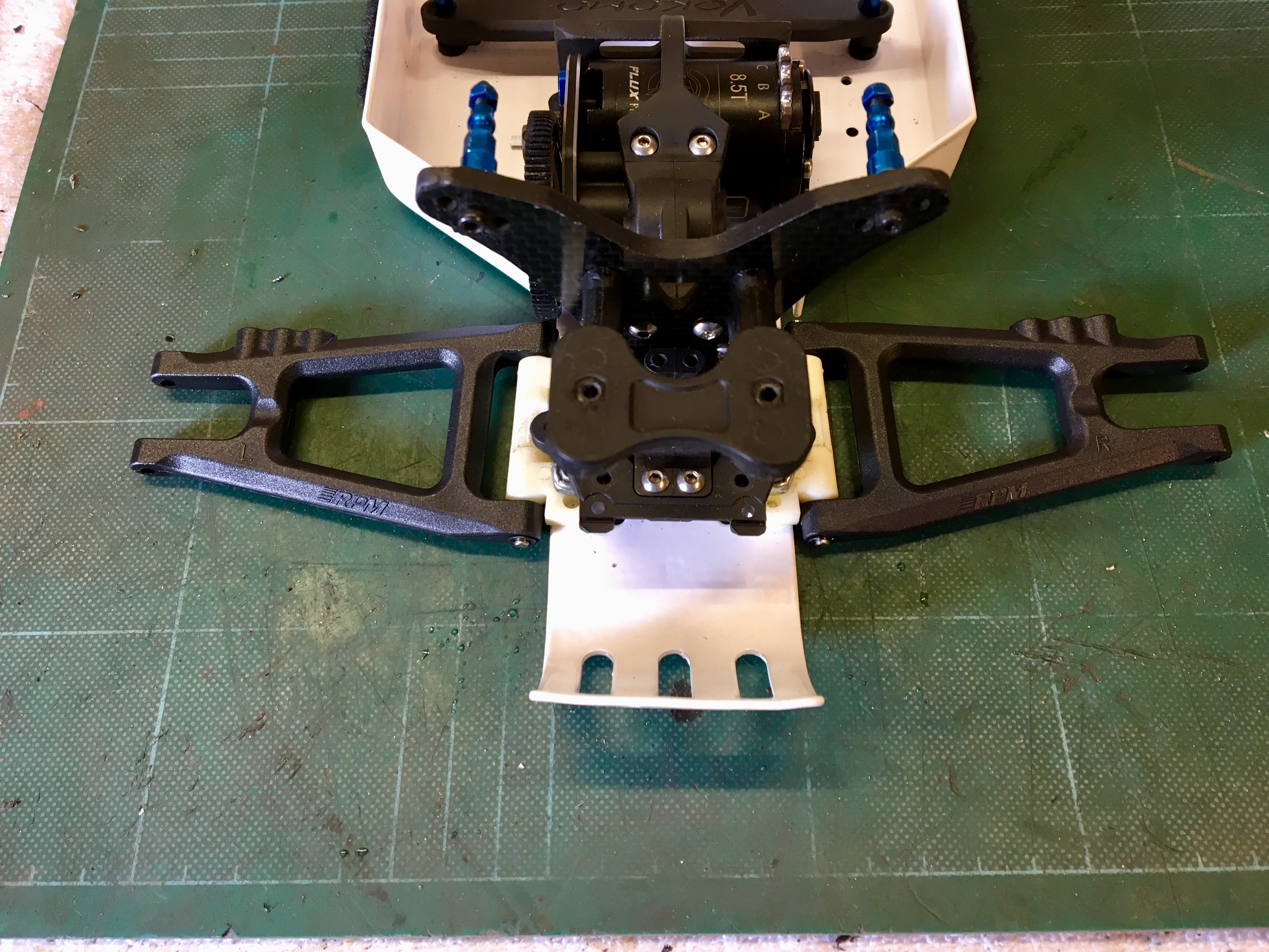

I snagged some rc10t rpm rear arms from eBay (rcmart) for £6.50 nip and I’ll try and find a 10t nose or convert it with modern arms etc, we shall see....

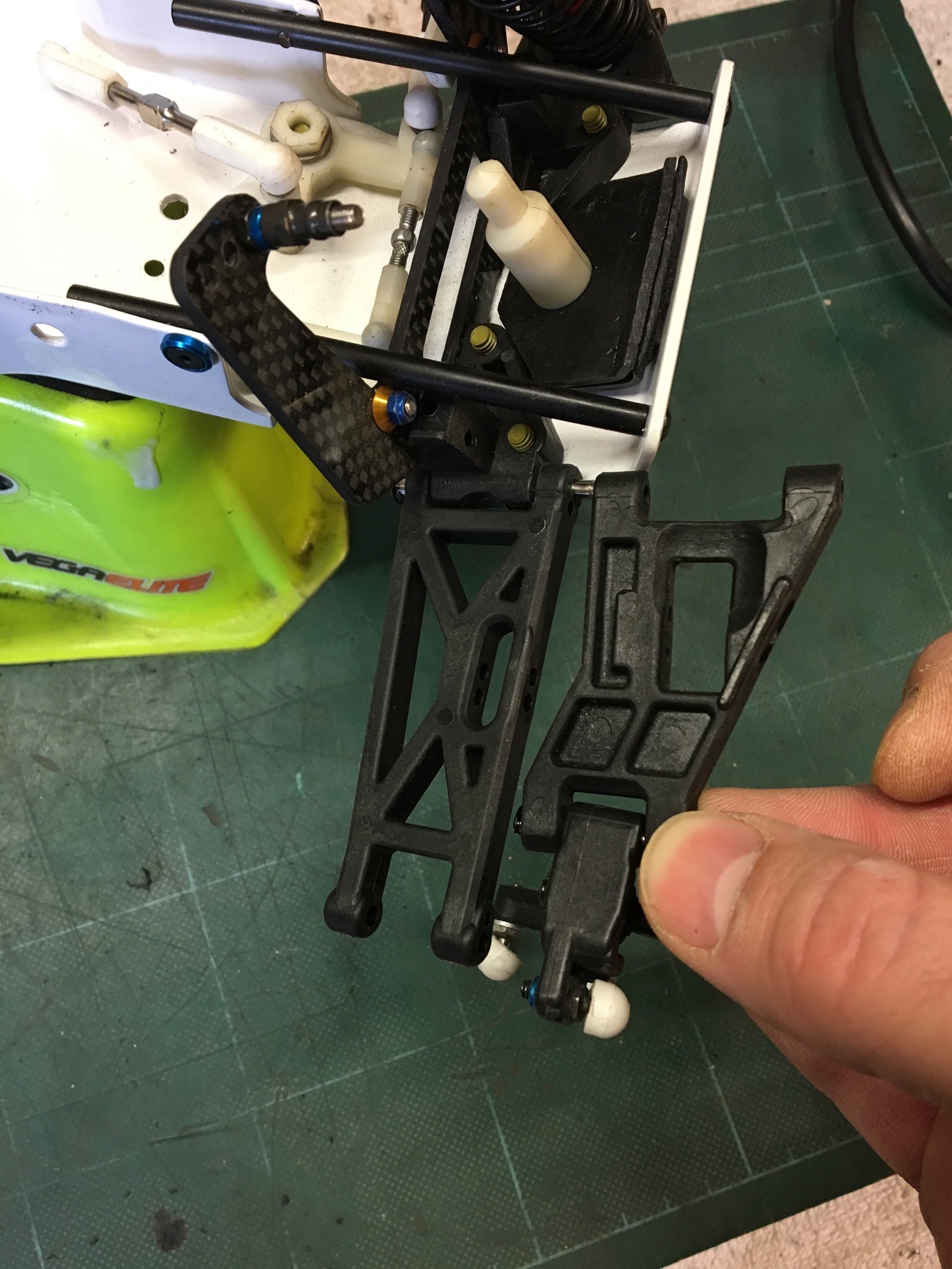

Will need to check the width once I get some wheels but trying Kyosho rb5 front arms on it

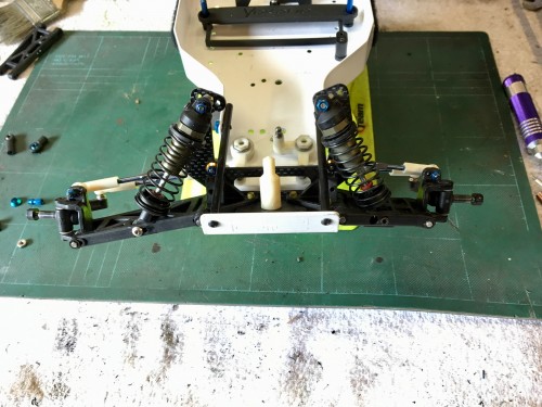

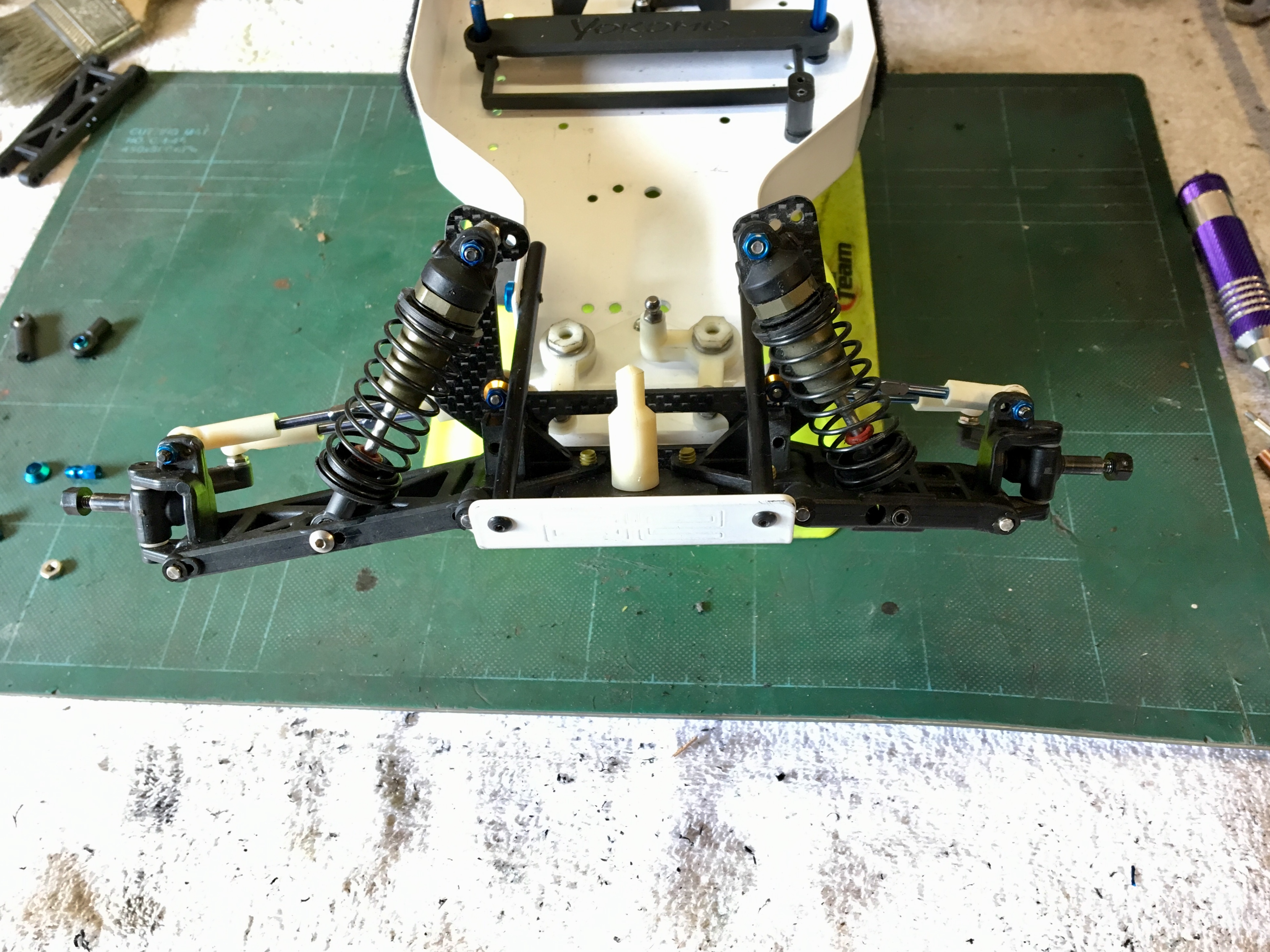

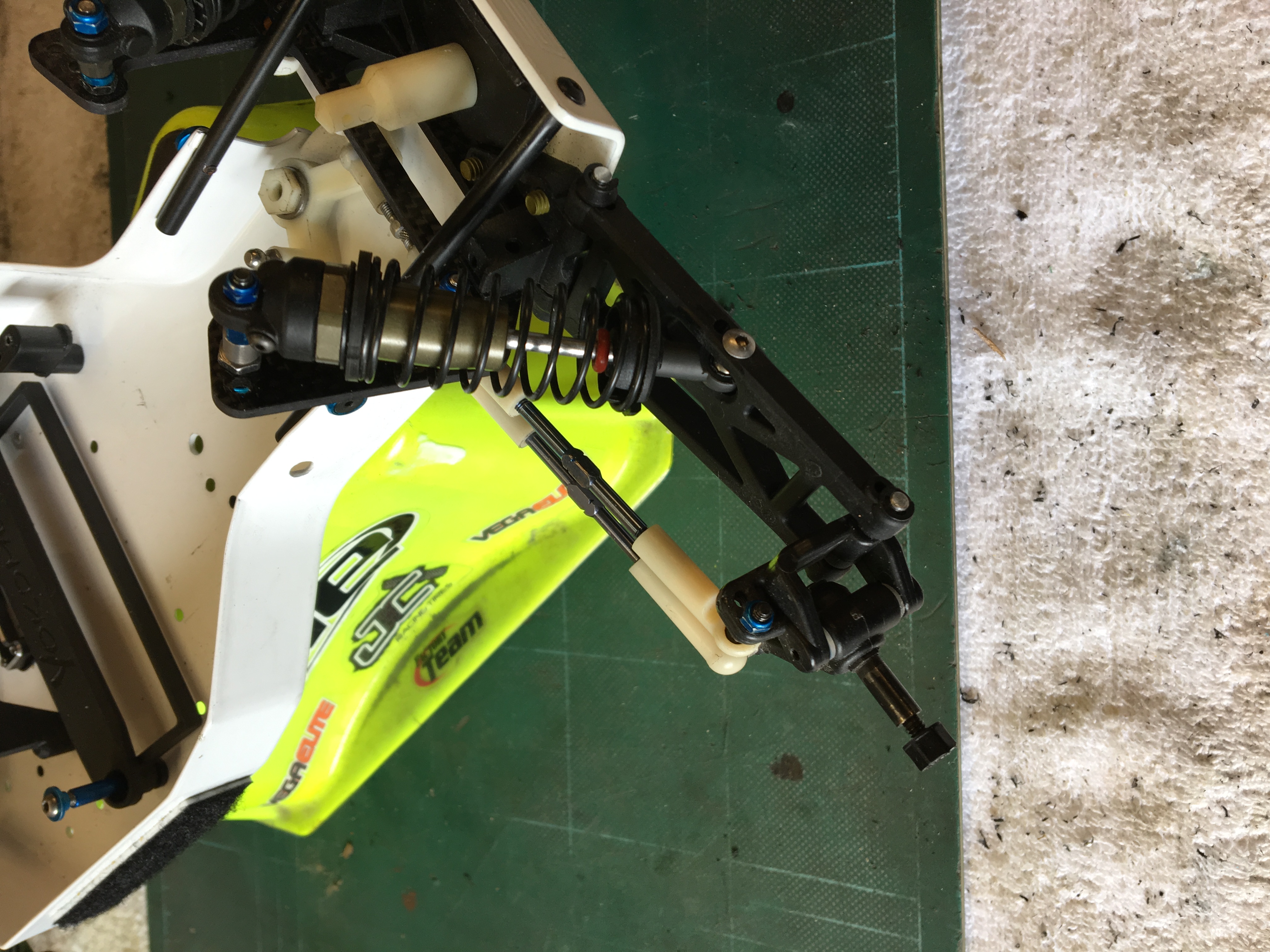

Made some progress today, with a bit of dremel work the rb5 arms went on, drilled them out to 3.2mm so I can use rc10 hinge pins
Spaced the shocks forward at the top so they are well aligned with the arm/tower
Found some losi ball cups which are a bit longer than AE ones so they have gone on with b4 turnbuckles

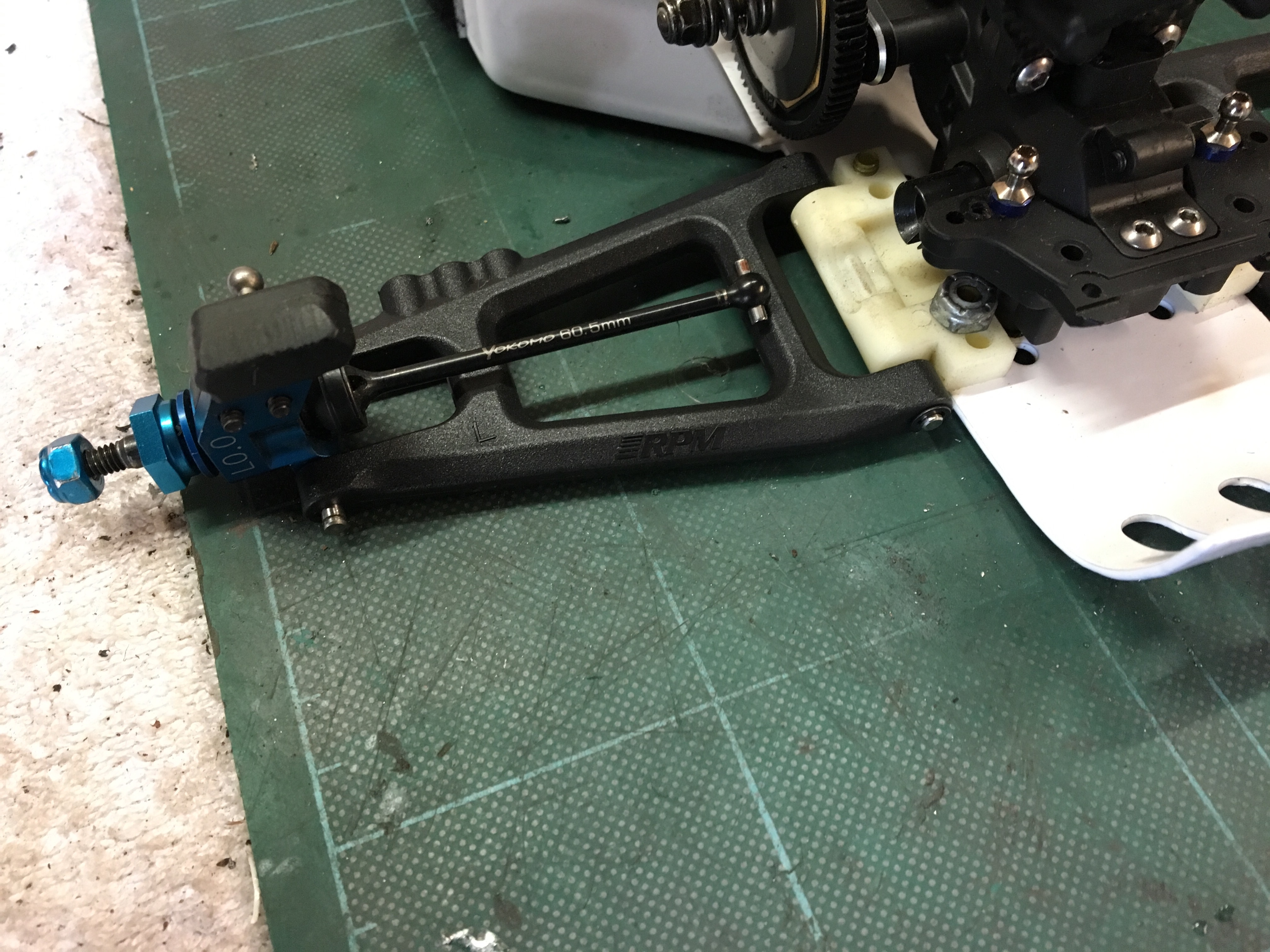

Alloy b4.1 hubs mounted up, now the driveshaft issue to overcome!!
They need to be around 90mm long (cvd bone) any suggestions welcome!

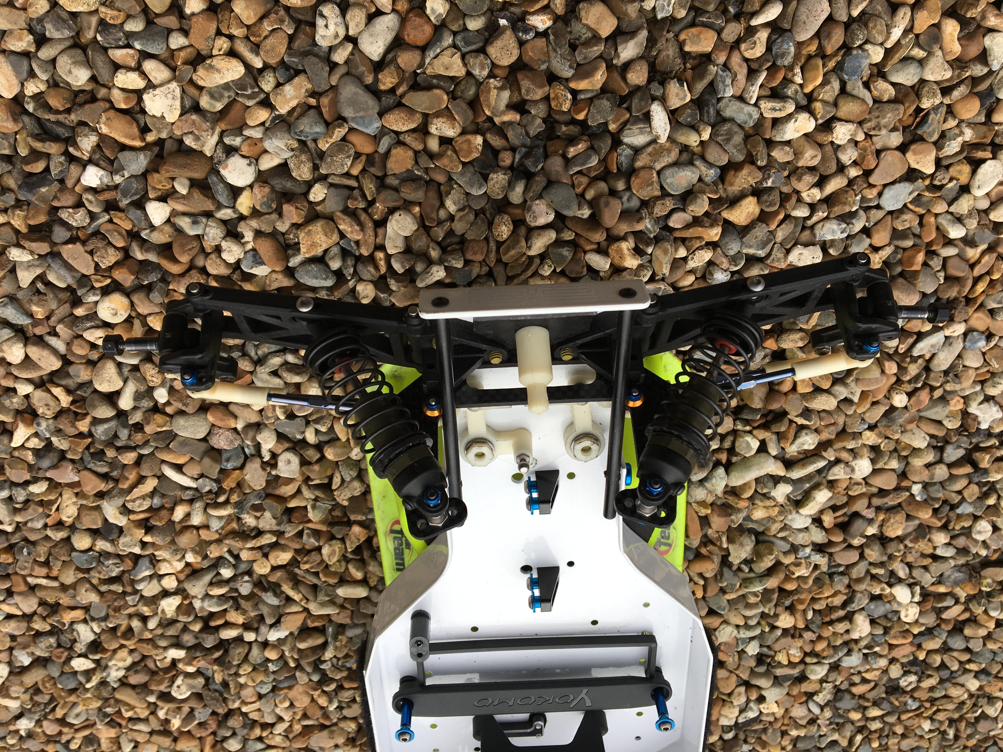

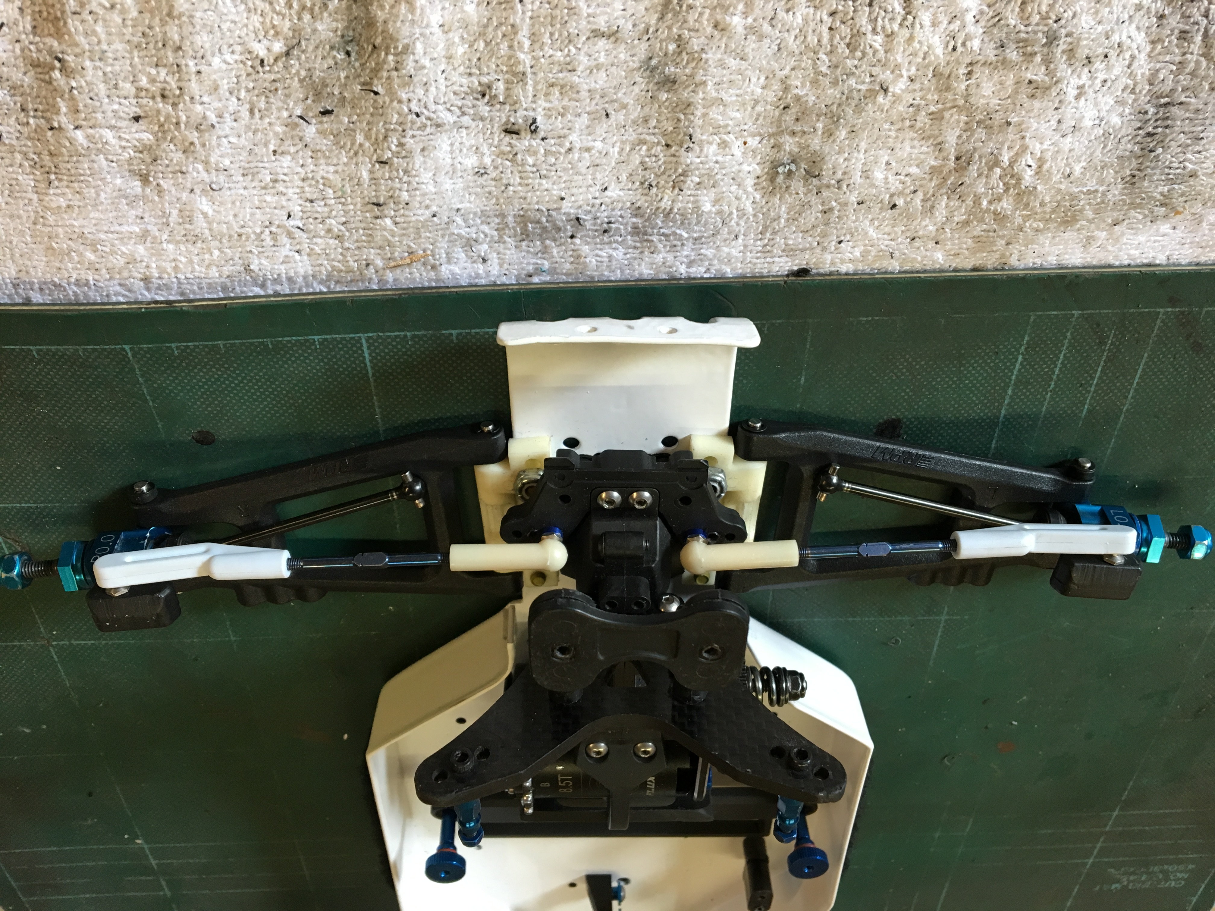

Turnbuckles sorted, bit of Jconcepts and losi
Not sorted the front end yet as my rb5 arms aren’t giving me full lock, would love a rc10t front end but not found anything yet

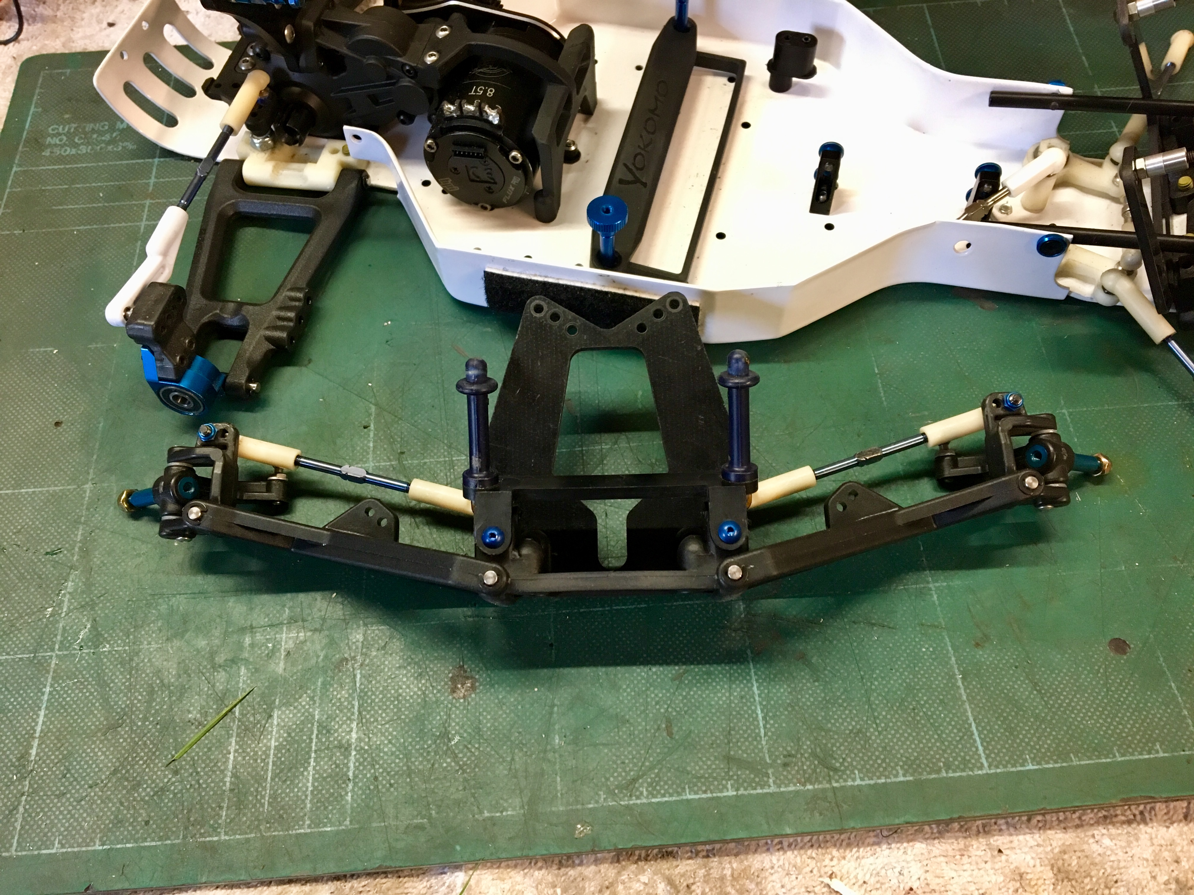

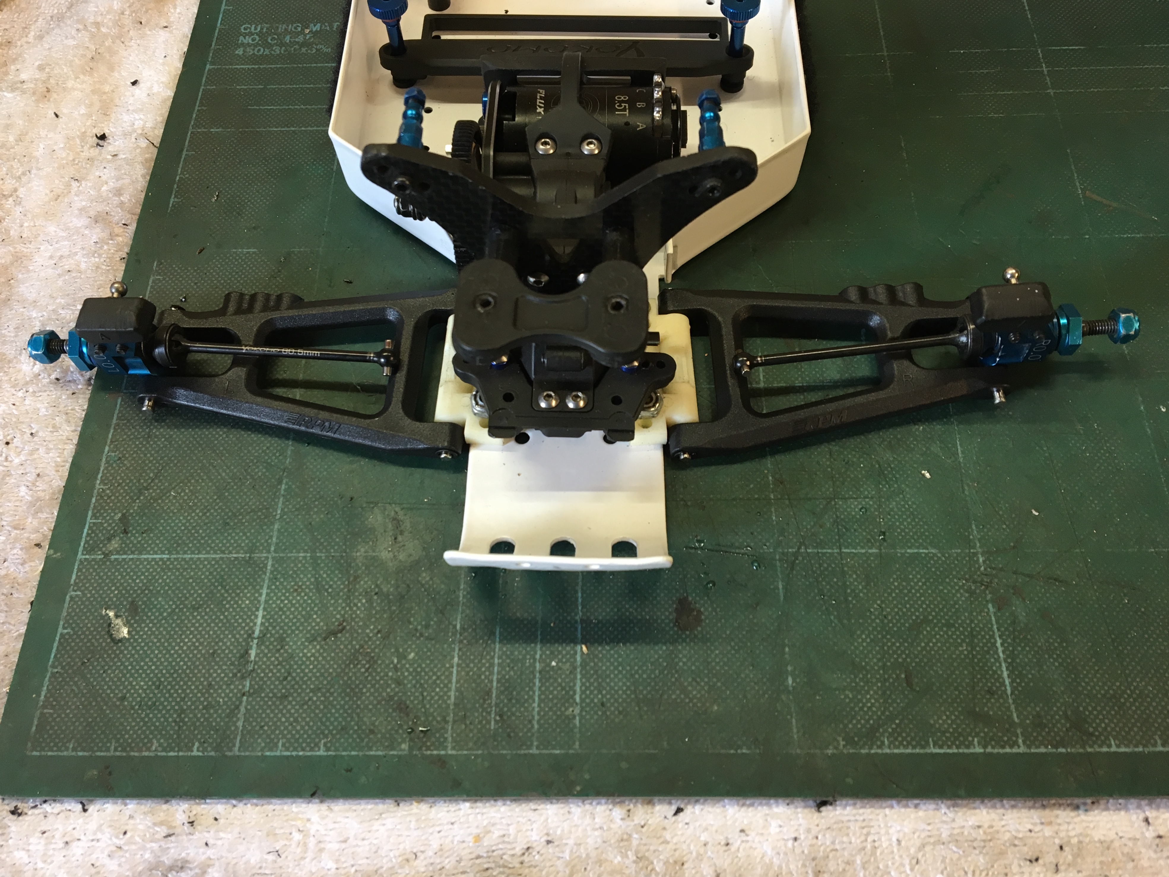

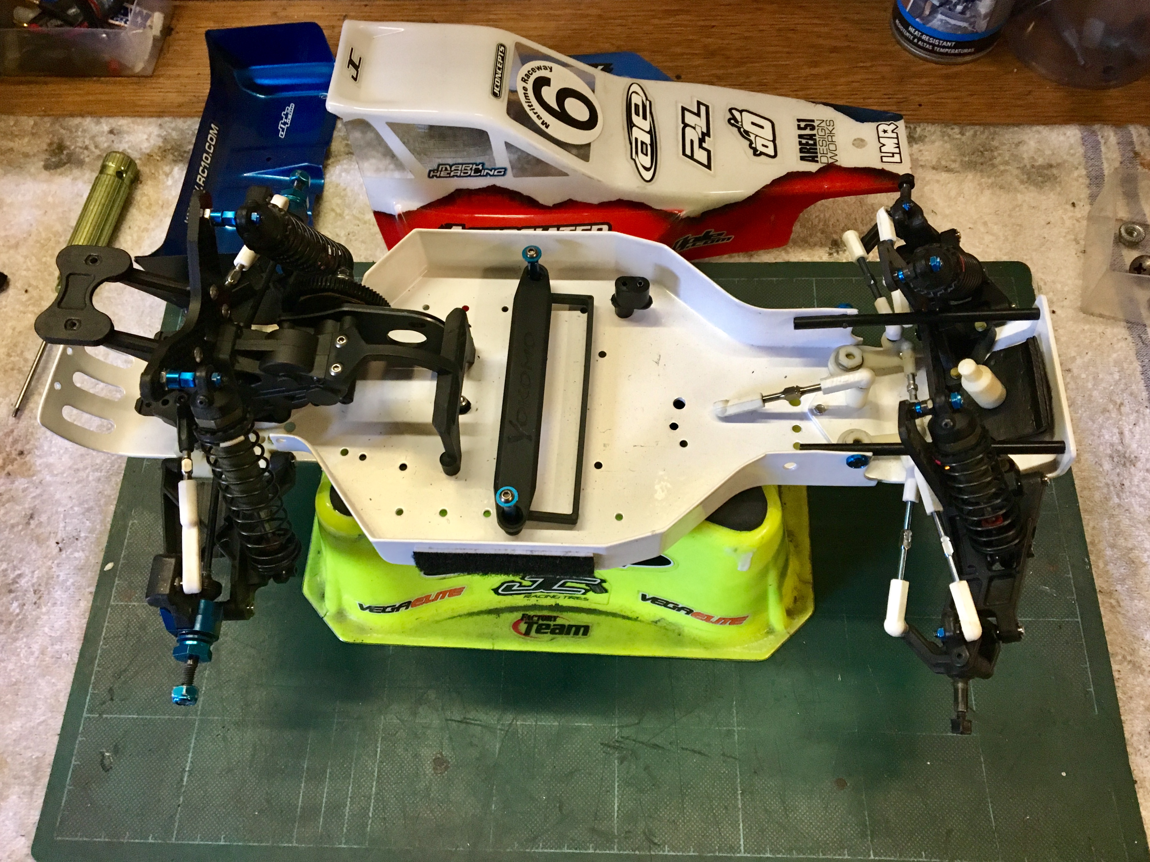

Well my front end didn’t work using the rb5 front arms
So to move the project forward I found this lot on eBay USA and it arrived today to the Uk
I’ll clean up all the parts and get them vapour blaster and powder coated white then the build will commence!

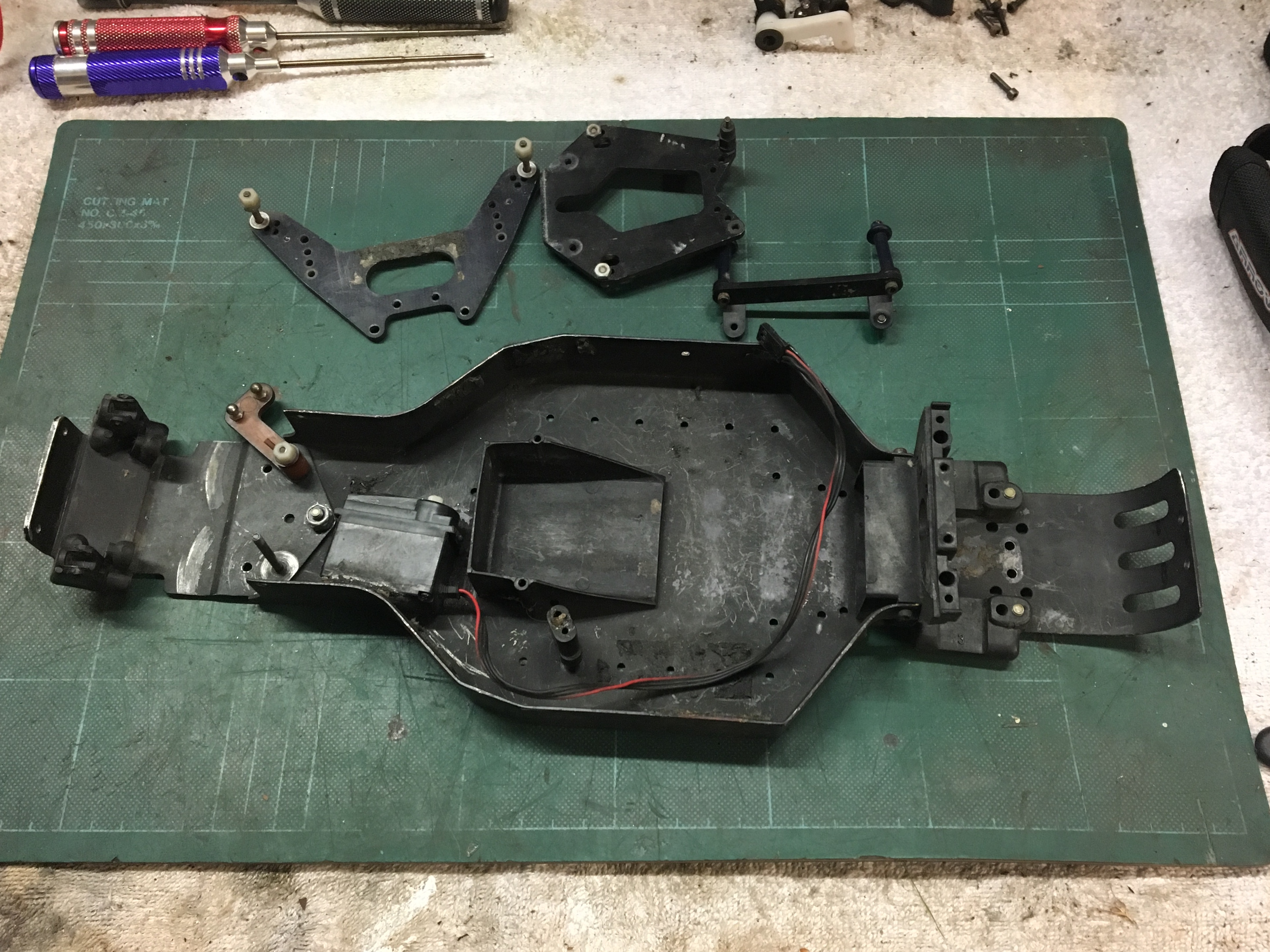

Cleaned up all the old 10t parts and made a start!
I’ll drop the nose off for powder coat next week
