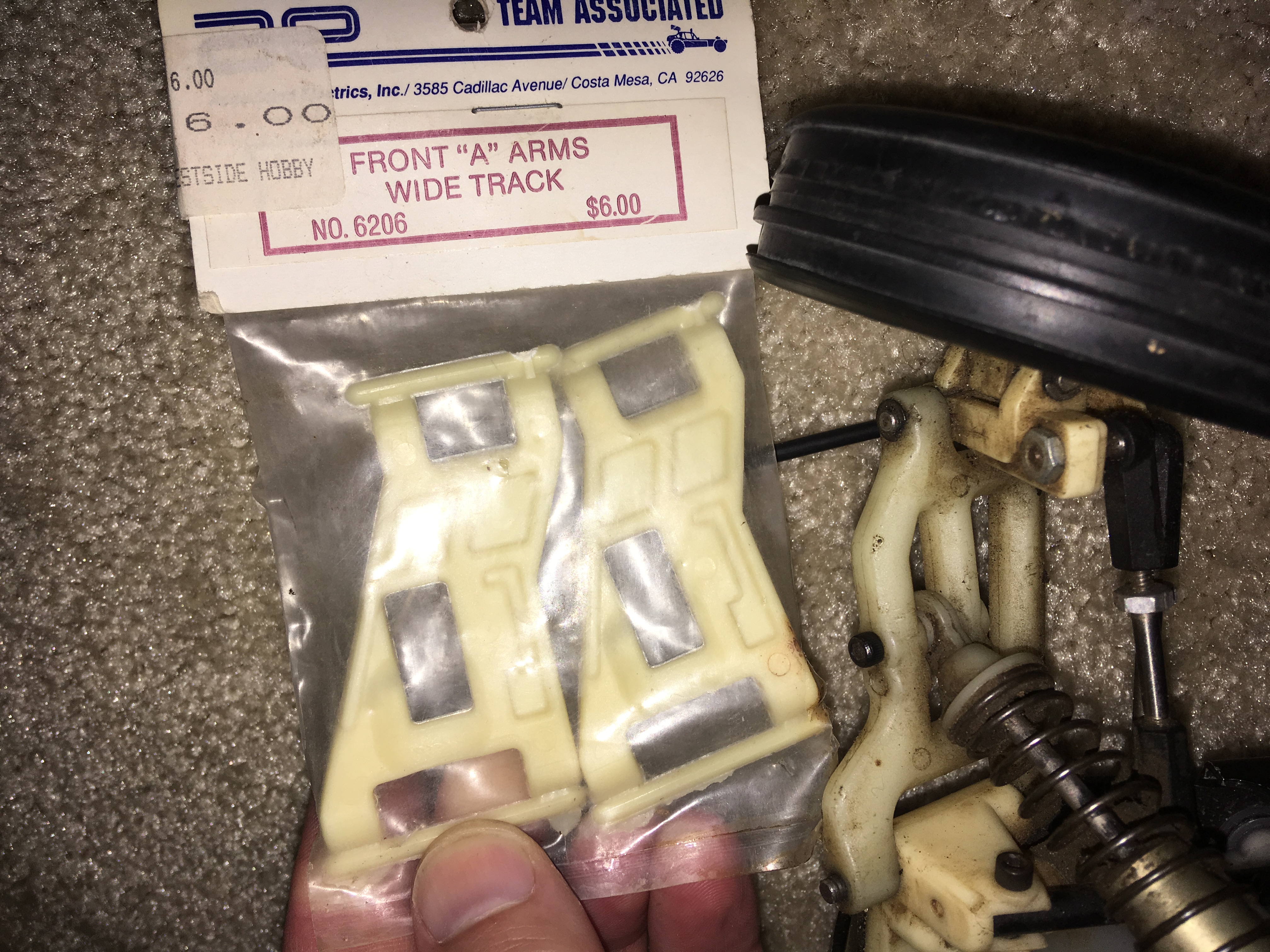

jwscab wrote: Sun Jun 03, 2018 10:20 pm Your particular car however looking at the picture has been modified for rpm 'worlds' arms. They are no longer available, but you can find replacements but they won't look the same.
By arms are you referring to a -arms? Are the front packaged arms in the pic correct for rc10? What would the benefit of changing the arms be? Would it be w something old and stock off ebay or an updated part?

Sparky27 wrote: Mon Jun 04, 2018 9:09 am
The front arms in the package you are showing are the "original" arms for the Stealth car.
What you have on both the front and rear end of your buggy are RPM front arms. The best way I can explain it is to refer you to this thread:
https://www.rc10talk.com/viewtopic.php?f=35&t=27885&p=285443&hilit=rpm+team+wide+dynotech#p285443
I wouldn't put the stock NIP bags on your car because you have a narrow front truck bulkhead now, and the overall track would be too narrow.

you have a complete rpm worlds conversion on the buggy,
here is more information:
https://www.rc10talk.com/viewtopic.php?f=82&t=29496&p=305526&hilit=rpm+worlds#p305526
https://www.rc10talk.com/viewtopic.php?f=80&t=8227&p=78079&hilit=rpm+worlds#p78079
these are harder to find parts now, so there is some worth in them, depending on how worn out they are. Even better as a nostalgia and collector piece. What I was saying is if you run them and break them, you can actually still get replacements, but not like the originals, because RPM no longer makes them.
