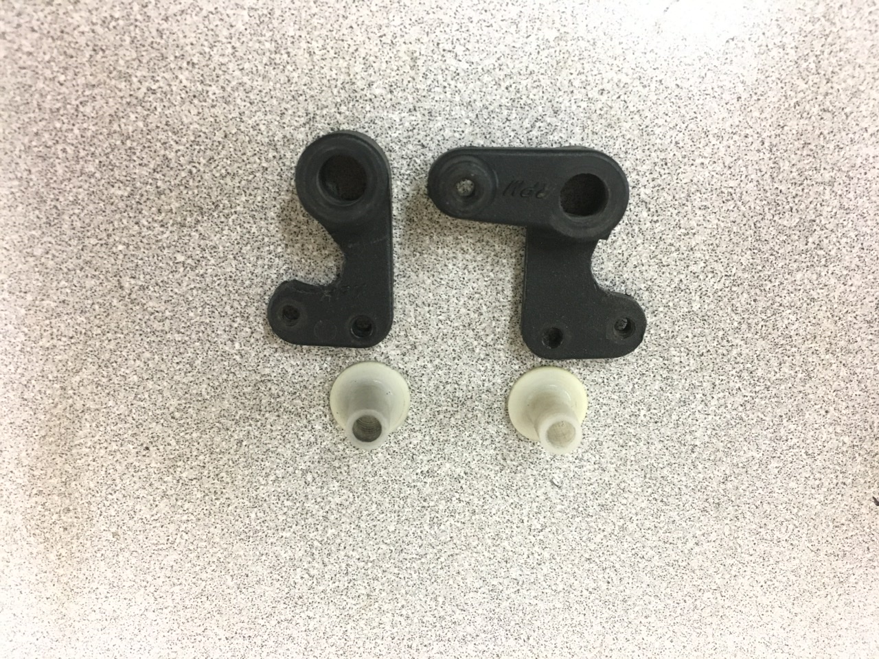

orangemazda
Posts: 711
Joined: Sun Apr 15, 2012 11:20 pm
Location: Bellingham, Wa
Has thanked: 14 times
Been thanked: 60 times
Re: RPM rc10 vs rc10t enhanced steering kit
Post by orangemazda »
Is this the set you’re looking for?
Posts: 16810
He wants the castor blocks and knuckles.

orangemazda wrote: Fri Nov 13, 2020 12:58 am Is this the set you’re looking for?
I have this in my box but not sure if it’s for rc10/rc10t/rc10t2. Any ideas?
Posts: 16810
Bholzz wrote: Sat Apr 06, 2024 9:54 pm
It was made for the rc10 buggy at the time. But with the proper screws it can be used on the T2. In order to use them on a 10t, they would need to be mounted in the short wheelbase position on the nose plate.
