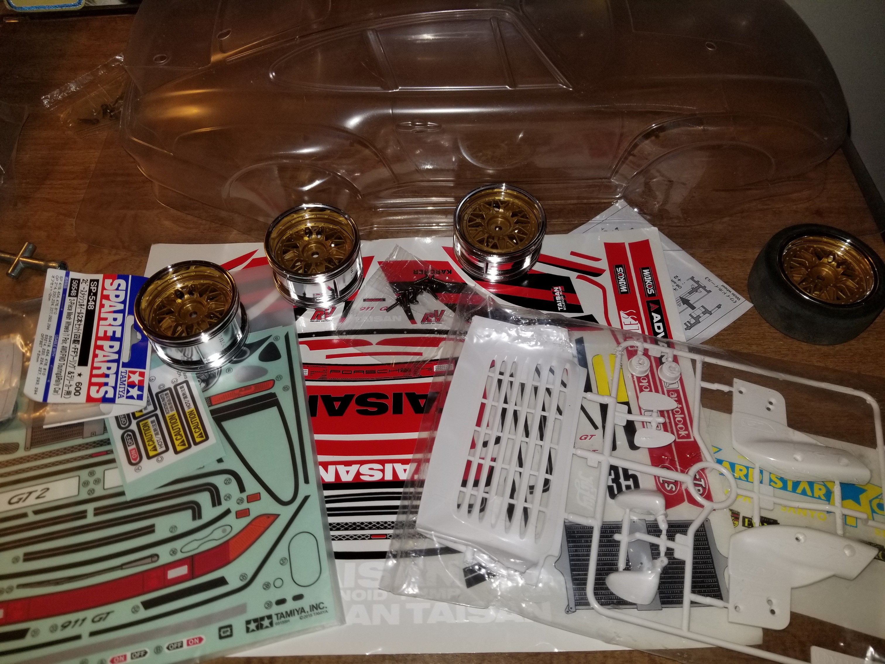

Nice cars! I found a carbon TA02 chassis FS, but there is no price..just says make me an offer. My rear body mounts don't line up with the gt2 holes. Would you happen to know if there are different rear mounts Could use? I flipped the to the other side but they aren't very stable.

Those are the full set of body mounts that came with the 03 series of cars, and I can confirm that they were supplied at least with the 03F-S, so should fit the 03R-S. Most likely, if you have the bent mounts on the rear and the holes don't line up, then the long straight ones should. You should be able to get a pretty good idea by mounting the bodyshell on just the front mounts, and looking down through the rear mounting holes - if the holes line up with just in front of the rear shock tower, you'll be good to go.

Thanks. I only have the straight ones. I think I need the bent ones.
