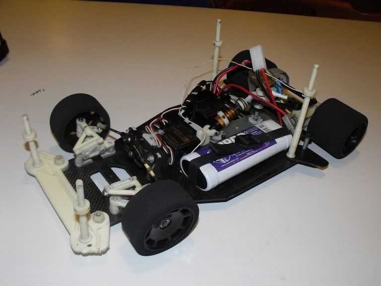

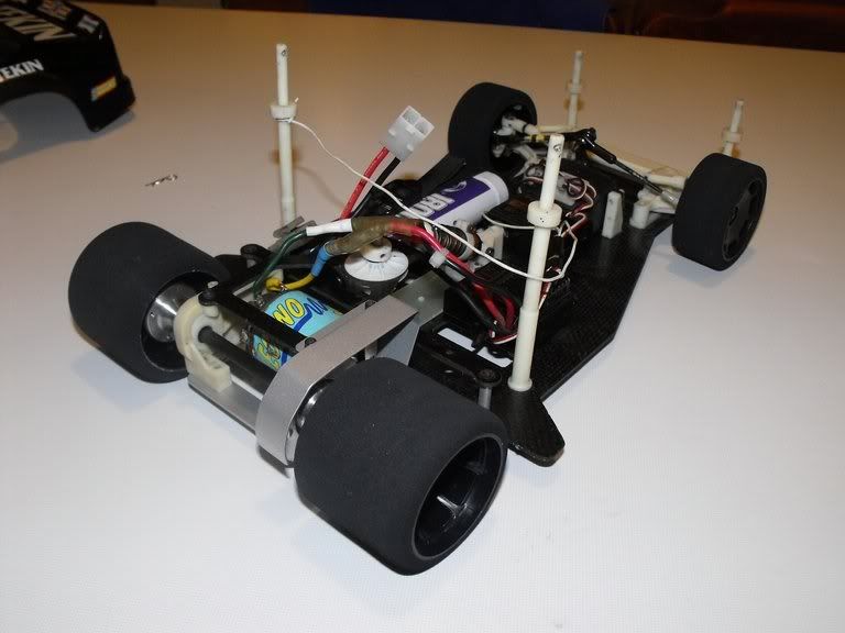

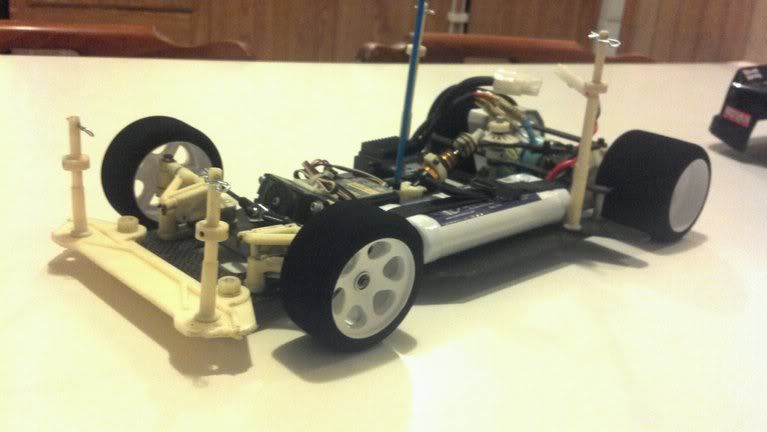

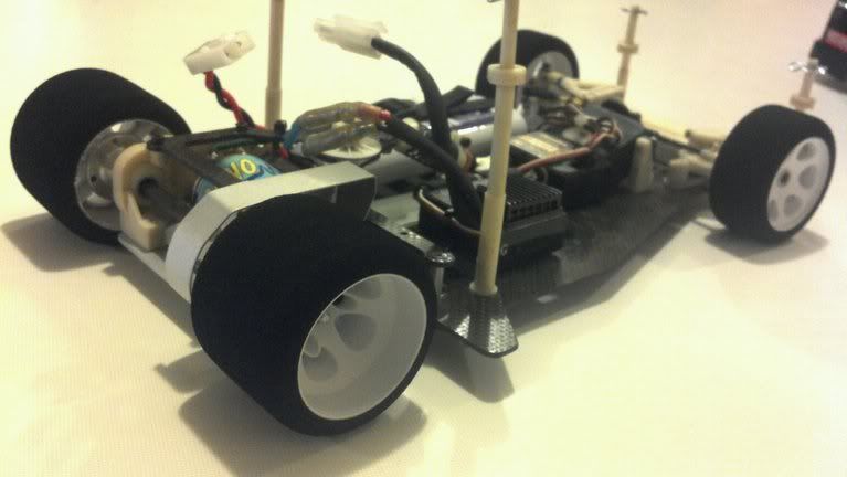

As far as i can tell this is an RC10L but i have seen a few say its an HPI???? Not sure but i polished it up and bought some new wheels for it as well as gears. It needs some more work but at least its back up and running. I dont have any before pictures but lets just say it was not pretty at all!!!

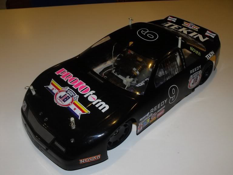

I just bought a nissan gtp zx-turbo body from McAllister that i am looking forward to painting up like the #83
thanks for looking,

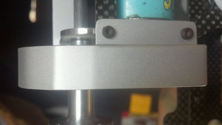

Kevin, yes I actually made it myself a few years ago. I am a machinist by trade I whipped it up one day a few years ago because I was running the car on pavement and kept spinning gears due to tiny rocks and dirt getting in the open gears. Im thinking about making one on the CNC that fully encloses the gears to keep them nice and clean! Glad you like it. It runs around the front as well to protect. The pinion gear.

Nice work, very innovative. Whould you happen to have better pics of that gear cover?

Hey kevin, I see you are from upstate ny man. Any where near Syracuse? Been thinking about taking my car someplace to run it. The only place I know of is Walt's hobby in Syracuse. Any of you guys race there? And I will take some close up shots of that gear cover. I can make more just like that one if any one is interested. I also want to make one out of black ultem plastic that covers the gears entirely. Maybe make it quick release for gear adjustments and such?

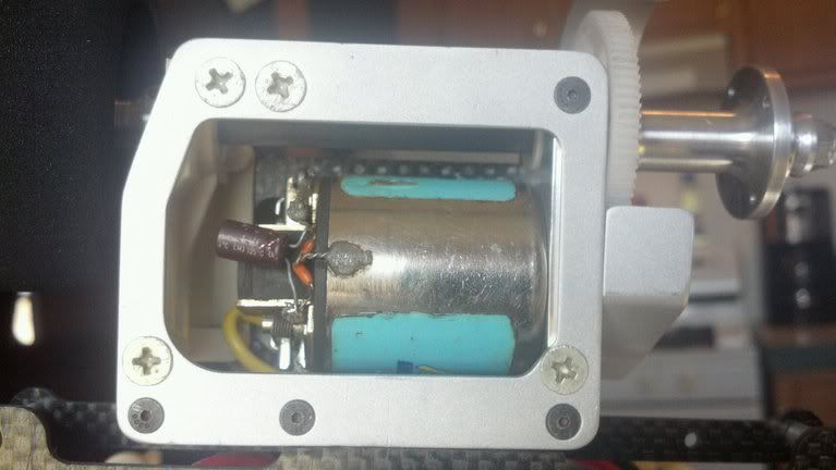

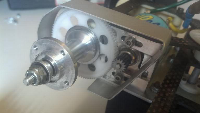

Image Image Image Image Image Image Image Image
I put on my white rim wheels and did some other minor things. Here is some close ups of the cover

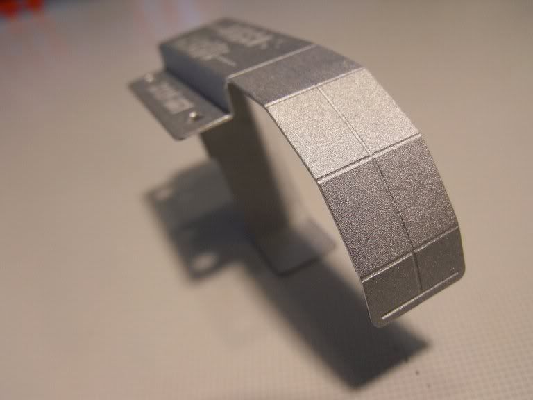

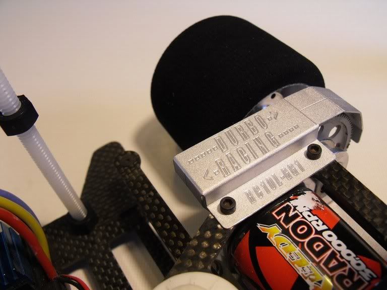

Gear Guard version #1
Post by durb69 »
OK guys i decided to make a CNC version of the aluminum guard because i really like the look of it. I still plan on making another type of cover at some point. This was my first one and is subject to slight changes in the final design.
