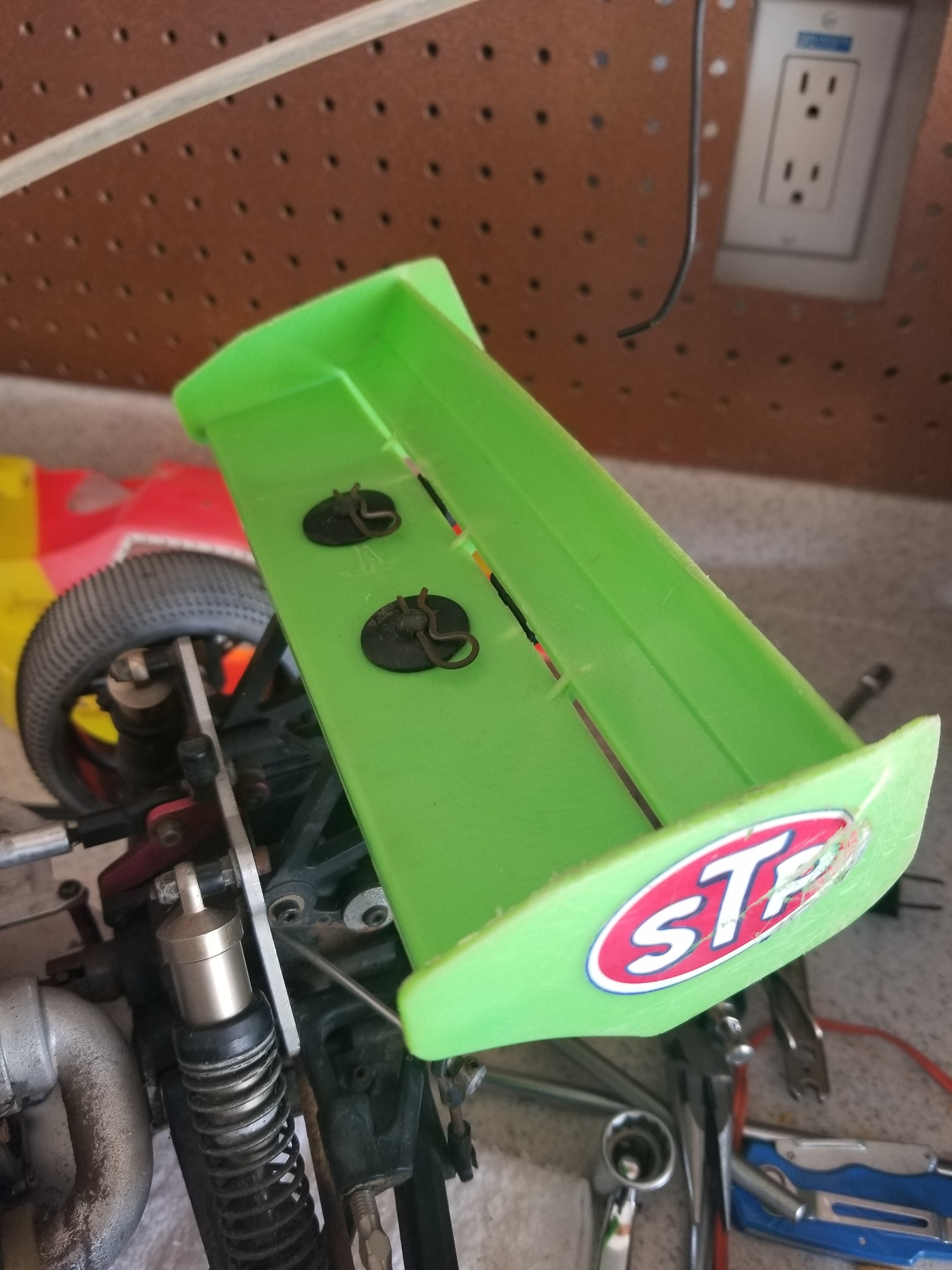

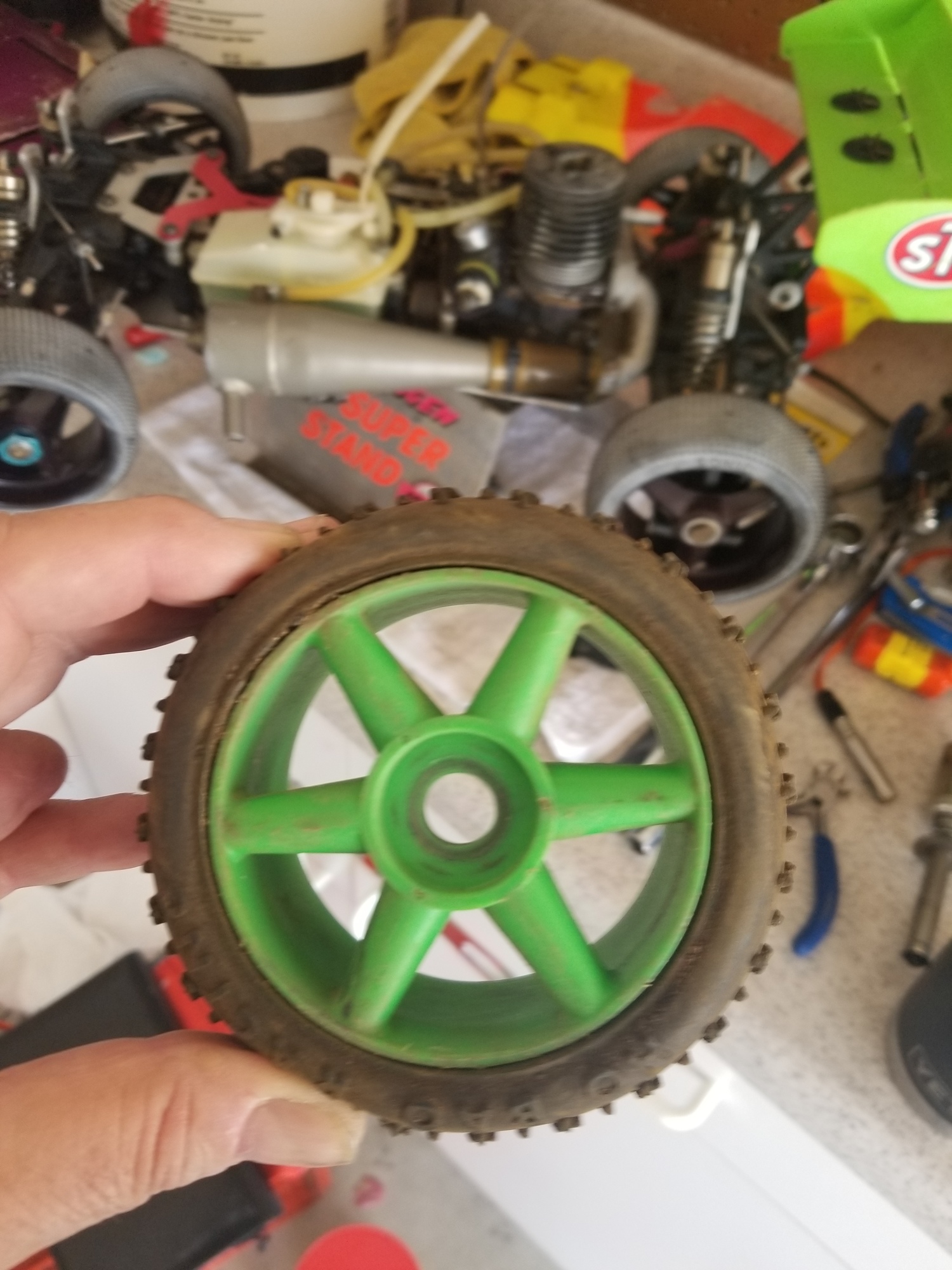

I found this green wing in my spares, do you think this is correct? What about these green wheels?

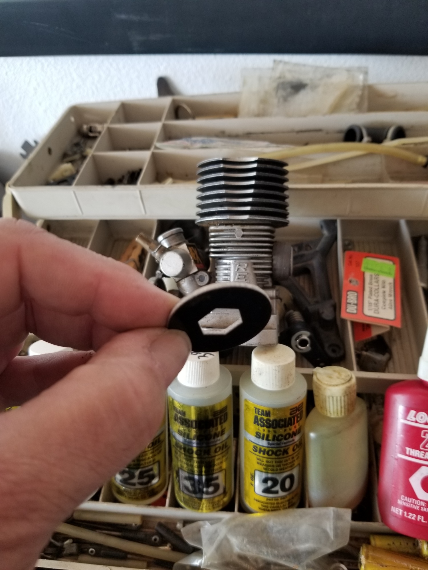

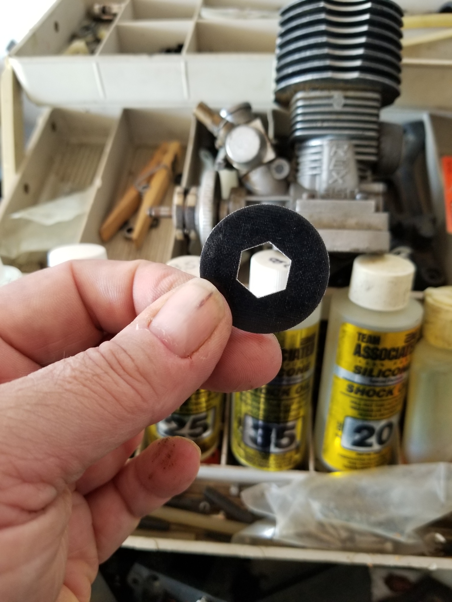

Lavigna, here is a picture of my brake discs. I seem to remember these disks were a big deal. Do you concur?

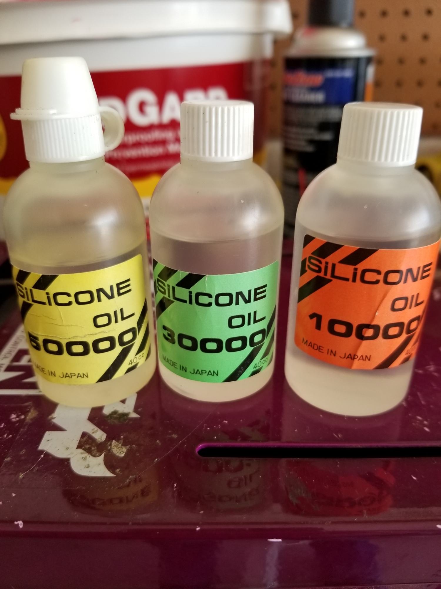

Another question regarding oil, could these bottle be my diff oils?

Lexster76 did a great job of answering your questions regarding the model variations, and grease VS oil in the difs. You should go back and read his reply, his links, part numbers, and look at the photo of the dif variations. These are the differences that determine MP3 or MP4. When you open the difs, use this info to determine what you have, and therefore what product to use for reassembly.

I believe the brake disc is a non Kyosho upgrade. I have one like it, but I'm not sure of the brand. I don't think I would consider them a "big deal" but I could certainly be wrong. It happens often.
The green wheel in your photo goes to a Mugen. The green wing appears to be correct for the Turbo Inferno.
